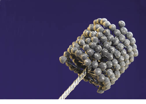

Courtesy of Brush Research Manufacturing
Flex-Hone brushes from Brush Research Manufacturing are brushes tipped with abrasive balls for imparting unique surface textures.

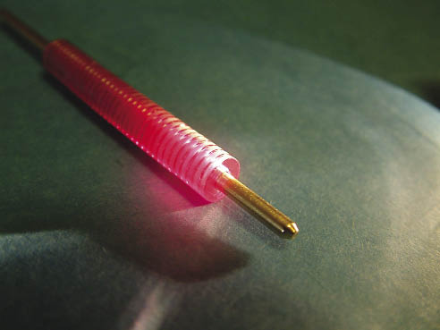

Lapping with Wire
Finishing holes with a wire lap has been practiced for centuries. An alternative to lapping with solid mandrels, lapping with wire is suitable for finishing small holes in hard materials. Its use peaked in the 1940s in the fabrication of jeweled bearings for mechanical watches. Typically, many parts are strung on a wire coated with fine diamond abrasive. Moving the wire back and forth through the parts’ holes while the parts rotate smoothes hole walls, increases concentricity and reduces taper. Increasing the wire’s diameter increases hole size.
Courtesy of Bird Precision
Bird Precision finishes holes in its ruby blanks by lapping them with an abrasive wire.
In finished parts, the performance of fluids flowing quickly out of orifices depends on exact hole edge conditions as well as hole size and finish. Bird Precision Inc., Waltham, Mass., uses wire lapping to produce straight edges for nozzles used in waterjet machining and other applications. The company’s tapered wires impart surface finishes of 2 µin. Ra or better and achieve diameter tolerances within 0.0001 " and roundness to 0.000050 ".

For production watch applications, 500 ruby or sapphire jewels are strung on a wire lap, clamped or glued together and revolved. In this example, simple, dedicated machines are used. To reach the desired hole size with a 0.0001 " tolerance, several wire sizes are used.
For low-production runs, a hacksaw frame can be used to hold the wire. Parts are manually slid back and forth across the diamond-laden wire. The hacksaw frame requires end connections to hold the wire ends, and the saw needs a device to add tension so the wire is tight.
High-strength piano wire has been used to lap holes as small as 0.009 " in metal workpieces. The wire is held in tension and coated with lapping compound. Wire is available in 0.001 "-dia. increments. The wire is normally plated with copper so it can be charged to accept a diamond abrasive coating. Extruded carbide tubes are lapped this way with 1µm to 5µm lapping compound, producing finishes as fine as 1 to 2 µin. Ra.
Some of the largest users of wire lapping are producers of zirconia ceramics ferrule for optical fiber connectors, precision hydraulic orifices and diamond wire drawing dies.
There are few makers of automated wire lapping equipment. Microcut Ltd., Lengnau, Switzerland, provides both long mandrel laps and wire lapping machines. Bird Precision is one of the largest U.S. users of this process. Bird Precision produces ruby blanks and puts thousands of them on a wire at one time. The orifices vary from 0.0016 " to about 0.250 " in diameter and are used as measuring restrictions in analytical instruments, gas chromatographs, gas metering, pace makers, ink jet printers, leak detectors and air and hydraulic regulators.
Brushing for Finish and Texture
One of the fastest and simplest approaches for finishing holes is to use off-the-shelf brushes for surface improvement. Commercial abrasive nylon brushes remove burrs and lightly hone surfaces, but brushes tipped with abrasive balls, such as Flex-Hone brushes from Brush Research Manufacturing Co. Inc., Los Angeles, impart the unique surface textures needed for many applications.

The abrasive globe at the ends of the nylon bristles removes grinding burrs, slivers and smeared and torn metal in automotive cylinders while providing an oil-retaining crosshatch pattern and a finer finish. In addition, the process improves the bearing ratio as it removes the top peaks of surface metal, which helps extend cylinder life.
The Flex-Hone cylindrical brushes have nylon spokes, or bristles, projecting from the center shaft. At the end of each spoke is an abrasive ball. Because the brush diameter is larger than the hole diameter, the abrasive balls are always in contact with the walls. The abrasive force against the walls is a function of spoke diameter and length, brush diameter and brush speed.
The brush is rotated while being driven up and down the hole axially to scrub the entire surface. The resulting surface textures are a function of force, initial hole properties, ball size, grain size and ball composition. The balls are made of silicon carbide, aluminum oxide, boron carbide, tungsten carbide, diamond, levigated alumina or CBN.
