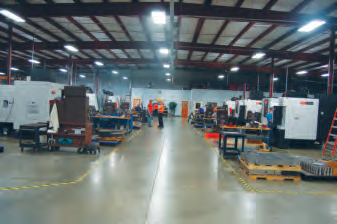

L&Sprobe1B.tif
Courtesy of B. Kennedy
At L&S Machine, Haas VMCs are linked via a shop-wide wireless network that allows CAM files to be sent from the company’s mainframe to each machine to process parts. Then, when the parts are completed, SPC data gathered via Renishaw probes is sent to the mainframe via the same wireless network.

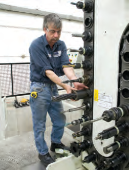

ToolChanger_lrg.tif
Courtesy of MAG
Lindquist Machine’s MAG FT 3500 horizontal boring mill has a 60-tool magazine.
