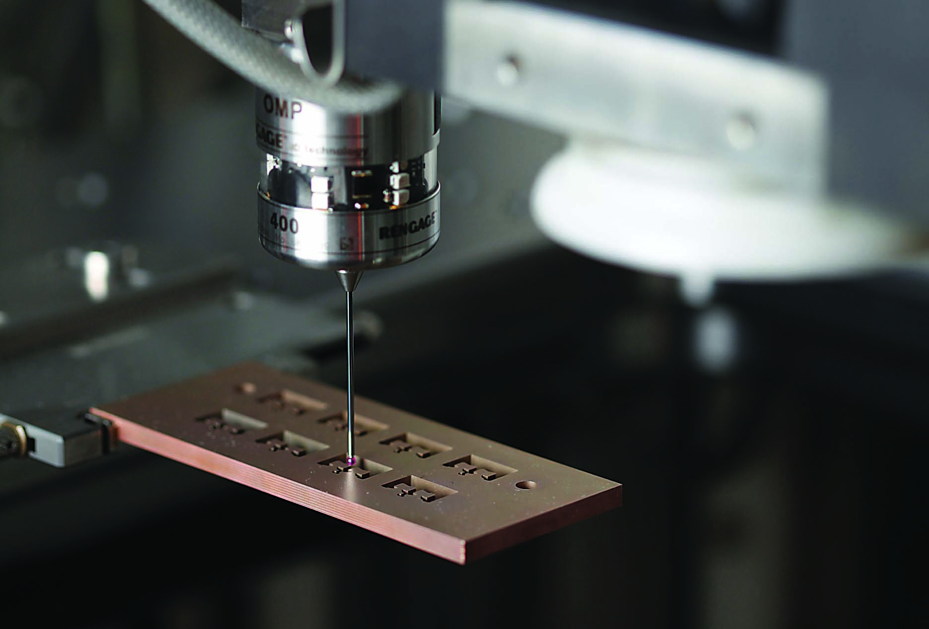

A probe performs in-process gaging on a wire EDMed part.
A probe performs in-process gaging on a wire EDMed part. Image courtesy of GF Machining Solutions

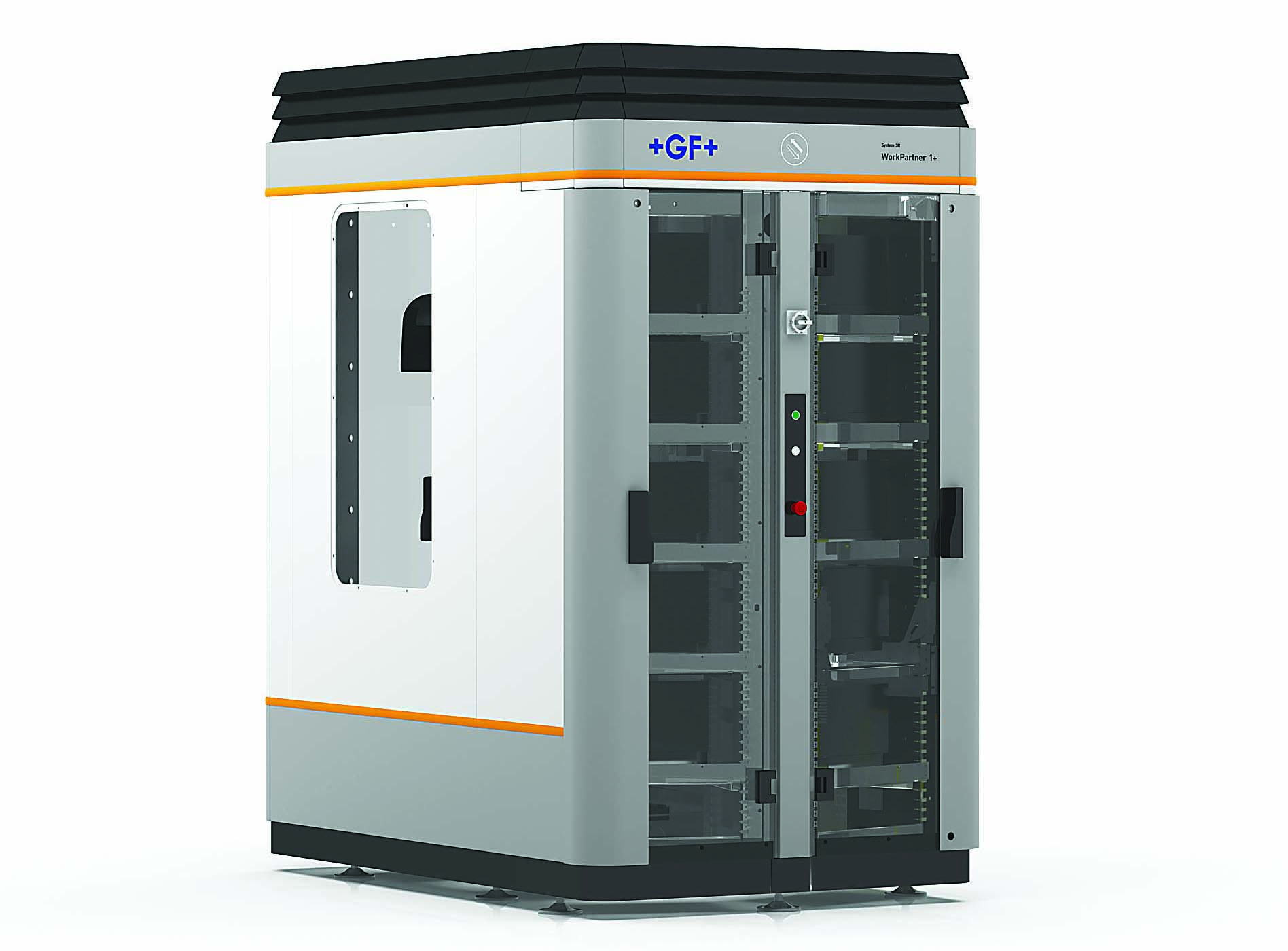

With the implementation of a universal tooling system that reduces excessive setup time, the same machine achieves significant gains in productivity and ROI. The System 3R WorkPartner 1+ (WPT 1+) modular automation system for wire EDMing, for instance, can add two hours of unattended machine capacity per day and reduce setup time to one hour on an eight-hour shift.

The System 3R WorkPartner 1+ modular automation system
The System 3R WorkPartner 1+  modular automation system for wire EDMing can reduce setup time to one hour on an eight-hour shift. Image courtesy of GF Machining Solutions

Automating measurement inside the machine is yet another setup time reduction tactic. Current wire EDM machines can perform contact sensing and have automatic edge- and center-finding capabilities. Utilizing the measuring capabilities of the EDM to gather the part’s location data is a step toward full setup automation.

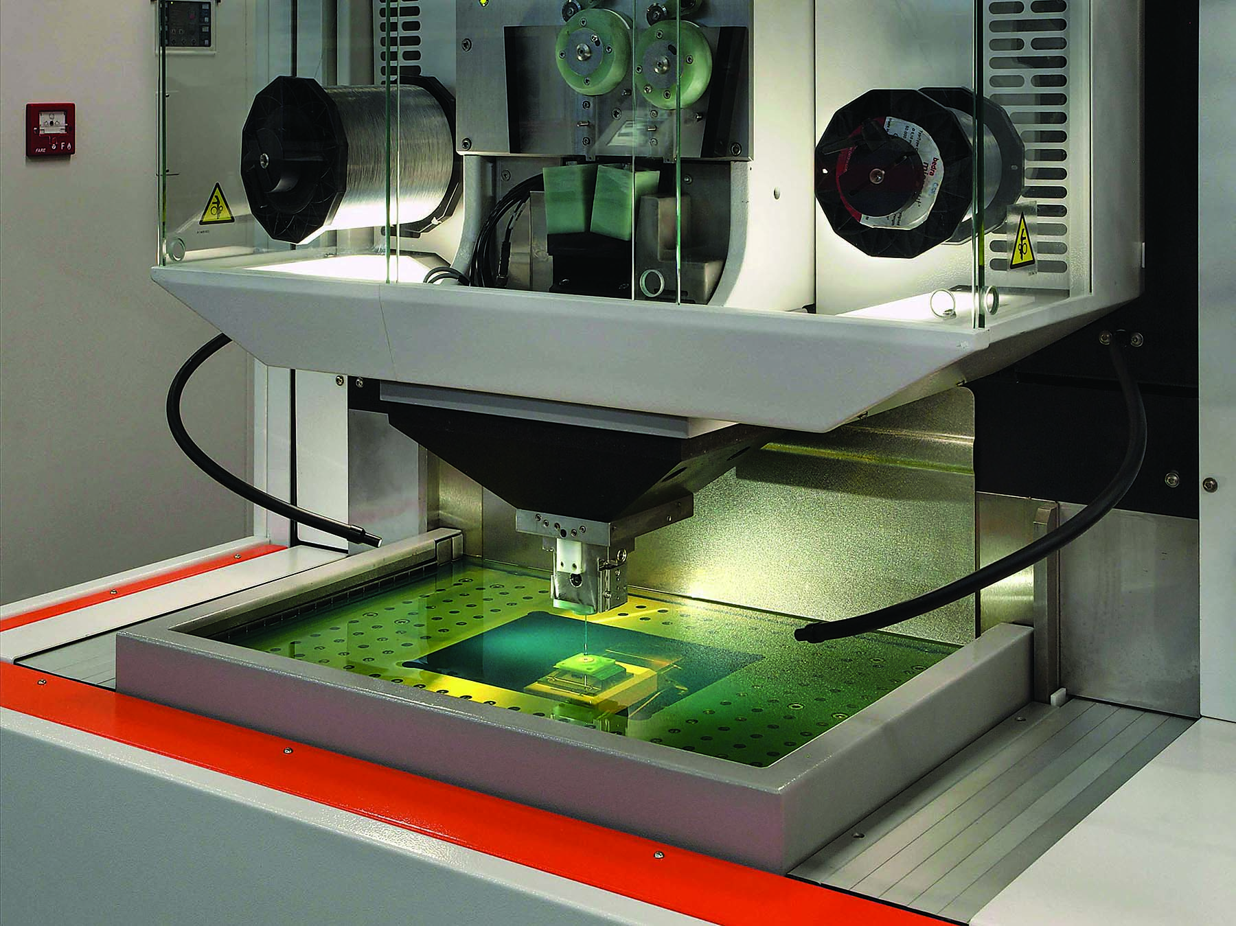

Automatic wire changers
Automatic wire changers, such as on the CUT 2000S from GF Machining Solutions, feature twin wire spools. This allows multiple gauges of wire to be used in the same job. Image courtesy of GF Machining Solutions
In an advanced example of this technology, wire EDMs from GF Machining Solutions offer Renishaw 3D probing, a factory-installed hardware and software option that has a touch probe integrated into the upper wire head. The probe measures the location, dimensions and flatness of workpieces located on the EDM worktable. Unlike most EDM measurement programs, 3D setup provides Z-axis data as well as X and Y measurements.
The 3D setup probing performs a three-point touch routine that establishes the part’s top plane. The machine orients the EDM wire to be perpendicular to that plane. Even if the plane is at a compound angle – tilted in two directions – the software aligns the wire to cut as if the plane were flat.
Another key to minimizing non-cutting setup time is to make every job as simple as possible. Tooling standardization is one way to simplify processes. To do so, many EDM shops standardize on 0.010"-diameter brass wire. However, a dual wire machine can provide flexibility to quickly switch from one wire type to another when necessary or can be loaded with the same wire on both spools to provide enough capacity to ensure that the wire will not run out in long untended runs.

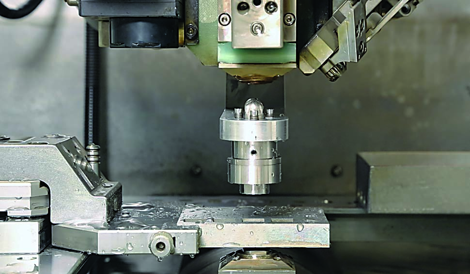

Once a shop achieves automated wire EDM setups, they can focus on factors that affect the adoption of lights-out machining, one of which is slug management. The issues here are unique to wire EDM. Wire EDM produces slugs of uncut material, and they must be effectively removed.
With  automatic slug management, shops gain true lights-out capability from their wire EDM machines.
With  automatic slug management, shops gain true lights-out capability from their wire EDM machines. Image courtesy of GF Machining Solutions
A partial solution involves programming the machine’s CAM system to cut the part while leaving very small (up to about 0.100" thick) tabs attaching the slug to the workpiece. After machining is complete, the operator cuts off the tabs and removes the slugs.
Some wire EDMs have automatic slug welding capability that welds the slug in place using small residual deposits of brass from the cutting wire. When cutting is complete, the slugs are removed by hand.
Another method employs what is called an early-and-late strategy. In the late stage, EDM roughing passes involving tabs occur untended overnight. In the early stage, operators remove tabs and slugs during the day. Although these manual slug removal operations limit the ability to operate fully untended, they can be consolidated and scheduled for overnight production.
An alternative to the early-and-late strategy is an automated slug system such as the GF Machining Solutions Automatic Slug Management (ASM) innovation. This function uses either an electric magnet or a suction system to grab and remove slugs out of workpieces and deposits them into a basket inside the work tank in a fully automatic operation. With ASM, shops gain true lights-out capability from their wire EDM machines.
