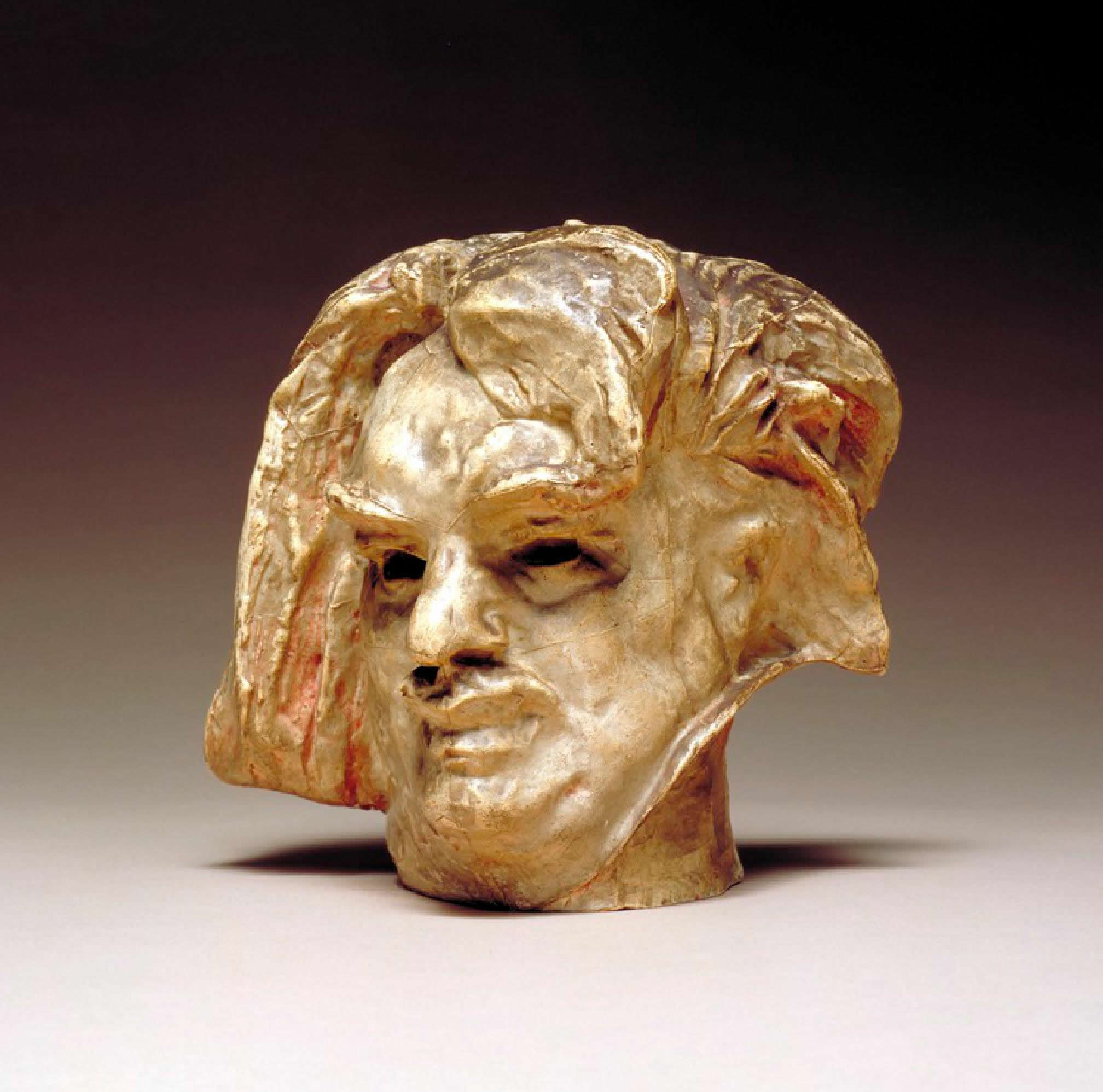

Auguste Rodin’s Head of Balzac, one of the four sculptures scanned by NVision.

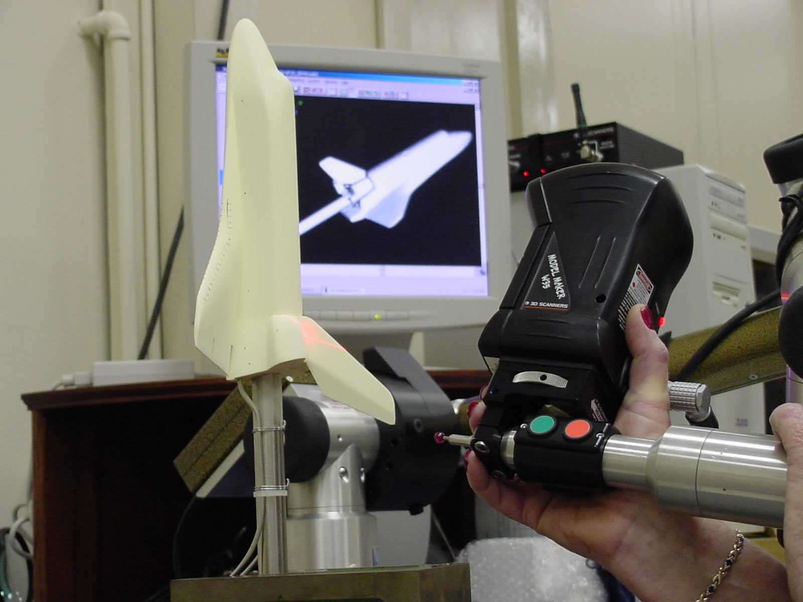

NVision’s versatile HandHeld scanner is capable of capturing 3D geometry from objects of almost any size or shape.
NVision technicians performed the scanning in the Nasher’s Conservation and Art Storage facilities using the company’s HandHeld laser scanner to collect data on the sculptures’ unique geometries; their complex shapes, contours, and surface details. Given the delicate nature of the sculptures, the Nasher had professional handlers move the artworks to and from the scanning table.
The HandHeld scanner is a powerful portable scanning device capable of capturing 3D geometry from objects of almost any size or shape. The scanner is attached to a mechanical arm that moves about the object, freeing the user to capture data rapidly with a high degree of resolution and accuracy. As a part is inspected, the scanner generates a point cloud consisting of millions points each with x,y,z coordinates and i,j,k vectors. Integrated software that comes with the scanner is used to convert the point cloud to an STL polygon and an optional tripod provides complete portability in the field. Intuitive software allows real-time rendering, full model editing, polygon reduction, and data output to all standard 3D packages.
