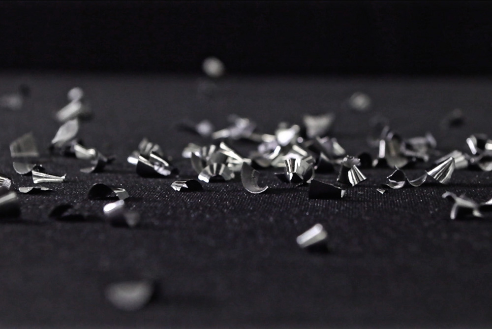

Shape & size
When looking at chip formation, a key indicator of a good chip is shape. The preferred outcome for any application is chips shaped as sixes and nines or a single conical shape. These small, manageable chips are essential for efficient, predictable drilling. Nevertheless, it is important to be aware of what chips in other shapes and sizes can indicate. For example, a straight, flat chip is a result of elasticity. If the chip is a continuous ribbon, then there are likely many adjustments that need to be made to achieve ideal chips.
The size of the chips impacts evacuation as well. Two major factors impact the size of chips in drilling tools: chip breakers, also known as chip splitters, and lip geometry. With chip breakers, the width of the chip is thinned to allow for easier evacuation; the wider the chip the easier it is to get it to roll onto itself and break. Lip geometry acts as a mechanical chip breaker to fracture a chip by curling the chip on top of itself or by impacting the chip forming with the backside of the lip radius. Although harder materials will curl a chip on top of itself to create chip fracture, gummier materials often skip over the lip radius and only fracture after impacting the back of the lip radius. Still, the purpose of the combined chip breakers and positive lip geometry is to break off the chip so that it is narrow enough to easily evacuate.
Chip fracturing can also occur naturally due to the velocity differential between the outside and inside of a chip, which creates a cone-shaped chip that curls on itself and fractures. Because larger diameter inserts have a higher velocity differential than smaller diameter inserts, it is easier to fracture chips i.e., the larger the chip breaker spacing the more chip fracturing that will occur. Smaller diameter inserts are limited to the velocity differential available due to the restriction on the chip width required to easily evacuate chips through the holder gullet.

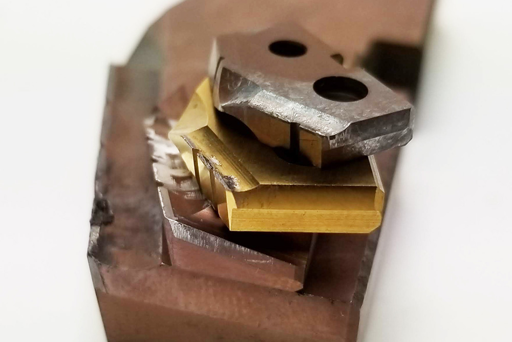

BUE
Built-up edge on the tool (BUE).
A final thing to look for when examining chips is any changes in chip formation. If chip formation is altered during an application, it could be caused by a myriad of elements: wear on the tool, built-up edge on the tool (BUE), or changes in the environment like coolant or material changes. In new applications, it may be best to drill shallow test holes and take a look at the chips to make sure they are small and segmented. Being conservative at the beginning with speeds and feeds could also aid in better understanding chip formation and what adjustments need to be made.
