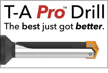

If the answer is running a long-term, repeatable process, invest in a replaceable insert drill. Commonly referred to as a spade drill or replaceable tip drill, these drills are engineered so that machine operators have the ability to change out the worn cutting edge quickly. This reduces the overall cost per hole in high production runs. The initial investment of the drill body (insert holder) is compensated quickly by the reduction of cycle time and cost of replacing inserts versus the cost of new solid tooling. Simply put, speed of changeout coupled with a lower long-term cost of ownership makes replaceable insert drills the better choice for high production jobs.

A drill designed with replaceable cutting edges can offer a lower cost of ownership over the life of the tool for long-term contracts and high production runs. The savings start when the cutting edge is worn or damaged because there is no need to order the whole tool—only the insert (a.k.a. blade).
Another cost savings variable is the amount of machine time saved or spent when changing out cutting tools. The replaceable insert drill’s diameter and length are not affected by changing out the cutting edge, but because the solid drill needs reground when it is worn, solid tools should be touched off when replaced. This is a minute that parts are not being produced.
The last variable in the cost of ownership equation is the number of steps in the holemaking process. Replaceable insert drills can usually complete the process to spec in a single operation. Many applications that incorporate solid drills add a finishing operation after using the reground tool to meet the job’s requirements, creating an unnecessary step that adds machining cost to the part produced.
