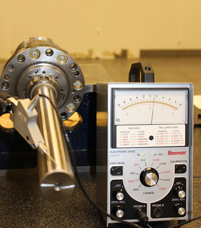

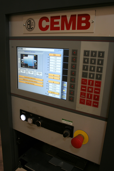

“Service technicians meticulously should disassemble and check each spindle for adherence with the original manufacturer’s specifications,” Kirkpatrick explains. “This is followed by a geometric inspection using electronic measuring equipment that is repeatable within a micron. It is advantageous that a digital photo record be kept to ensure that all repair quotes and failure analysis reports are as accurate as possible. Next, grinding, machining and balancing should be performed by experienced technicians using advanced manufacturing equipment.”

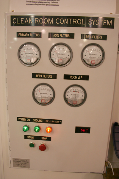

It is essential that spindles are reassembled in a clean work environment. For example, at Superior Spindle Service a class 10,000 clean room is used for inspection and assembly. The clean room is designed to prevent any airborne contaminants and humidity from affecting spindle quality and performance, and further ensures that each spindle is returned to precise OEM specifications.

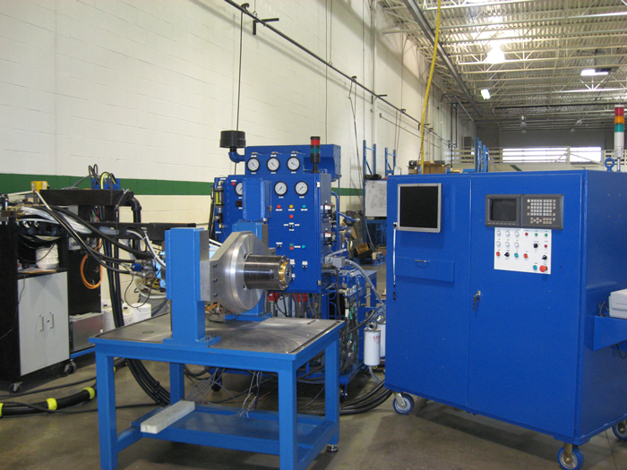

After spindles are remanufactured, it is vital they be thoroughly tested and verified. If related assemblies are in question, such as electronics or motors, those should be tested and verified as well.
“Advanced testing includes vibration analysis and running the spindle closed-loop on a Siemens or a Fanuc drive,” Kirkpatrick explains. “Our technicians also align encoders using special software. We also test motor thermistors, bearing thermistors and proximity sensors.”
Each rebuilt spindle needs to be thoroughly “run in” at the operating speeds as they were designed. Vibration analysis and temperatures are monitored throughout the run in procedure and may take up to 18 hours to complete. Before leaving the testing facility, detailed reports should be generated for verification by quality assurance technicians.
