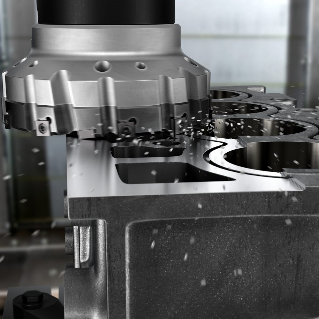

Fortunately, these challenges can be overcome by selecting a tool with an optimized design that’s made from advanced materials. For instance, the Sandvik Coromant M5C90 face milling tool, part of its M5 cutter series, was designed for solid aluminum parts with long milling operations, as well as for roughing and finishing cylinder heads, blocks, and electric car components.
In just one efficient operation, the M5C90 can perform the entire machining process, from roughing to finishing. In many cases, this can be with a depth of cut of up to four millimeters. This tool can increase tool life by fivefold and reduce cycle time by up to 200%.
In addition, the M5 cutter series features step technology, where its extremely hard-wearing polycrystalline diamond (PCD) inserts are arranged in a spiral and staggered vertically to remove material from the workpiece, both axially and radially. Furthermore, the last tooth has wiper geometry to further ensure a high-quality, flat-surface finish. The wiper cutting edge remains in a fixed position, which eliminates the need for time-consuming setups. Other tools in the M5 series include the M5B90 face milling cutter concept for fine finishing and the M5F90 combination milling cutter for roughing and finishing in smaller dimensions.
