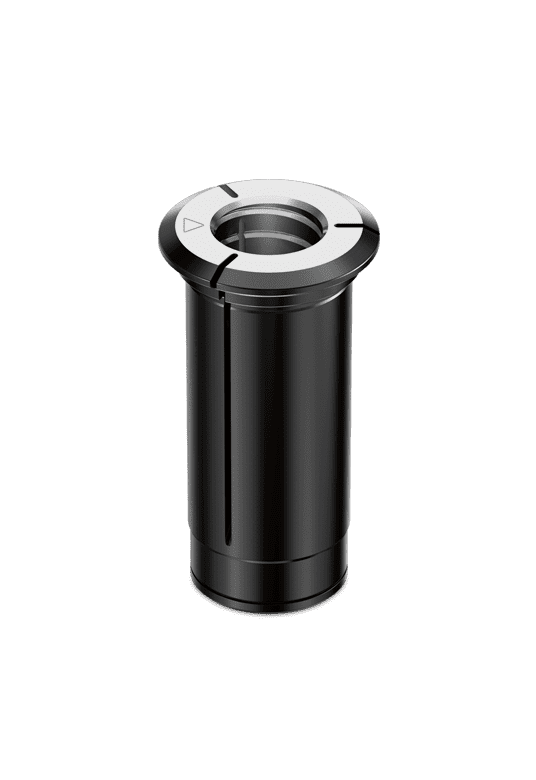

powRgrip achieves near-zero TIR toolholding
Out-of-balance, poorly manufactured toolholders generate vibration that increases exponentially from the toolholder to the cutting tool tip. So, the longer the cutting tool, the higher the levels of runout. While the complete elimination of TIR and vibration is impossible, the REGO-FIX powRgrip toolholding system reduces both to near-zero levels.
The powRgrip system consists of three basic components – holders, collets and press-fit assembly mounting units. In manual or automatic configurations, the hydraulic press-fit assembly units quickly press collets into holders with up to nine tons of force. The collets have high-precision tapers that match with equally high-precision internal tapers in the holders, all of which creates the system’s extreme levels of transferable torque.
Unlike other clamping systems where heat or hydraulics are used, the powRgrip system uses the mechanical properties of the holder material to generate its tremendous gripping force. Such taper-to-taper collet-holding systems deliver extremely high levels of precision, and as a whole their TIR is typically less than 3µm, which ensures accurate finished parts. Such precision optimizes the machining of complex, critical Aerospace and Defense industry components through the use of high speed cutting (HSC) or high performance cutting (HPC) strategies. The lower the TIR, the less tool vibration, and the less vibration, the longer cutting tools last, which in turn reduces overall tooling costs.
