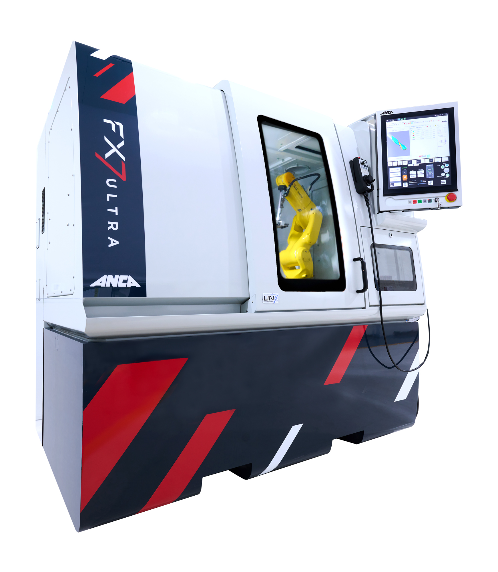

FX7 ULTRA
The ULTRA package with nanometer resolution, design, software and quality features enable manufacturers to grind tools with very demanding specifications.
FX7 ULTRA

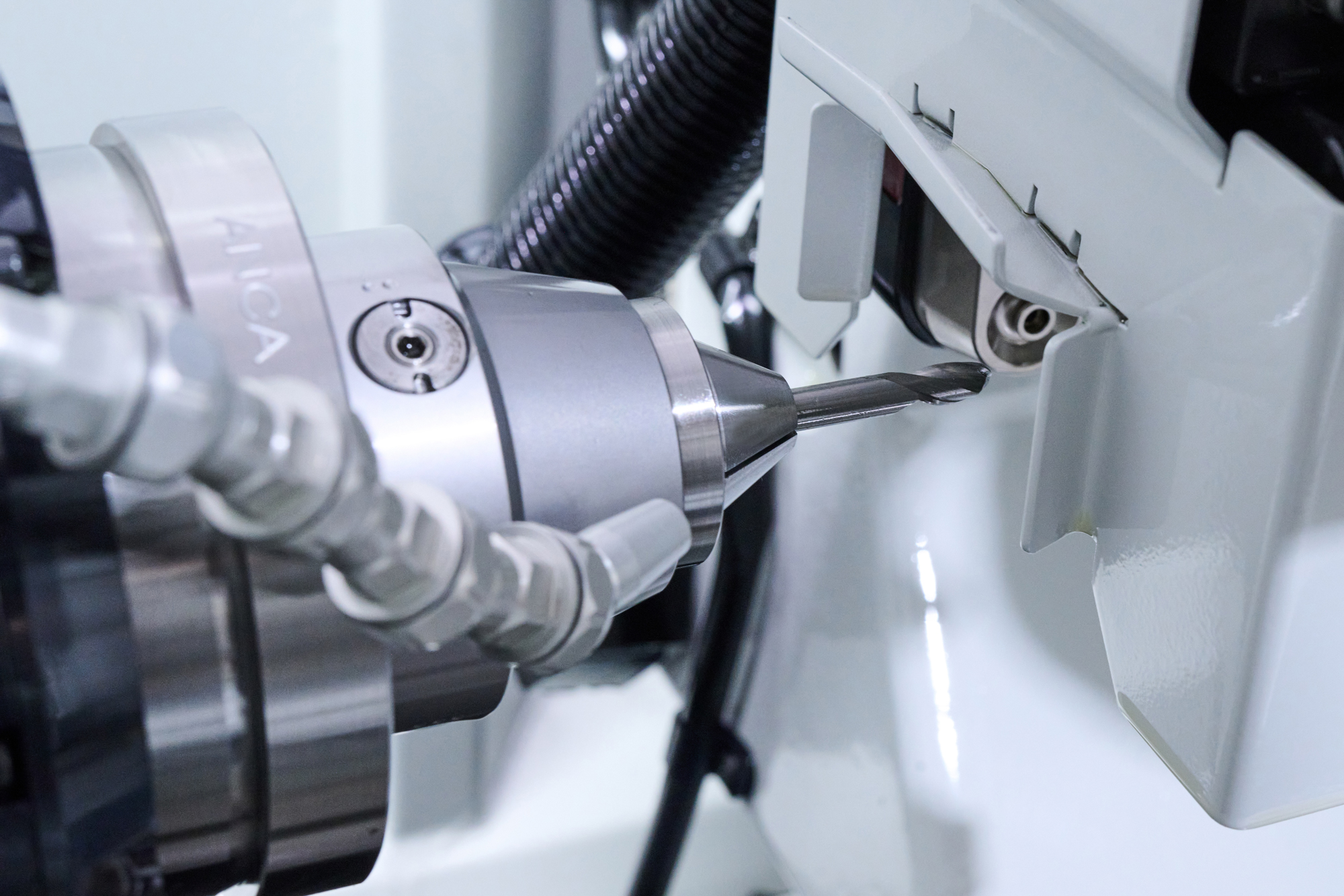

The FX7 ULTRA introduces several cutting-edge technologies, including ANCA’s nanometer control, that can achieve precision grinding for small and micro tools down to 0.1mm diameter.
New software, hardware and design features significantly improve surface finish, accuracy, and controlled runout, ensuring batch consistency from the first ground tool to the last. These advancements ensure that the FX7 ULTRA is the go-to solution for precision grinding in industries that rely on small tools, including electronics, telecommunications, medical devices, aerospace, automotive, diemold, and general machining.

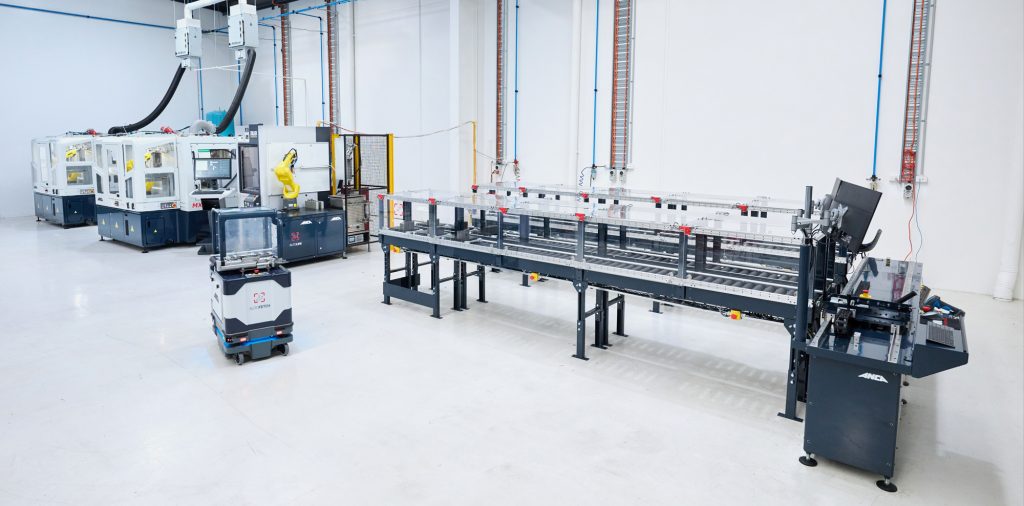

ANCA has further developed its AIMS system for automated tool production. At EMO, visitors can see examples from the field, with systems’ operating completely unattended over an extended period as it manufacture tools.
The AIMS automation package is a modular and growing system, spanning across the tool production process. ANCA is set to include additional operations like blank preparation or laser marking in the automated process. The system’s intelligent design allows for progressive steps of automation, including an automated laser marking station AutoMarkX. The versatile laser marking station is tailored to meet the needs of tool manufacturers. It provides reliable and high-quality marking, ensuring traceability, identification, and branding of tools, while eliminating repetitive tasks to free up time for skilled staff, the company says.
The AutoMarkX’s new, retrofittable rotary workholding system allows for unlimited index marking around the tool, with automatic Z-axis focus and compatibility with tool shanks from 3 to 32mm. Moreover, the AIMS Autoline Basic, the standard interface for easy loading at the AutoMarkX enables customers to experience smoother material transfer between machines. By utilizing a manual trolley system, combined with AIMS pallet carriers, Autoline Basic streamlines the transfer of heavy tool pallets between machines, reducing labor-intensive processes.
