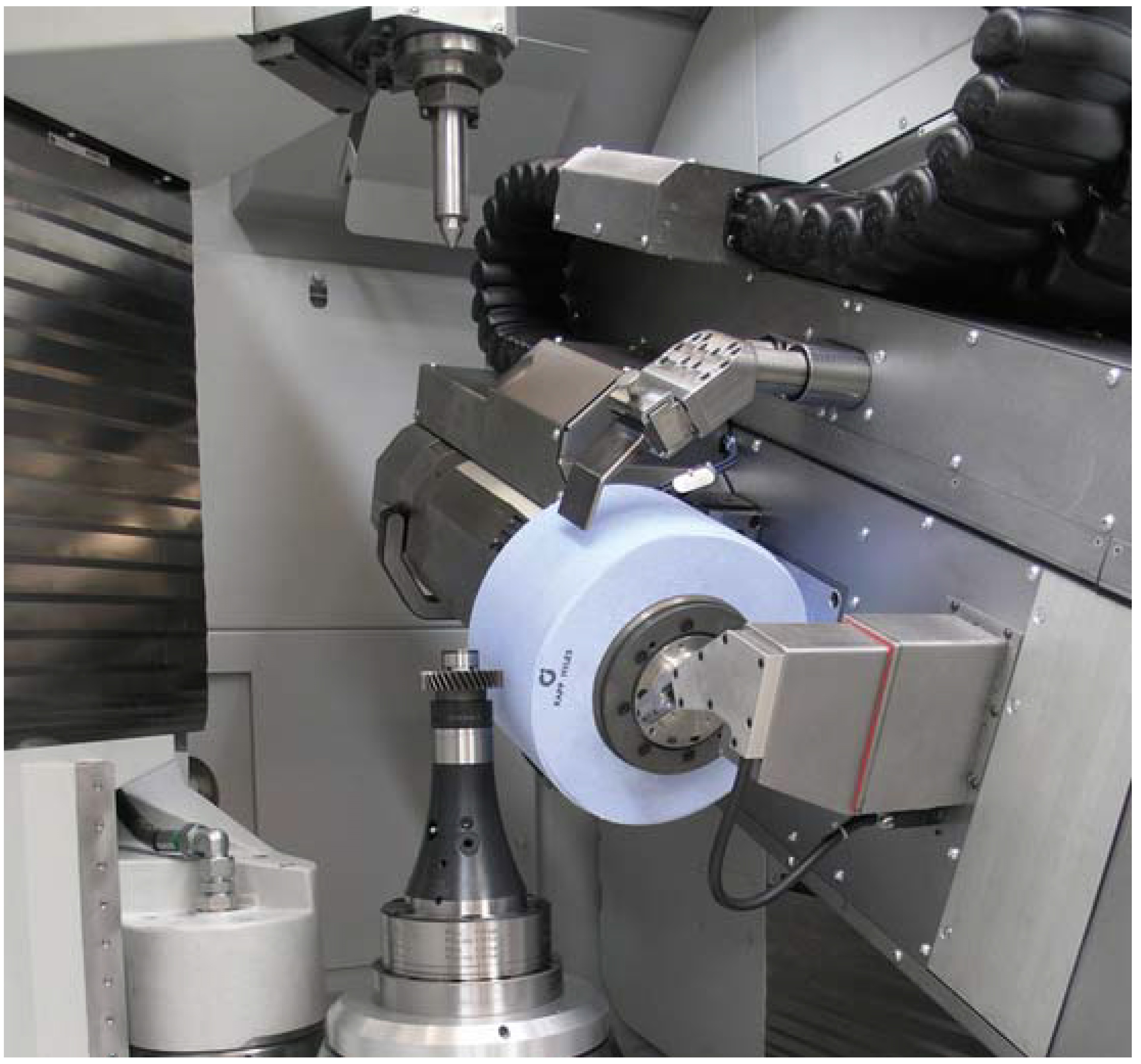

Workspace of a gear grinding machine. High rotational energy levels can arise in large grinding tools, such as those used for generation grinding. If a grinding wheel does burst, it can cause serious injury to the machine operator. Source: Kapp

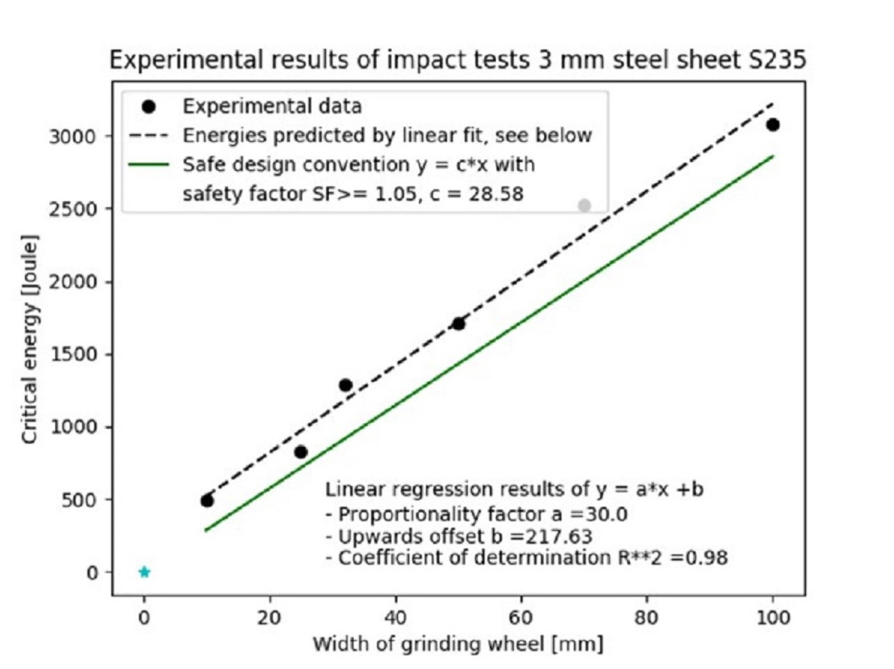

Figure 2. Safe design convention for 3 mm sheet steel. Source: BGHM/VDW

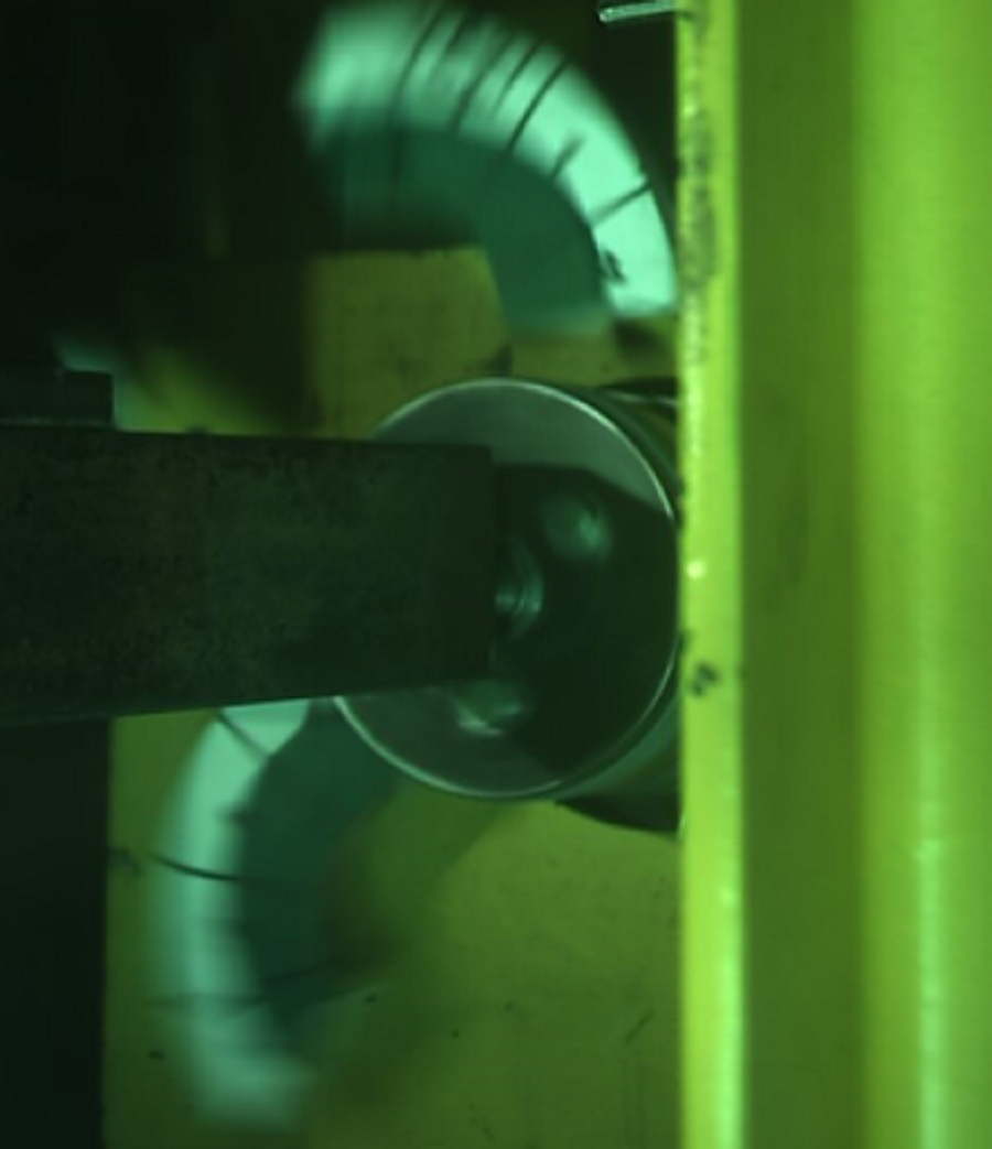

Burst scenario. Source: IWF TU Berlin

It is not only the industrial companies and the scientists who agree that guards are overdesigned in such machines. The DGVU (German Statutory Accident Insurance System) based in St. Augustin, Germany, and the BGHM trade association in Hanover, Germany, also carried out similar tests on a burst test stand – with comparable results. The burst tests were conducted over eight years. Then, at the end of 2019, the BGHM presented its report covering a total of over 400 burst grinding wheels and more than 800 usable impact events. Based on this, a safe design convention stipulating 3 mm for sheet steel with different grinding wheel widths was drawn up in conjunction with the VDW (see Figure 2).

"We're also using simulations to highlight the worst-case scenario. As our burst tests have shown, this occurs when the outer edge of the fragment hits the guard. We can reproduce this type of impact in models with different materials, grinding wheel widths and safety guard thicknesses. In this way we've succeeded in simplifying the extremely complex burst tests," reported Thom. "Our plan for this year is to propose even simpler dimensioning procedures."
