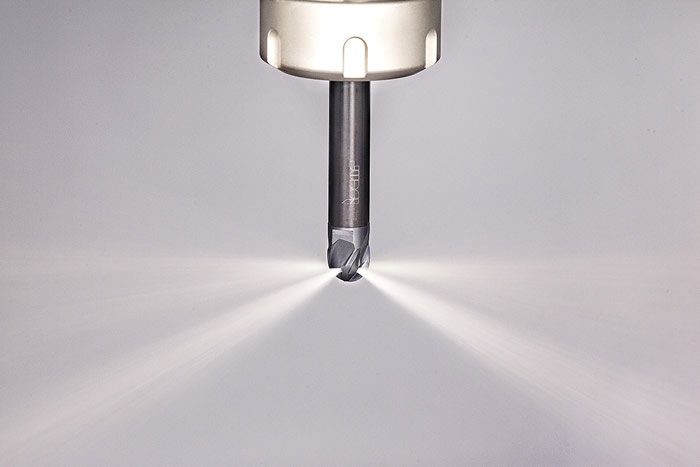

In many cases, however, having an efficient coolant supply is not only reasonable but absolutely necessary to ensure productive milling. For example, when machining titanium and heat-resistant superalloys, austenitic and duplex (austenitic-ferritic) stainless steels—or even special-purpose, hardened, alloyed cast iron—a considerable amount of friction and heat is generated. The flushing effect of coolant also significantly enhances chip evacuation and reduces recutting of chips, particularly when milling deep pockets or narrow slots.
Iscar’s Multi-Master ballnose milling head is intended for machining difficult-to-cut materials and has channels to supply coolant where it is needed.
Compared with traditional low-pressure coolant, normally delivered at around 20 bar (290 psi), high-pressure coolant (HPC) delivered at about 80 bar (1,160 psi) and ultrahigh-pressure coolant delivered at 350 bar (5,000 psi) are welcome developments.
When applying traditional low-pressure coolant, the high level of heat produces a vapor film in the cutting zone that intensifies heat transfer. However, a high-pressure jet that directly targets the cutting zone effectively penetrates this film and gets coolant into the cut. It also improves the cutting action by changing the shear-plane angle and creating thin, manageable chips. Taking advantage of HPC is only possible when using an appropriate machine tool or by retrofitting an existing machine.

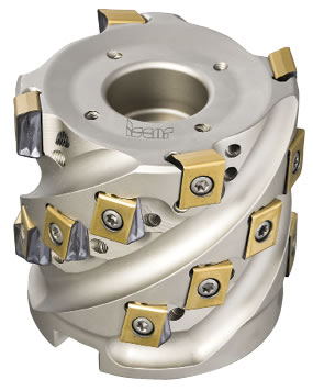

As previously noted, roughing generates extremely high levels of heat, and coolant may be destructive because of the critical thermal stress it causes. In contrast, the temperature of the insert’s cutting edge will remain high when dry roughing, but not overly high if the machining parameters are set correctly. For example, the tool temperature will vary within a relatively narrow range, such as 300° to 700° C (572° to 1,292° F), that will not lead to thermal shock.
The T490 extended-flute cutter from Iscar can delivery high-pressure coolant.
