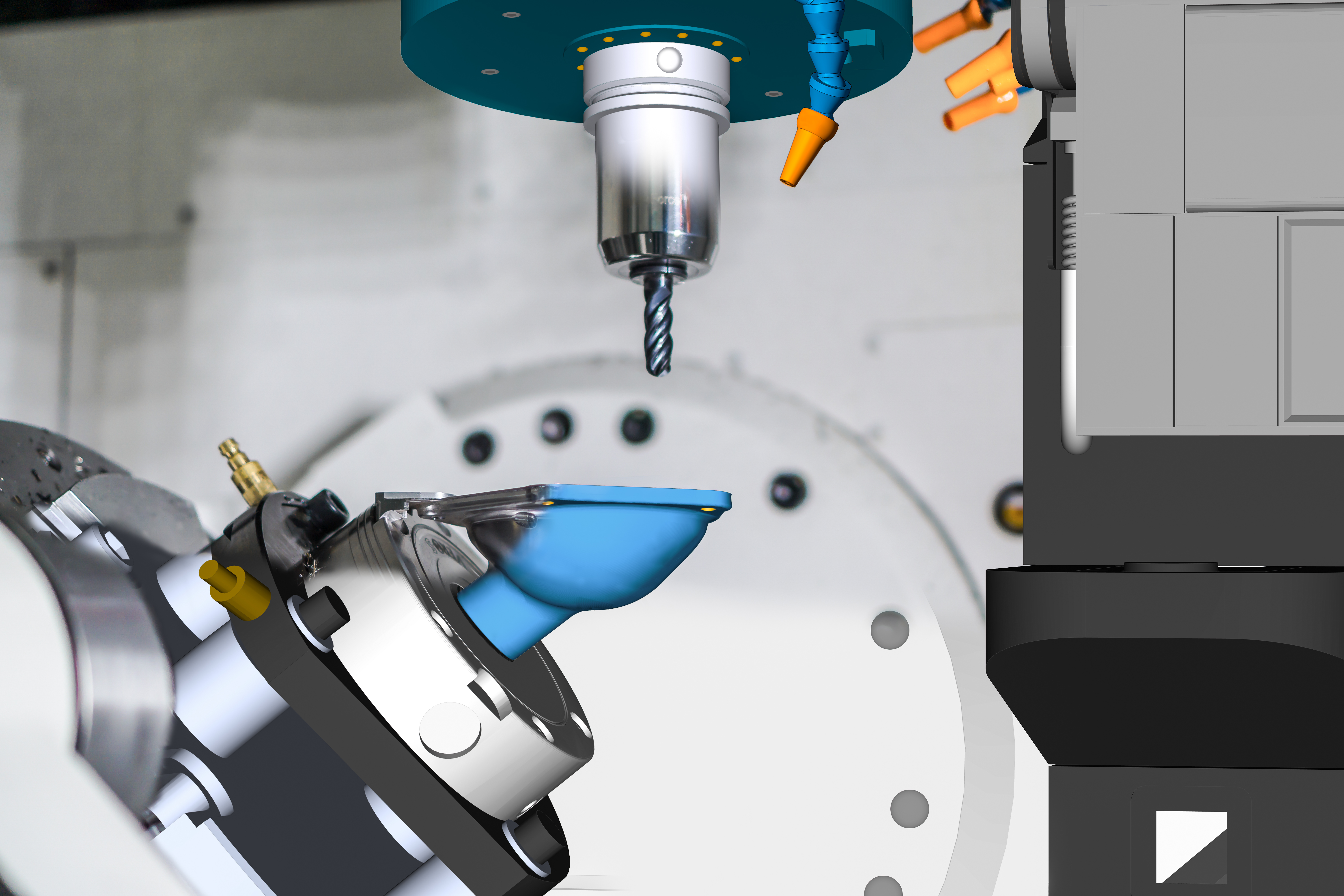

A Digital Twin creates a virtual replica of a machining environment, revealing potential tooling conflicts without the need for costly dry runs (Photo: DP Technology)The fourth Industrial Revolution promises new efficiencies and productivity gains for manufacturers. Machine tool suppliers are integrating Industry 4.0 capabilities and software companies that are providing powerful new tools such as those that utilize artificial intelligence.

Simulation, analysis, and verification
These capabilities take the collision avoidance feature to a new level, including generating a digital twin of the entire machining environment to review a machine’s kinematics, reviewing the potential for collisions, axes overtravel, acceleration exceptions, and other conflicts before making a single cut.
