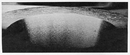

An internally ground part with chatter marks.

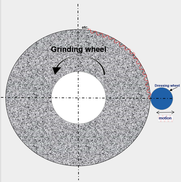

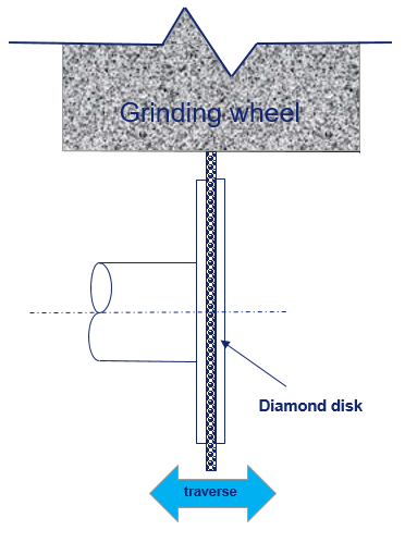

A typical side view of a rotary dressing system is shown in Figure 2.
Figure 2
Unfortunately, these errors generally manifest themselves as a pattern on the OD of the grinding wheel.  Experience indicates that most often the patterns are caused by once-per-revolution errors of the diamond disk, such as runout and balance. Once the pattern is formed on the OD of the grinding wheel, it will ultimately be transferred to the part during grinding.

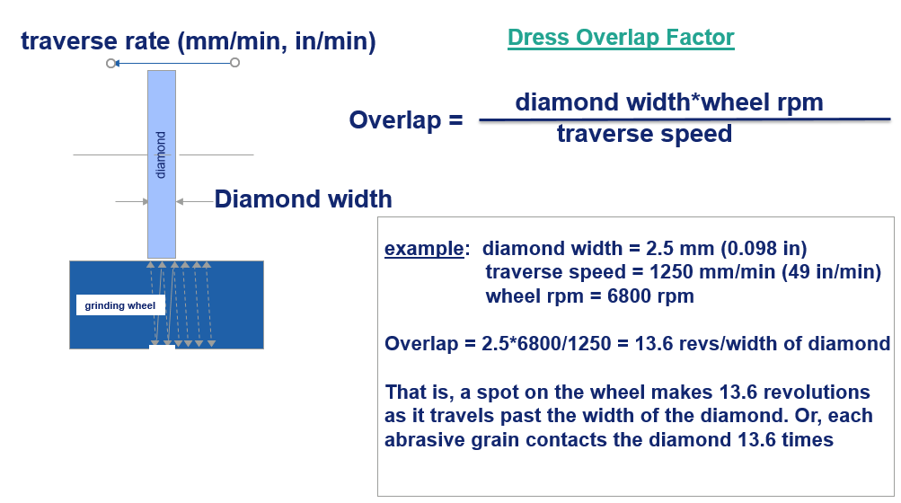

To understand the mechanisms involved, two topics are important. The first is the concept of "overlap factor" (Figure 3).
The concept of the "overlap factor" is shown here in Figure 3.
Figure 3
In the instance being discussed here, a wave pattern generated by the diamond would be over written 13.6 times as the dresser traverses by. So, how does this affect the pattern that gets transferred to the wheel?

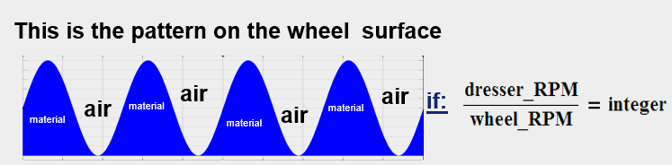

 First, consider what happens if the ratio of the wheel to diamond rpm is an integer (Figure 4).
Consider what happens if the ratio of the wheel to diamond rpm is an integer, as shown in Figure 4.
Figure 4
The pattern will never change. The bumps and valleys on the wheel will match the high and low points of the diamond every time the wheel rotates, much like two gears meshing together. When this happens, the entire amount of the dresser "motion" will be imprinted on the wheel. In this case, the overlap factor will not matter, and straight-line chatter will be produced.

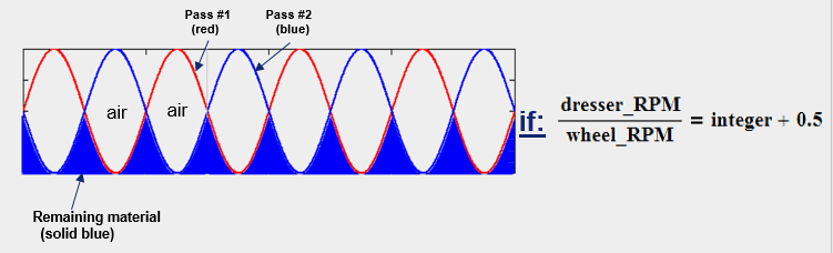

If there is a phase change, i.e. the ratio of dresser rpm to wheel rpm is not an integer, the amplitude of the pattern will be reduced as the wheel rotates multiple times. Figure 5 illustrates what happens when the ratio is an integer +0.5.
Figure 5
There are a number of interesting things to note about this condition:
  1. It is stable after two wheel rotations, so the overlap factor only needs to be two to get full benefit of the "interference" caused by the phase change.
  2. There are twice as many “bumps” with the same dresser rpm.
  3. A fast Fourier transform of this pattern would produce a lot of harmonics (multiples) of dresser rpm but not necessarily a peak at dresser rpm.
  4. The pattern is half the amplitude of the original pattern (Figure 4).

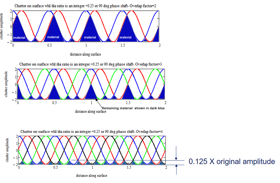

So the ratio of an integer +0.5 is an improvement, but will still be half the amplitude of the dresser motion. Next, let’s look at a ratio of an integer +0.25 (90 degree phase shift).
Figure 6 shows the progressive reduction of the pattern as the overlap factor is increased to four.
Figure 6
Figure 6 shows the progressive reduction of the pattern as the overlap factor is increased to four. Increasing the overlap factor more than this will not reduce the amplitude of the pattern further.

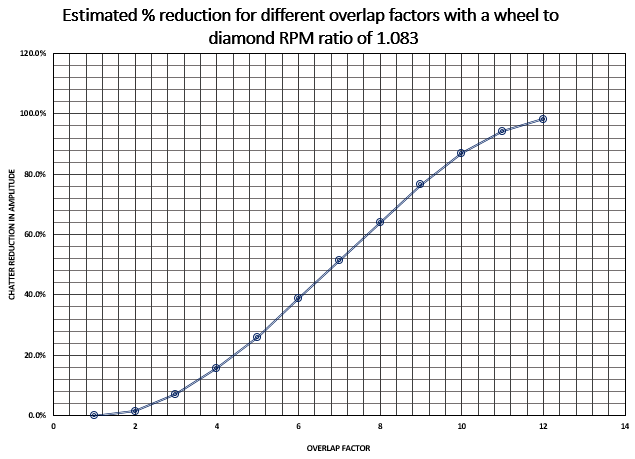

Using this method of analysis, these results can be displayed graphically. Using a wheel-to-dresser-rpm ratio of 1.083, Figure 7 illustrates what happens as the number of overlaps increases from one to 12.
Figure 7

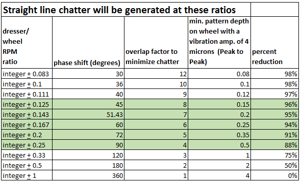

Based on this method of analysis, Table 1 lists the phase shifts and corresponding overlap factors what will minimize chatter.
Table 1

Some rules of thumb can be developed from this analysis. It appears that dresser to wheel ratios of an integer +0.08 to +0.25 would be the best range to be in. However, if the diamond/wheel rpm ratio is less than an integer +0.125, the ratio is too close to 1, a small error would multiply the chatter amplitude many times. Therefore, the recommended range is an integer +0.125 to +0.25 (the green highlighted area in Table 1).
The recommended overlap factor for CBN is three. This does not cover many ratios in Table 1, but, fortunately, CBN wheels generally “round up” diamonds, so dresser induced chatter is not a problem unless there is another disturbing frequency involved.
The Norton iGrind App, available as a free download at https://www.nortonabrasives.com/en-us/igrind, recommends 12 as the overlap factor for traverse rotary dressing of an aluminum-oxide wheel. This is a good place to start, as it covers all the dresser to wheel ratios listed in Table 1.
