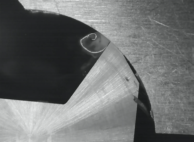

When machining titanium, the highest temperatures are reached near the cutting edge and in the chip. This is evidenced by a light-colored cloud forming around the chip. (Source: Blaser Swisslube)

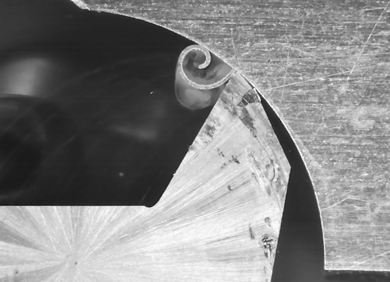

Lead-free brass glides over the cutting edge and forms a thin chip.
Top: When machining titanium, the highest temperatures are reached near the cutting edge and in the chip. Above: Lead-free brass glides over the cutting edge and forms a thin chip. Source: Blaser Swisslube.

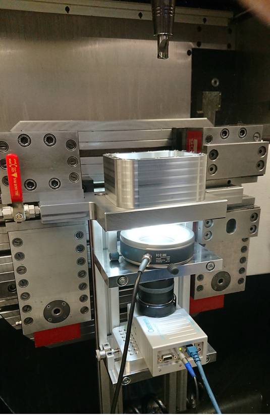

The use of a high-speed camera with a macro lens, which is placed behind a sight glass to keep the metalworking fluid at a distance, should make uniquely sharp, precise recordings possible. A ring light was used to provide the necessary light intensity, as well as a carbide cutter with a helix angle of 0° that was specially ground for this particular test.
The researchers say that the results are fascinating. The high-speed recordings showed for the first time that the mechanism of action of oil-free, water-soluble metalworking fluid, Synergy 735 – namely its improved lubricating effect at higher temperatures – also occurs during machining and is fast enough to optimize milling processes. Synergy 735 thus changes its properties and adapts to the machining process like a chameleon.

The test setup. The idea grew out of a joint project with ETH Zurich. (Source: Blaser Swisslube)
