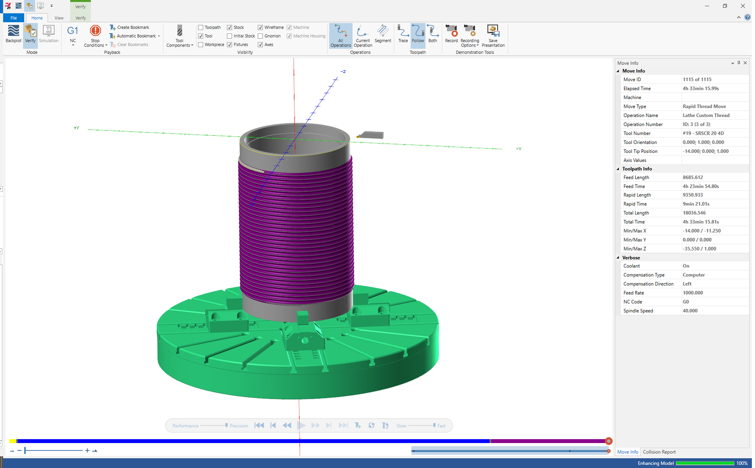

Roberts relies on the software for his shop’s design and production needs. 3D-Machine stays current in Mastercam capabilities by keeping up with the latest releases, including the newest release that features Mastercam Mill, Mastercam Lathe, Mastercam Wire, and Solids. In addition, the company is participating in the Beta Program for Mastercam 2021. Roberts appreciates the software’s generous selection of toolpaths, including a new toolpath he just discovered called Lathe Custom Thread.
The new toolpath supports custom thread forms and expands support for modeling chucks and chuck jaws. The CAM software supports collet chucks as individual component types, which expands the range of machines that can be directly supported.
By selecting chained geometry in Lathe Custom Thread, a programmer can choose the thread cross-section or one of the following parametric definitions: Rope, Buttress, Square, or Trapezoidal. The toolpath includes Mastercam Mill-Turn simulation enhancements, as well as support for select Swiss machining.

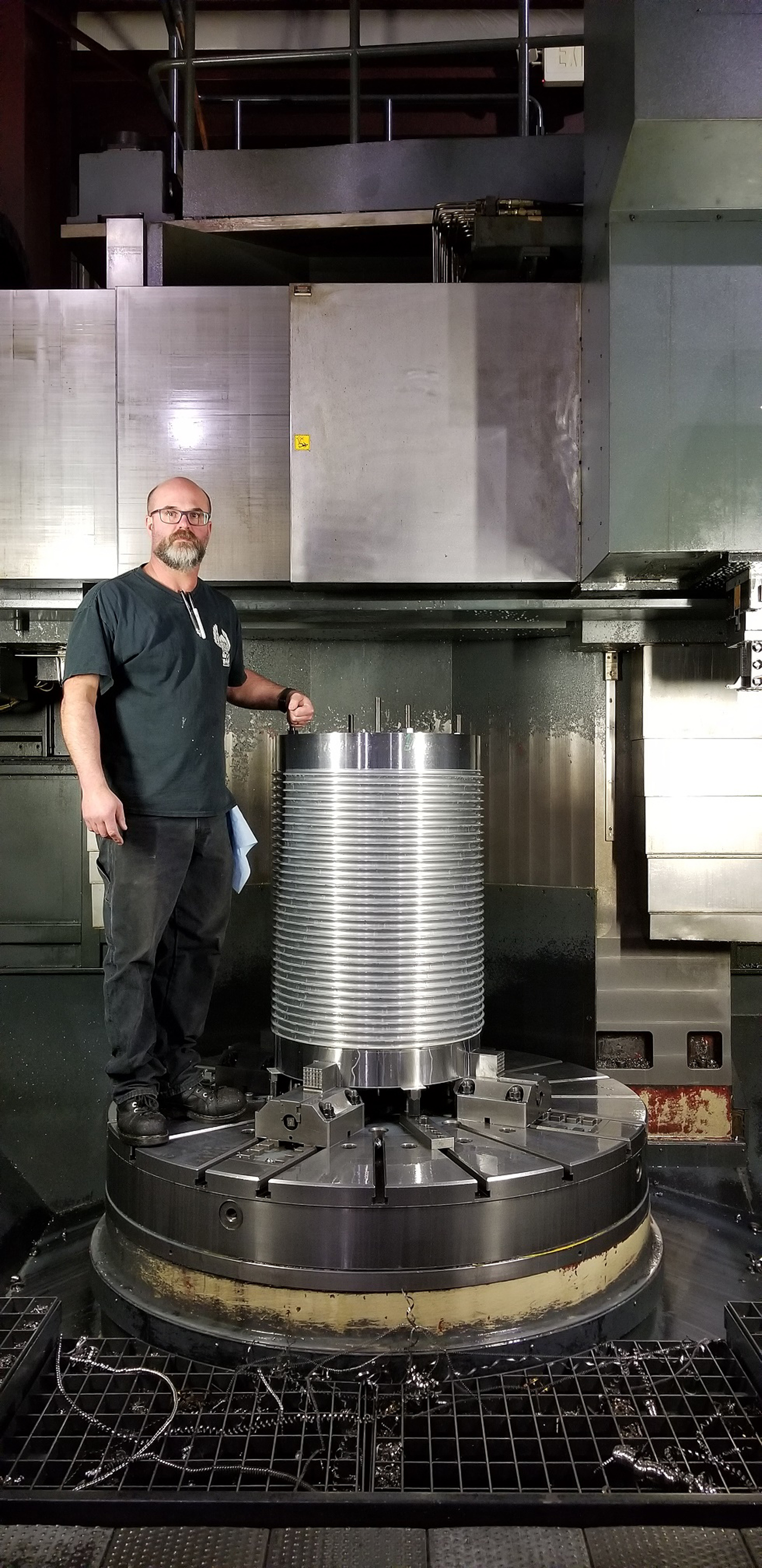

Recently, 3D-Machine produced a carbon steel part for a cable reel. It has a 0.9375” (23.8125 mm) pitch and a 0.406” (10.3124 mm) radius; a 12mm (0.4724”) button tool was used to rough and finish the part.
The part, a hoist drum, employs a wire rope or cable to lift or lower loads. The grooves keep steel cables from overlapping, potentially damaging the cable, and prevent inconsistent lift and lowering of objects. Due to its size, the drum was machined on a large VTL. The selected toolpath is not limited to vertical machining and can just as easily be performed on a horizontal lathe. In this case, the machinist cut a left-hand spiral, so the tool engaged in the cut from the bottom to the top to produce the shape.
“It took us seven hours to put in this groove, which if you laid out in a straight line would measure 212 linear feet,” said Roberts. “We had to use a mill and a rotary to make, rough, then finish the part. We did the deburr on a VTL in seven hours. Because we created the chain, the deburr occurred during the process.”
To ensure that a part’s shape is exactly what they are looking for, Roberts and his team use Verify, a CAM software feature that prevents tool collisions by letting programmers check for gouges, view finished part shapes, and visualize inclusion of fixtures in its simulation screen. Productivity increases and problems are addressed before parts are ever cut.
