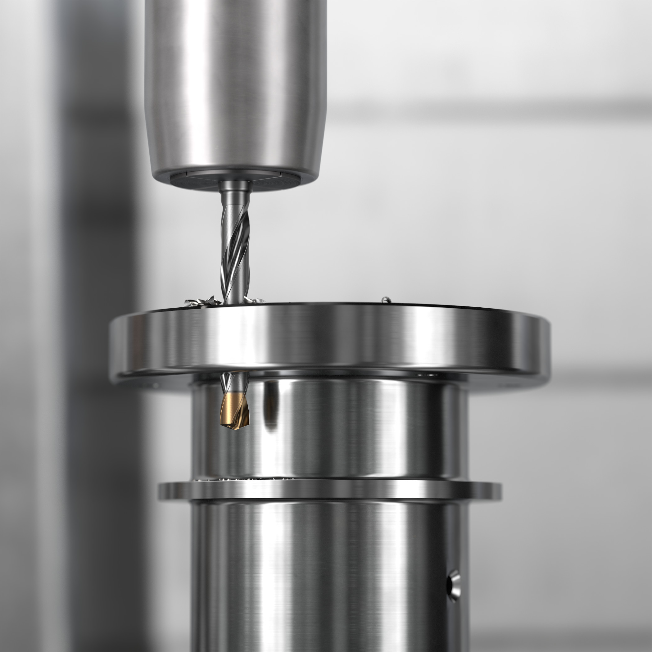

These operations require optimised tools with calculated cutting data. Drilling tools are a prime example. Drill penetration rates can typically vary from 50 to 1000 mm/min. For these tools, precise calculations are vital for avoiding poor tool life or causing premature tool failures. If component material is changing, then drilling cutting data will have to change.
What does the term “the right” tool mean? With drills, this normally refers to tools that perform for longer and produce better quality holes, particularly in tough materials, like Inconel.
Thorpe said that Sandvik Coromant has developed a range of CoroDrill 860 solid carbide drills with optimised geometries suited for different applications that involve tough, difficult materials as well as malleable, abrasive and soft materials typically found in the ISO-K and ISO-N families. The range includes the CoroDrill 860-GM with enhanced -GM geometry, optimized for multi-materials and applications.
Other tools in the range, like the CD860-PM, are optimised for drilling ISO-P steels. The CD860-SM is optimised for ISO-S materials for aerospace parts manufacturing. The CD860-GM is particularly useful for general engineering with mixed-materials, where productivity is important and engineers seek to diversify their production, said Thorpe.
The CD860-GM’s polished flute design improves the evacuation of chips and yields greater hole quality. It is made from a fine-grained carbide substrate that increases hardness while maintaining toughness. In addition, the drill is tip-coated with a multi-layer physical vapor deposition (PVD) thin-film coating, which is key to improving the drill’s productivity and tool life.
This was put to the test by an automotive engineering company in South Korea. The company used the CD860-GM to machine a transmission connector in ISO-P material, then compared its performance with a competitor’s drill on the same component. The cutting data used was a cutting speed (Vc) of 100 m/min, a cutting feed (Fn) of 0.21 mm/rev and a drilling depth of 10 mm. In the end, the customer reported a 1,150% increase in tool life with the CD860-GM.
