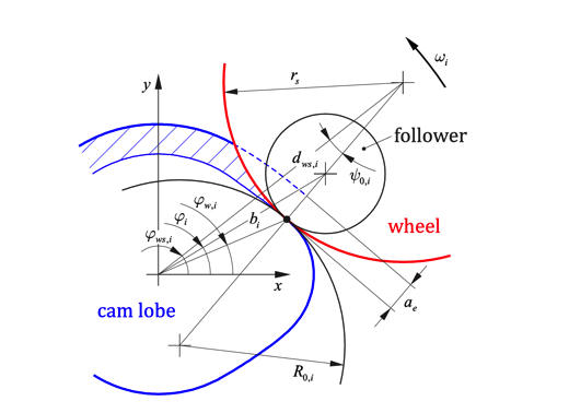

Cam grinding is one of the more complex grinding operations. This is because of the cam’s geometry. In standard, cylindrical grinding, such as for producing shafts and pistons, as the workpiece rotates and the wheel plunges in, the material-removal rate and wheel-workpiece contact area are both constant. This allows grinding engineers to accurately predict what’s happening in the grinding zone and avoid high grinding temperatures.
Cam grinding, in contrast, is “nonround grinding.” Here, the workpiece rotates and the wheel feeds in, but the wheel-spindle assembly also simultaneously oscillates back and forth to produce the strange “egg shape” of the cam. Because of this odd geometry, there are surges in the mrr. These surges lead to several problems.

Figure 2. Cam-grinding geometry.

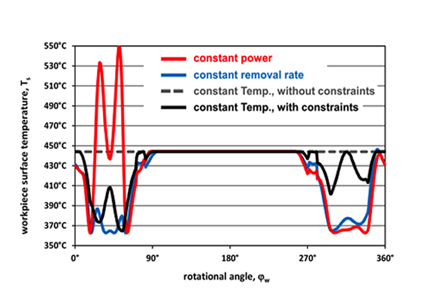

Badger, Krajnik and Dražumerič developed a process called constant-temperature grinding (CTG). The complex kinematics and ever-changing geometry of grinding were determined and then the Jaeger model was applied. Next, the characteristic specific-energy vs. chip-thickness curve was determined via a quick experiment on the machine while grinding under cylindrical-grinding conditions. Now, the amount of abrasive-grit rubbing vs. cutting could be determined at every single point along the wheel/workpiece interface and, hence, the amount of heat generation was known. This curve was then input into the model to search for the optimal conditions that would give not a constant rpm or constant power, but rather a constant temperature—in this case 450° C, which was below the burn threshold.

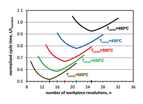

Next, the machine constraints were added to the model. The engineers worked with a CNC machine builder to determine the machine jerk limitations. Without machine constrains, the shortest cycle time occurred at a small grinding DOC but a fast workpiece rpm. This meant that the workpiece rotational jerk and the wheelhead linear jerk were enormous. When the machine constraints were introduced, the optimum constant-temperature conditions changed. The results are shown in Figure 3.
Figure 3. Predicted workpiece surface temperature of constant-mrr, -power and -temperature processes.
For a burn-threshold of 450° C, the optimal number of increments was 21. However, stricter temperature controls could be used, such as setting a temperature threshold of 400° C. This changed the optimal number of increments to 25. A more lenient temperature control could also be used. For example, a temperature threshold of 600° C could be used, requiring 14 increments and giving a shorter cycle time. In the end, a temperature threshold of 441° C was chosen.
Figure 4. Nominalized cycle time based and number of workpiece increments based on workpiece surface temperature.

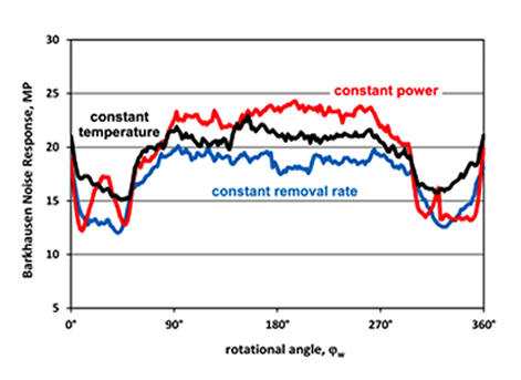

Cams were then ground with the new cycle. Surface finish and workpiece geometries were measured to determine if the final part met the tolerance specifications. Next, grinding burn was measured.
Grinding burn is notoriously difficult to measure and quantify. Previously, the only ways to evaluate grinding burn were: 1) to cut, polish and etch the workpiece and examine its microstructure under a microscope, looking for “white layer”; 2) to remove a small section and send it for X-ray-diffraction measurement; or 3) to dip the entire part in nitric acid and look for white layer. All are time-consuming, and the first two are destructive.
Fortunately, developments by Stresstech OY in Finland allow for nondestructive testing by using Barkhausen Noise to detect softening, residual tensile stresses and phase changes in the material. Scania sends all camshafts through a vigorous Barkhausen Noise test routine to assure 100 percent quality of its production.
The results of Barkhausen measurements are show in Figure 5, which indicates that the Barkhausen Noise value was held below a predetermined safe-threshold level.
​Figure 5. Barkhausen Noise response.
