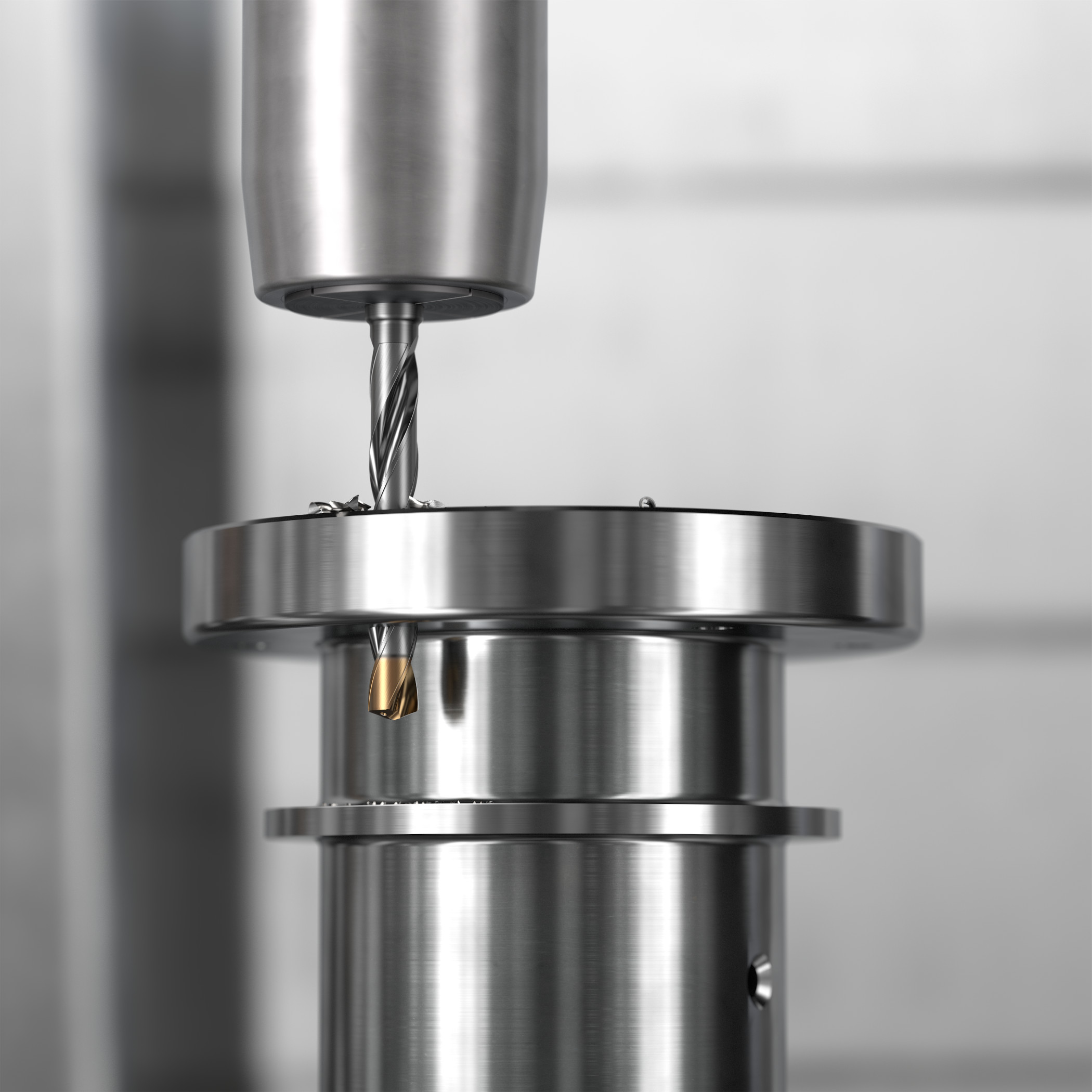

Sandvik Coromant’s specialists had this in mind when developing the CoroDrill 860 with enhanced -GM geometry, a newly designed solid carbide drill optimized for a wide range of materials and applications across all industry sectors.
Unique approach to design
For Sandvik Coromant’s specialists, the key to longer tool life is not limited to the amount of time a tool spends in use, but the drill design itself.
The CoroDrill 860-GM has an innovative, polished flute design. The groundbreaking design improves the evacuation of chips and yields greater hole quality, in addition to helping reduce heat buildup and cutting forces while drilling. Other key features of the drill’s design include a reinforced core and corner chamfers, edge preparation to remove cutting micro defects and a double margin to enhance drilling stability. The drill’s point is also designed with refined clearance angles and improved surface quality.
The CoroDrill 860-GM is suitable for all applications where hole quality is critical. This includes applications in aerospace, general engineering, oil and gas, nuclear and renewable power. Its optimized reliability has also been proven in automotive production, including in drilling engine blocks, casings, flanges and manifolds.
Tool technology in practice
As manufacturing becomes increasingly automated, unpredictable tool life is becoming a more prominent issue.  In Korea, an automotive manufacturer experienced this exact problem and worked with Sandvik Coromant to improve tool life.
The application used the CoroDrill 860-GM to drill through holes for automotive transmission connectors. Overall, eight 8.2 mm diameter through holes were drilled into each component measuring 10 mm in depth. The previous tool produced 200 components, 1,600 holes in total, with a cutting speed (Vc) of 80 m/min (3,102 RPM) and cutting feed (Vf) of 381 mm/min. In comparison, the CoroDrill 860-GM produced 2,300 components, or 18,400 holes, with a Vc of 100 m/min (3,878 RPM) and Vf of 814 mm/min.
The result was a significantly improved tool life of 1,150%, and a productivity increase that lowered overall cost per part.
In addition to facilitating longer tool life, these tools can deliver increased cutting data and therefore enable faster cutting rates. In fact, an engineering company in Lancaster, Ohio, was able to achieve a 57% faster cutting rate when using the CoroDrill 860-GM versus a competitors drill. The application used the tool to drill sensor housing components made from 304 stainless steel—11 holes in each, 6.6 mm in diameter.
