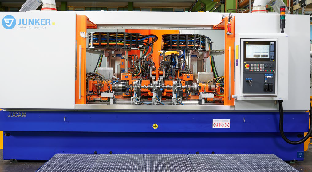

A matter of pure form The JUCAM machines impress with precise grinding results in a single clamping set-up. (Source: JUNKER)
The JUCAM machines impress with precise grinding results in a single clamping set-up. (Source: Junker)

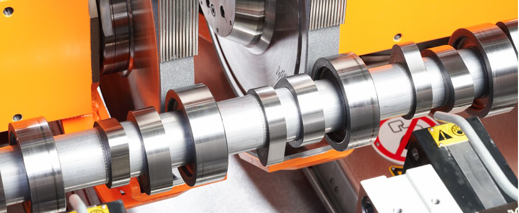

Two wheelheads with four grinding spindles were installed in the grinding machine. The camshaft is clamped between centers, an integrated driver and a retractable jaw chuck. The ultra-precise in-process measuring systems ensure perfect radial and longitudinal positioning. First the bearings are machined, followed by the pump cams and inlet and outlet cams. An additional step to deburr the elements is not required.
JUNKER‘s non-cylindrical grinding machine, JUCAM, provides process reliability by machining in a single clamping set-up. Bloemen said, "Halving the cycle times while complying with the tolerances is an optimum result.“
Top speeds are achieved especially with the installed linear motors and the proven hydrostatic guides, as well as a reliable coolant system. The complete machining does away with the need for repeated loading and unloading. Within a defined spectrum of workpieces, the grinding machine can be easily set-up without mechanical retooling.

JUCAM non-cylindrical grinding machine With the new JUCAM 6L platform, the truck camshafts are machined efficiently and ultra precisely in a single clamping set-up. (Source: JUNKER)
JUCAM non-cylindrical grinding machine With the new JUCAM 6L platform, the truck camshafts are machined efficiently and ultra precisely in a single clamping set-up. (Source: Junker)
The installed in-process measuring systems ensure a precise profile contour on the cylindrical and non-cylindrical elements alike. These allow the data to be incorporated into the grinding process in real time. Even the smallest deviations are corrected immediately. The JUCAM machine runs fully automatically in continuous operation. The high-speed grinding machine is loaded by a robot and unloaded by a gantry loader.
