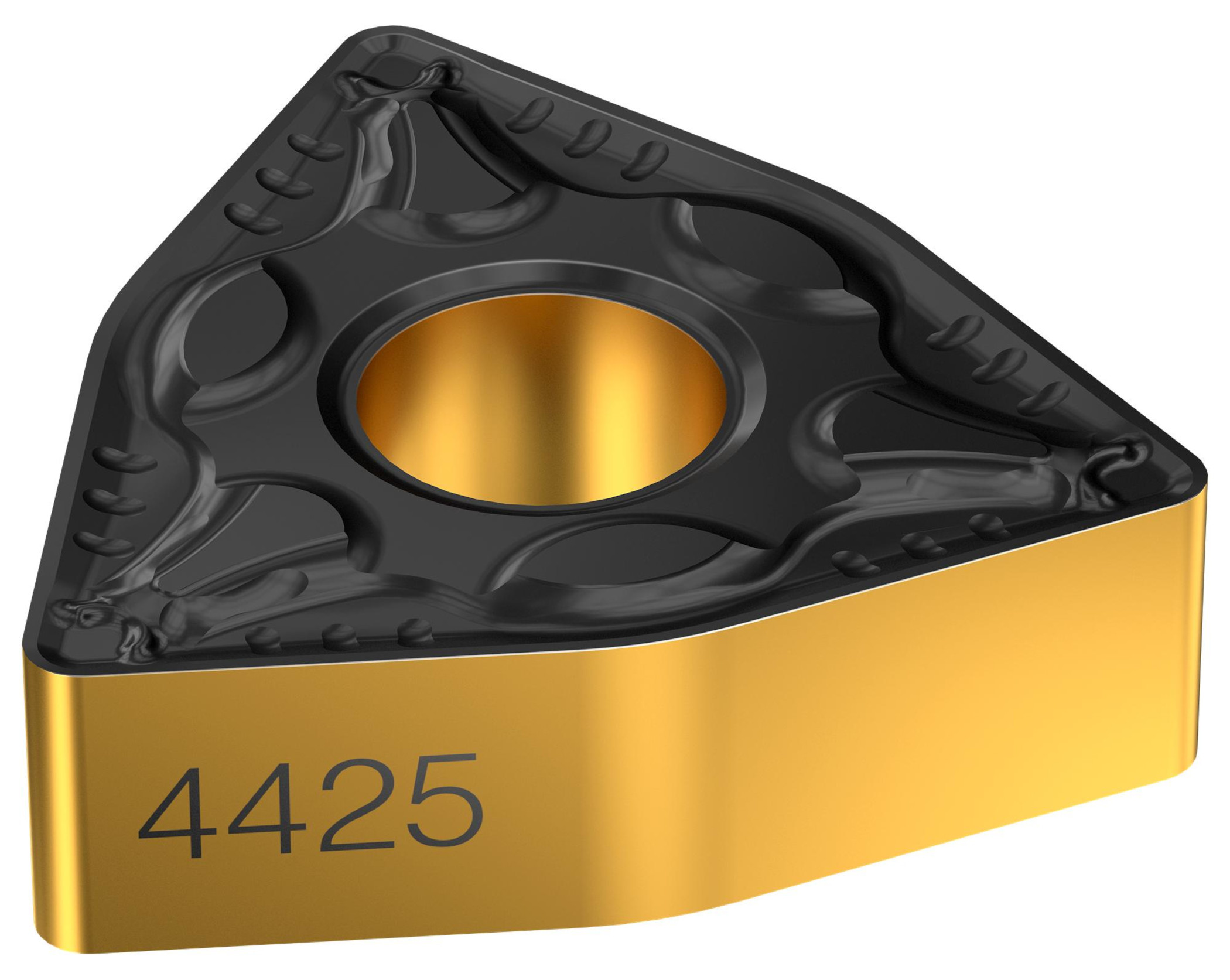

Longer tool lifecycles and improved chip control are essential to cost-effective machining. Both can be aided by reducing heat build-up in the tool by applying coolant. One Sandvik Coromant customer experienced this while machining hub components made from an unalloyed steel, P1.2.Z.AN (CMC 01.2), using flood coolant. The existing process subjected the workpiece to rough turning in an Okuma horizontal lathe, and produced up to 30 pieces before signs of wear were noticed on the tool.
The machine shop wanted to improve the chip control and tool life, with improved process security and cycle times. To achieve this, the customer swapped its existing insert with a CoroTurn 300 QS shank tool for turning using precision coolant instead of flood coolant. The end result was that the customer was able to machine up to 79 components before the tool showed signs of wear — an increase in tool life of more than 263%.
Overall, using the CoroTurn 300 QS with precision coolant increased the machine shop’s productivity by 180%.
Of course, these advantages also benefit the bottom line. In another instance, a Sandvik Coromant customer in aerospace was able to machine two sets of main landing gear for an aircraft with a single tool, the GC4425 in combination over and under coolant. The previous solution, using a competitor’s tool with flood coolant, only machined 0.8 components before signs of wear were noticed. Again, this led to much increased tool life — by 250%.
The customer could now run two full components before any risk of insert failure, gaining productivity and cycle time by removing the stop for insert change. This equated to a 29% cost reduction.
