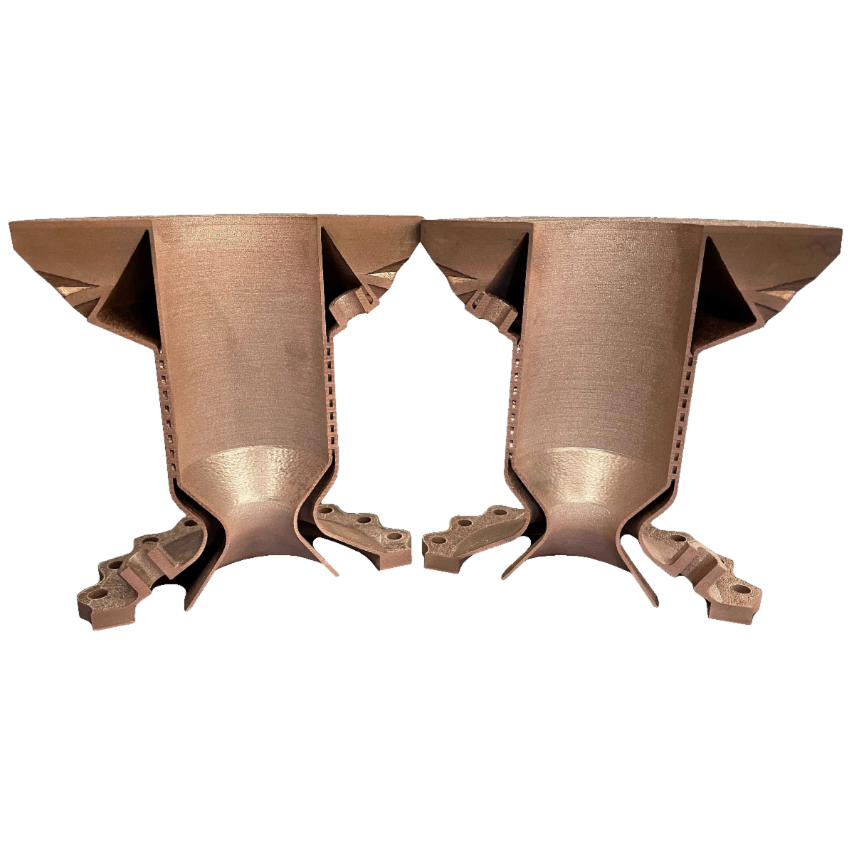

3D cross section
Top: GRCop-42 aerospike thruster prototype on build platform after 3D printing. Image courtesy Knust-Godwin. Above: A cross-sectioned thrust chamber printed on a Velo3D Sapphire system in GRCop-42. The chamber walls contain internal channels for regenerative cooling. Image courtesy Velo3D

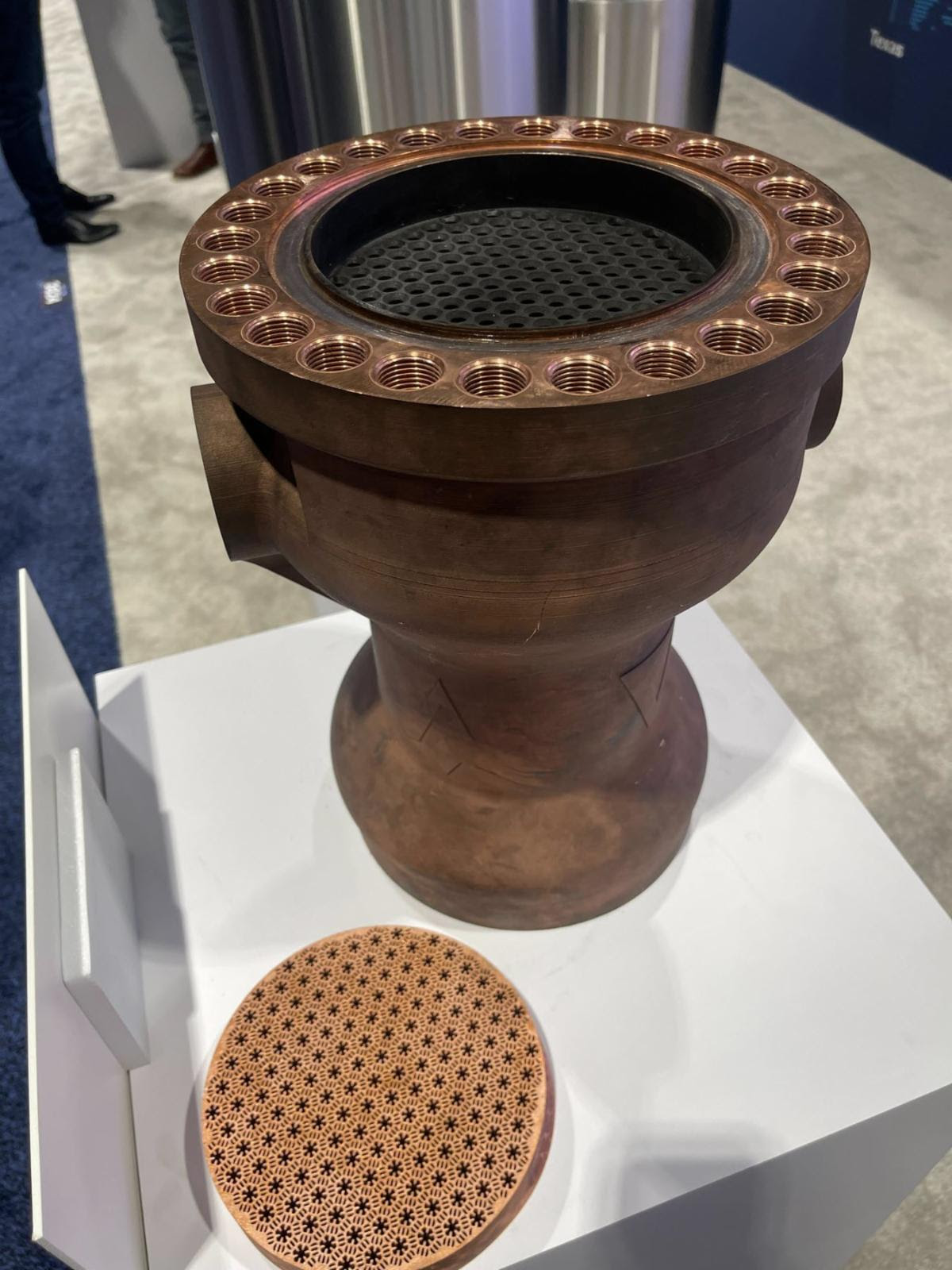

A GRCop-42 heat exchanger produced by Launcher, a VAST company, to simulate the combustion chamber regenerative cooling channels of its E-2 rocket engine. This heat exchanger has been hot fire tested by Launcher in its testing facilities. Image courtesy Launcher

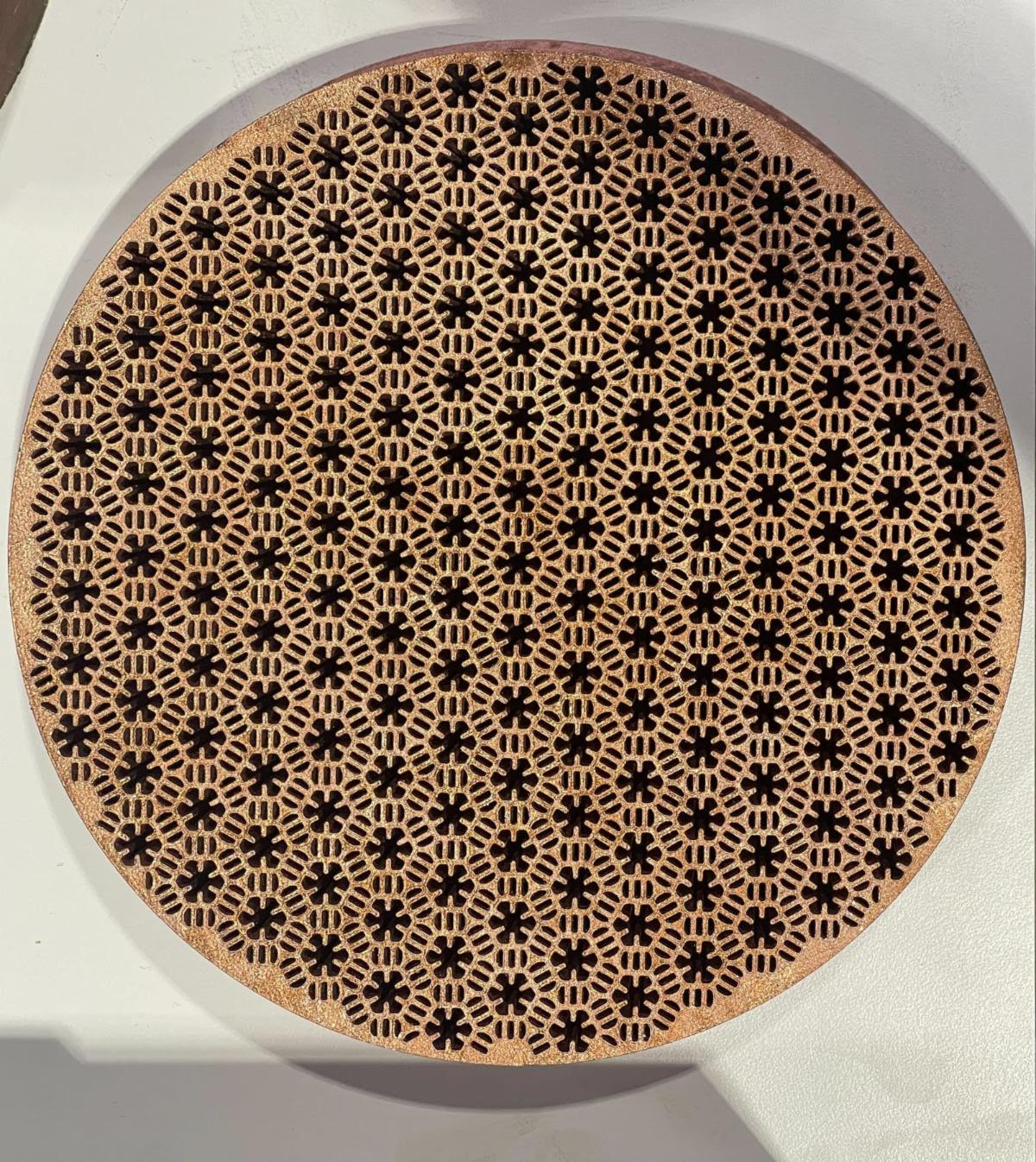

An internal segment of a GRCop-42 heat exchanger produced by Launcher, a VAST company. The part showcases the design and print quality of the internal cooling channels used in the heat exchanger. Image courtesy Launcher
