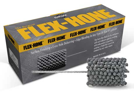

According to Garaczi, the tool he selected for such applications is the Flex-Hone from Los Angeles-based Brush Research Manufacturing (BRM).  Characterized by the small, abrasive globules that are permanently mounted to flexible filaments, the product is a flexible, low-cost tool utilized for sophisticated cross hole deburring, honing, surfacing, and edge-blending.  The hones are available in a variety of abrasive types, sizes, and grit selections.

For best results, the deburring tool is typically rotated into the main bore into which the cross holes break.  After a few clockwise strokes, the tool is removed and the spindle reversed to rotate and stroke the flexible hone in a counterclockwise direction for a few more strokes.  The forward and reverse rotation creates a symmetrical deburring pattern.  Coolant should be used to keep metal cuttings and deburred metal in suspension.

Garaczi notes that the Flex-Hone is available with a premium nickel coated diamond abrasive for use on materials like carbide, ceramic and aerospace steel alloys; as well as a CBN option that is even harder and is specifically designed for superalloys. These superalloys can exhibit high ductility and work hardening that produce a gummy machining behavior if the correct abrasive tool is not utilized. He added that Flex-Hone helps deburr superalloys such as titanium or heat treated 13-8 stainless alloy.

“For a part, we might use two to three different size hones, depending on the number of cross port intersections and different hole sizes,” says Garaczi.  “However, it is really easy to put a Flex-Hone in a toolholder, give it a simple toolpath cycle and let it run.”
