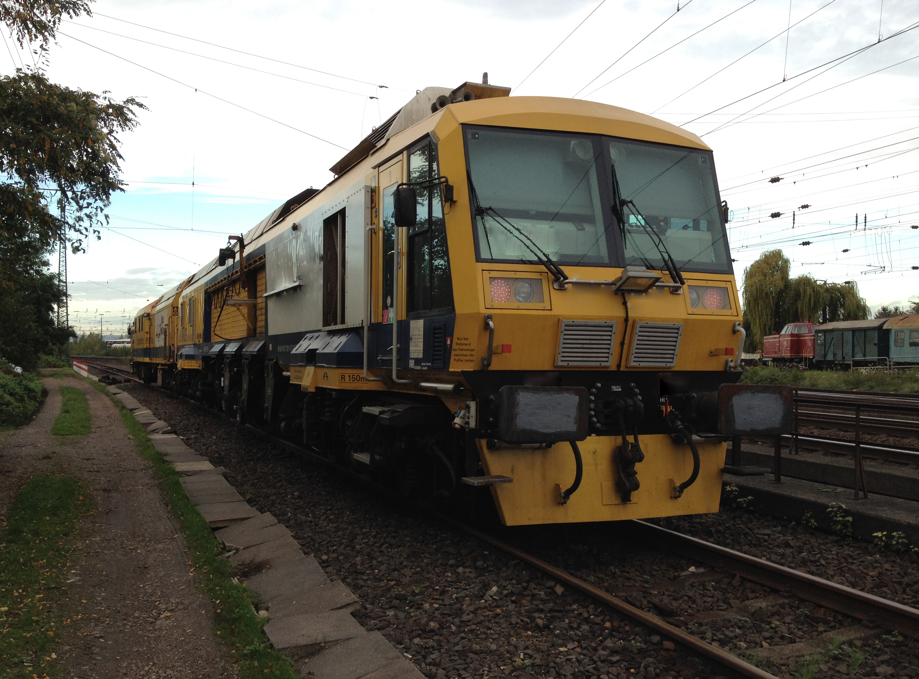

A train dynamically milling a railway line.

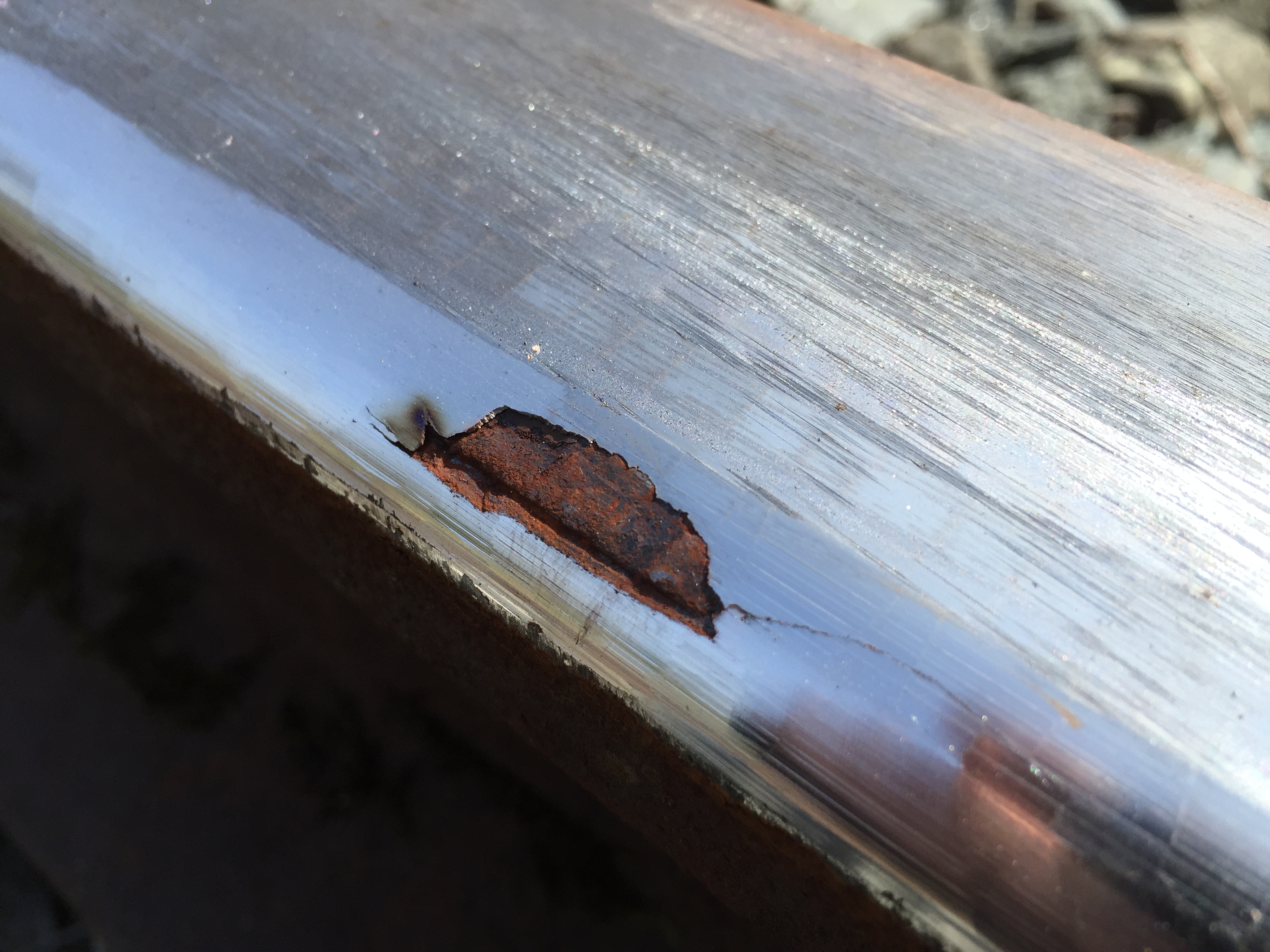

A pitted rail which requires renovation.
To combat against this constant force between track and vehicle, there is a need to make sure the rail remains in a good condition. There are several reasons for rail treatment, but primarily it is an issue of operational safety. With the mechanical stresses in wheel and rail contact, cracks can appear on the surface of the rail. These have to be removed quickly before they spread and destroy the track area.
A regular assessment of the rail profile is important for limiting damage to the track and rolling stock. Over time, rail wear can substantially increase and ultimately lead to train derailment. Also, another objective is to enable modern high speed trains to use existing lines, while maintaining reliability and safety standards.

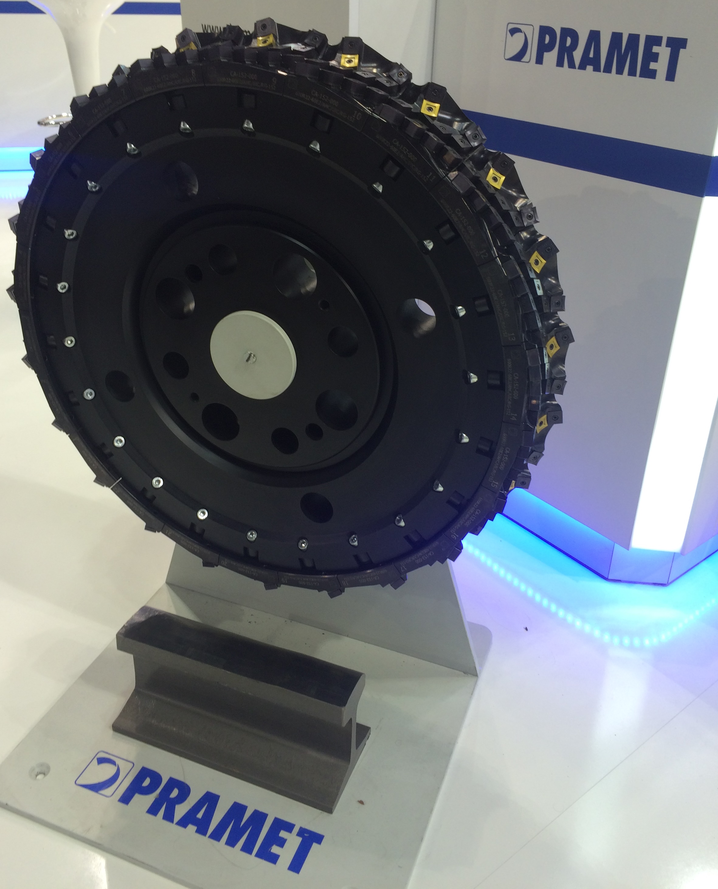

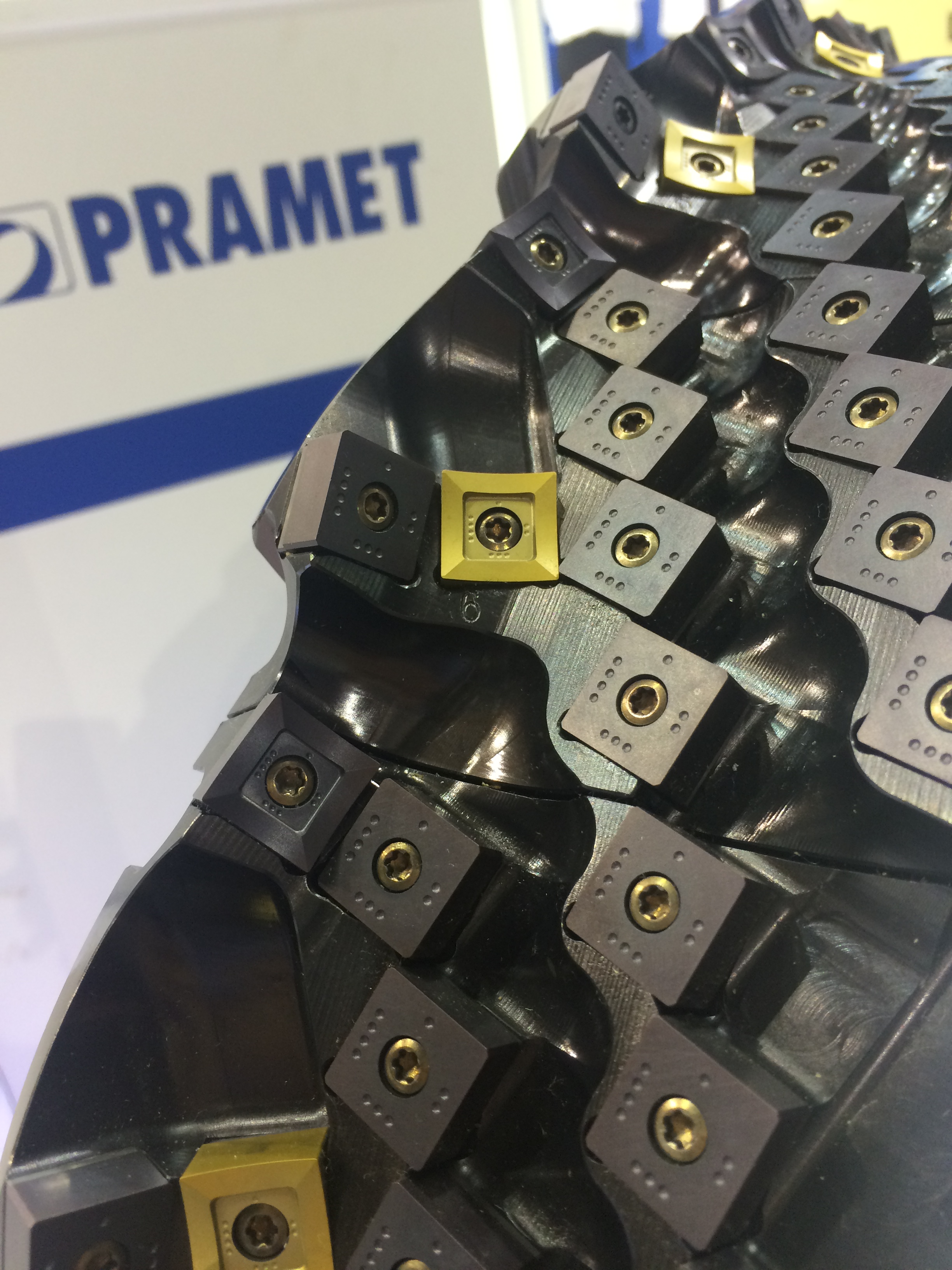

The Pramet dynamic rail milling cutter.
The Pramet dynamic rail milling cutter (pictured above and below).

Another and more productive alternative is dynamic rail milling. The re-profiling of a railway line without removing the tracks represents a significant savings in time and expense. It is therefore no surprise that dynamic milling of rails has become one of the most popular methods. But this "on the-move" application requires specialized equipment to achieve optimum results.
Dynamic milling can be performed by specially designed trains, operating at a constant speed of 700 meters per hour. Rails made of R350HT steel have good abrasion resistance, with a hardness of between 900 MPa and 1,200 MPa. Sometimes the passage of trains results in the rail head being hardened up to 1,500 MPa. To re-profile the rails, two milling units are used. The first roughens the surface, the second one finishes it, and the two units act on both rails simultaneously.
The final rail profile and high quality surface finish are ensured by the grinding units, while metal chips produced during milling are transferred to a nearby container, making sure no debris or swarf is left on the track.

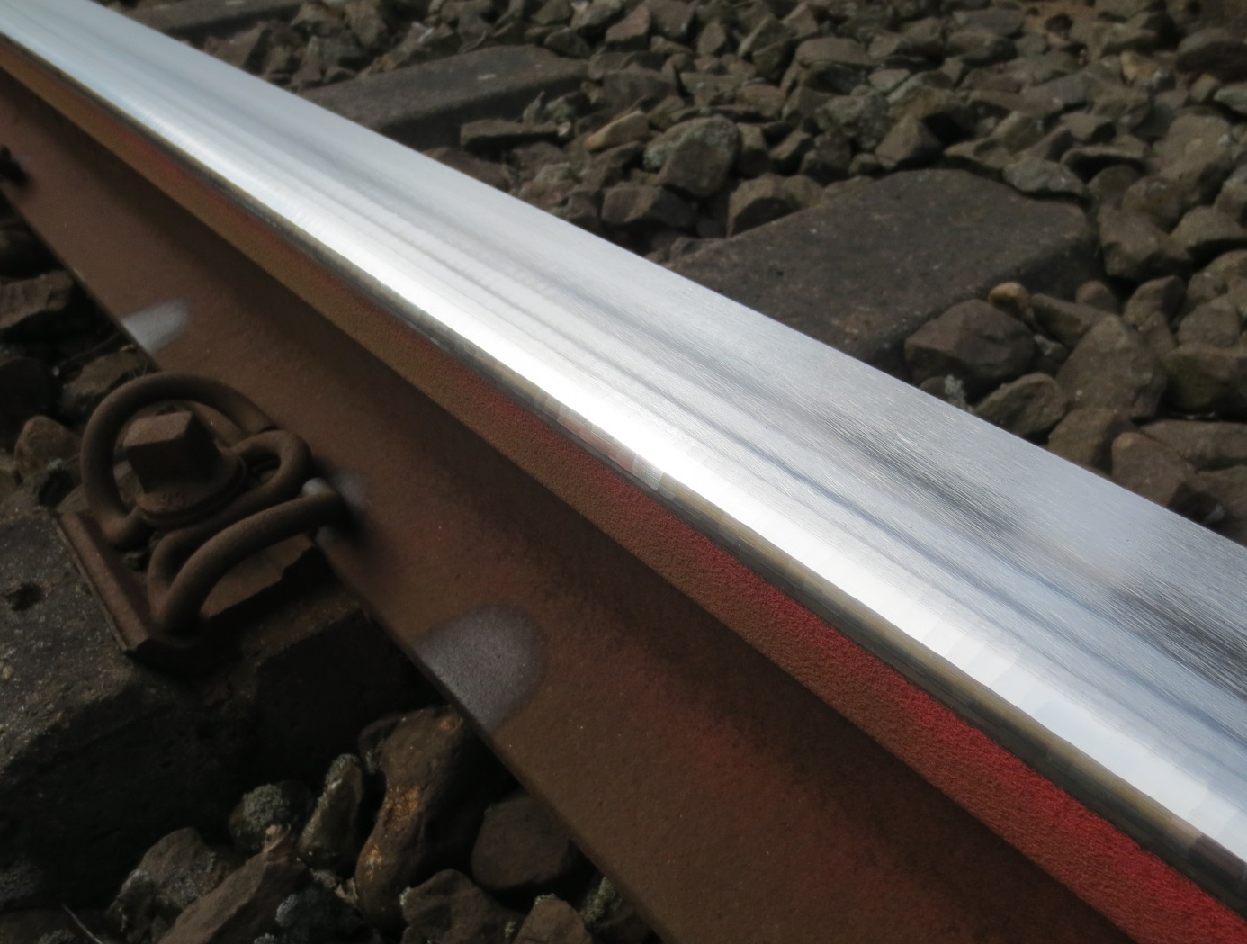

A railway line after profiling treatment.

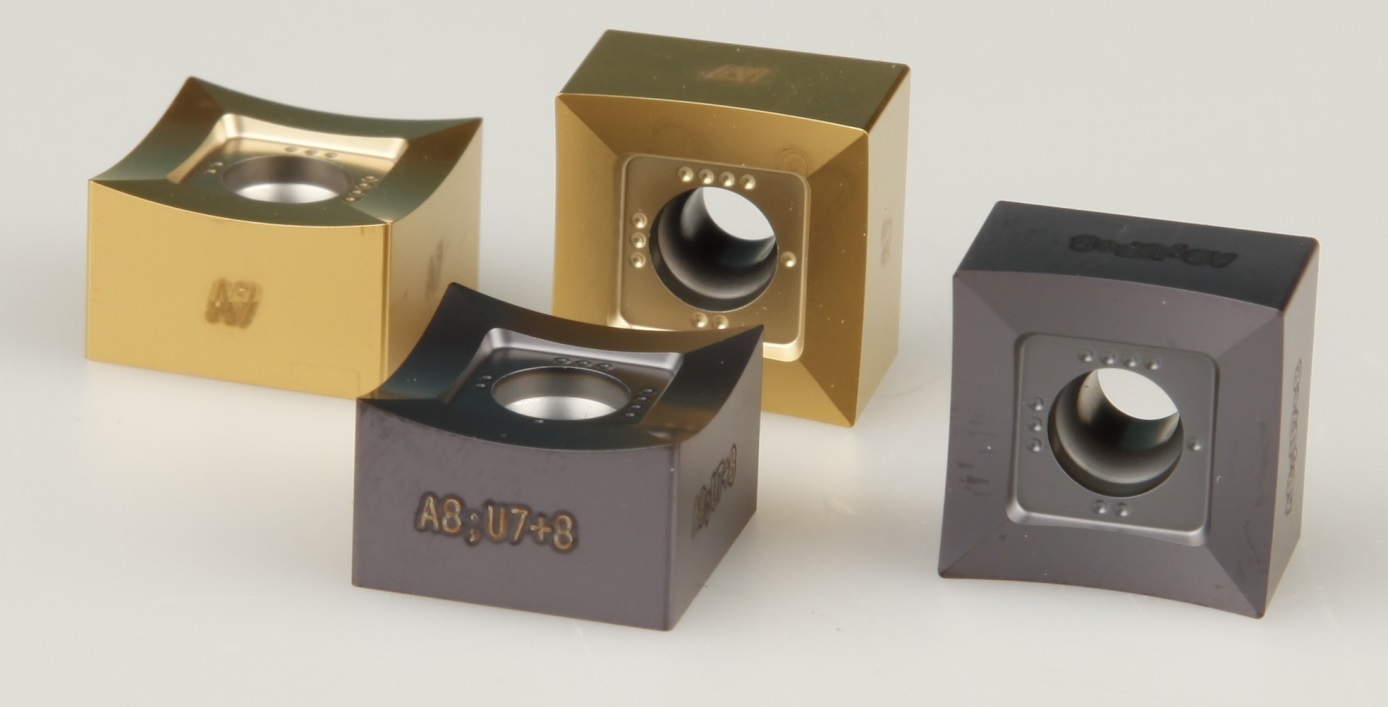

Dormer Pramet delivers inserts specifically for us in railway applciations.

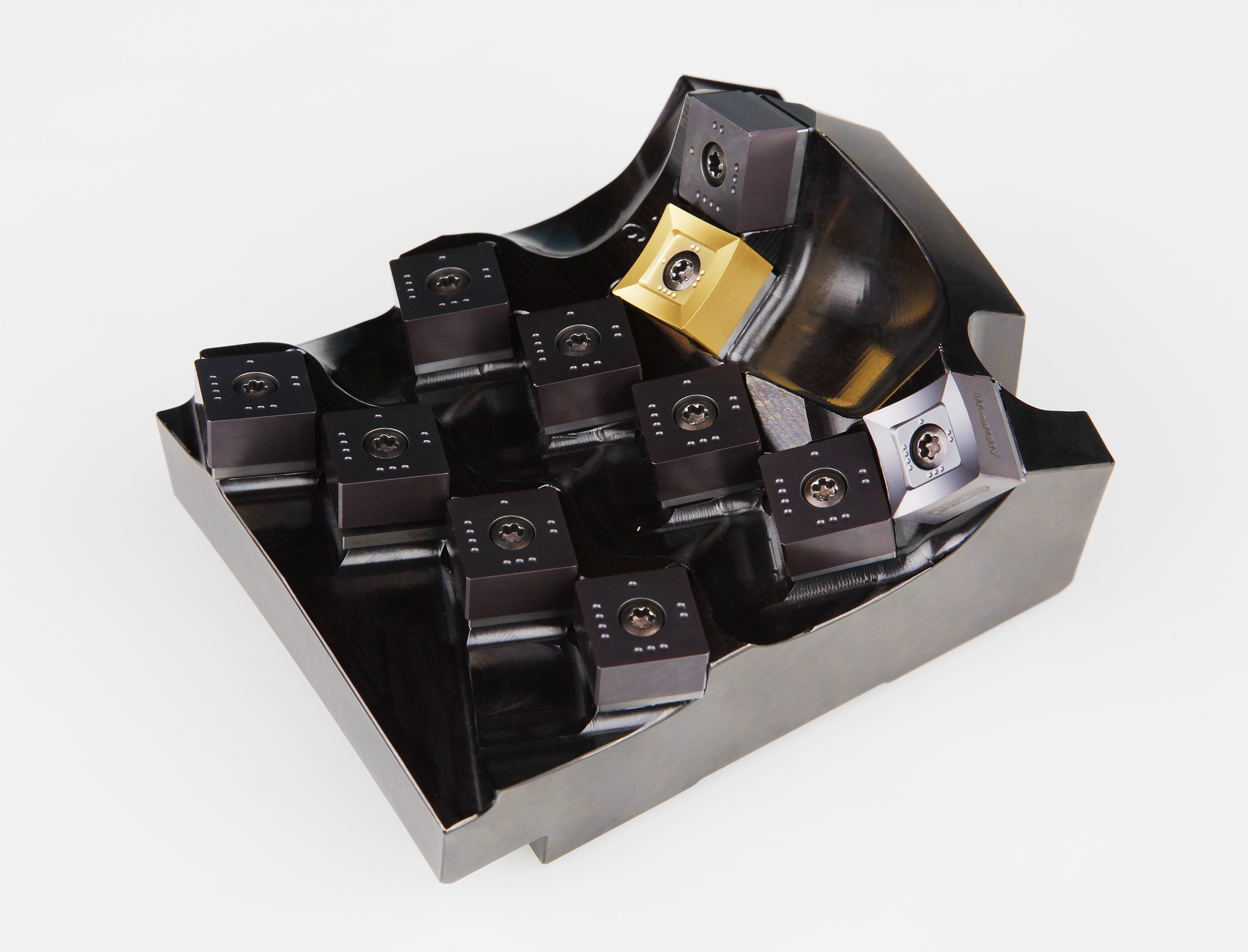

Dormer Pramet’s range for the rail industry includes disk mills, cartridges and indexable inserts for dynamic rail milling. Pramet’s rail milling cutters, for example, have a diameter of 600mm, a cutting speed of between 220m/min and 280m/min, and each cutting tooth can deal with between 4.5mm to 5mm of rail length, cutting to a depth of between 1.0mm and 1.5mm.
A variety of universal and removable cassettes are also available, with each consisting of a casing which is identical for left and right hand rails, supporting both roughing and finishing applications.
These cassettes are also used for different rail profiles—the AHC (Anti-Head-Check, for rails used by trains operating at speeds up to 160 km/h) and the UIC 60E2 profile for high-speed lines. When the profile needs to be changed, it is only necessary to replace two out of the 11 inserts in each cassette.
A variety of universal and removable cassetts are available for dynamic rail milling.
