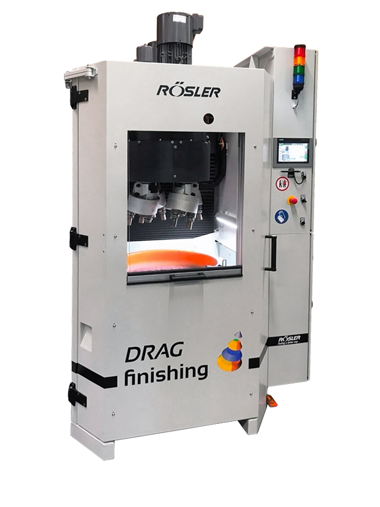

The compact, universally usable drag finisher R 4/700 SF is equipped with a carousel with four rotating spindles. Each spindle holds three work pieces. Separate rotary drives of carousel and spindles allow the individual, entirely independent adjustment of their rotary speeds.With eleven manufacturing locations in Europe, North-America and Asia the voestalpine Rotec is a globally operating company that specializes in precision steel pipes and tubes. A member of the internationally operating steel and technology corporation voestalpine, the company is constantly looking to improve its processes.

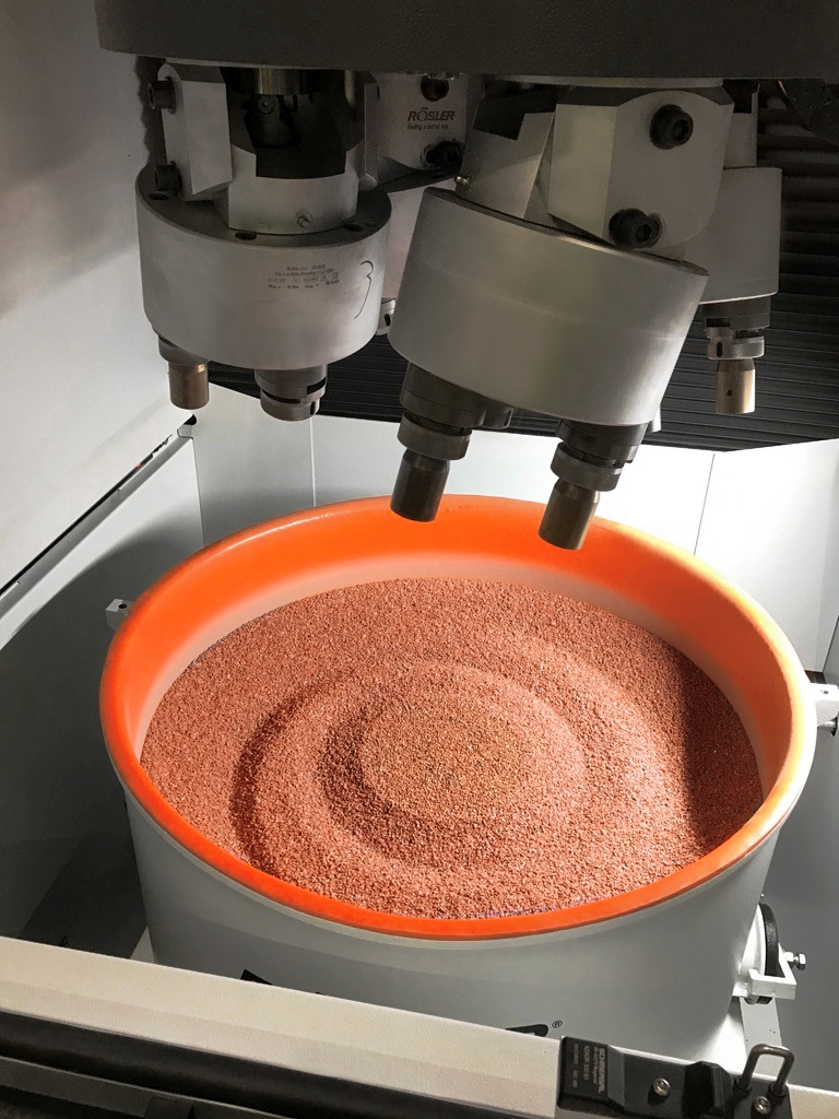

The processing bowl of the plug-and-play drag finisher can be easily exchanged with a fork lift truck. This allows quickly switching from one application to another without having to replace the processing media.At the heart of the compact, plug-and-play drag finisher is a carousel equipped with four rotary spindles, each spindle allowing the mounting of three work pieces. The R 4/7000 SF systems’ carousel and the rotary spindles are outfitted with separate drive motors allowing the setting of totally different rotary speeds for carousel and spindles. The processing bowl is filled with processing media, which in this particular application consists of crushed walnut shells and aluminum oxide. A vibratory motor mounted below the processing bowl ensures the optimum mixing of the processing media. Required bowl changes can be quickly carried out with a forklift truck.
For the actual process the tools to be finished are manually mounted to specially designed work piece fixtures, which in turn are attached to the spindles equipped with quick-connect couplings. To facilitate this operation, the operator moves the spindles to the load/unload station with the touch of a button.
After the respective processing program has started, the carousel with the spindles is lowered so that the rotating spindles are immersed in the processing media. Carousel and spindles are moving clockwise and counterclockwise at the defined rotary speeds. At the midpoint of the processing cycle the rotary direction is usually changed. This guarantees an even radiusing of the tool edges on all sides. Depending on the tools to be finished, the total finishing time varies between 15 and 45 minutes.
