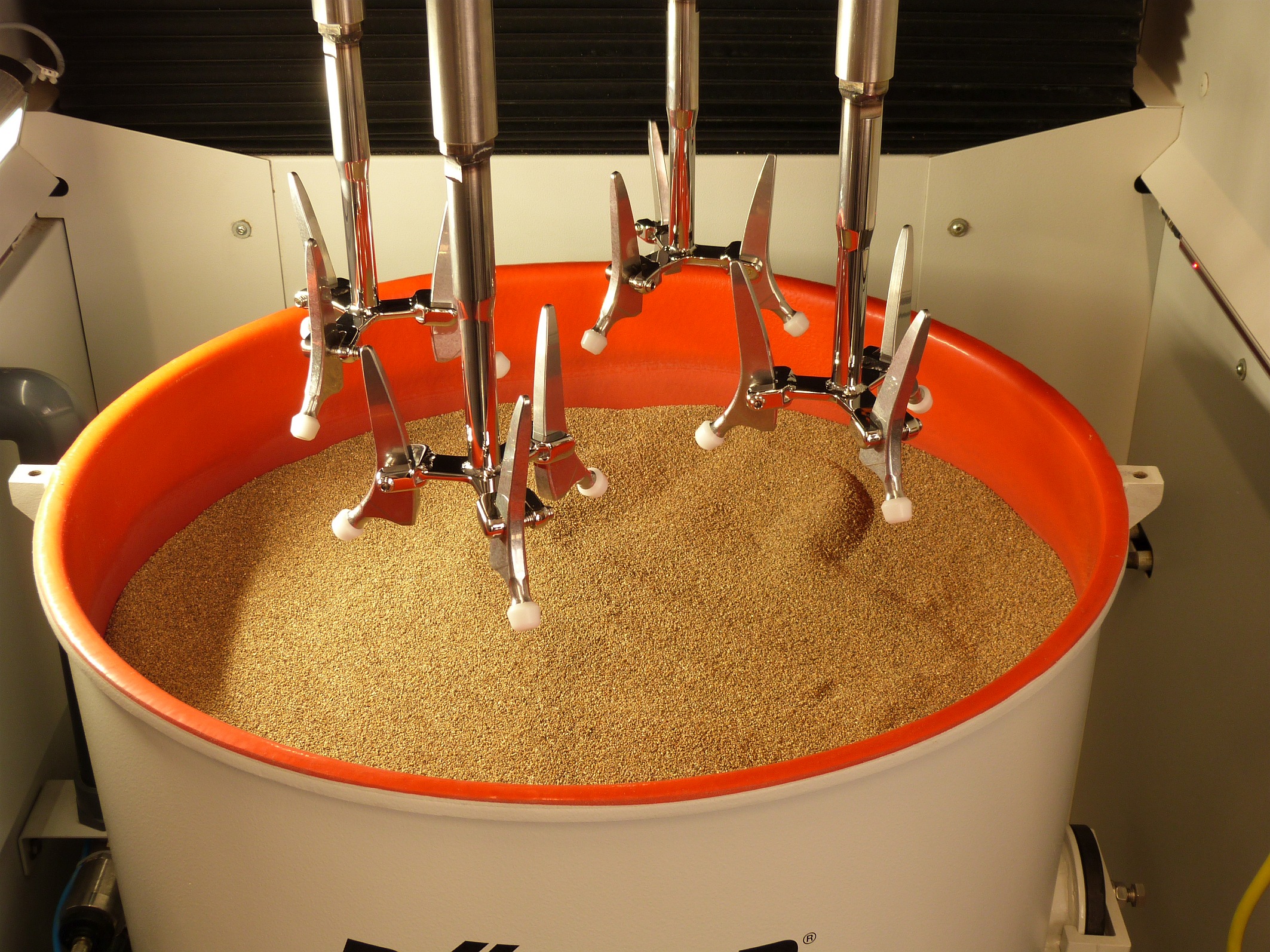

For the second finishing stage, the processing bowl is simply exchanged with another one. The polishing stage takes place in dry mode with a maizorb media producing a minimum of dust.

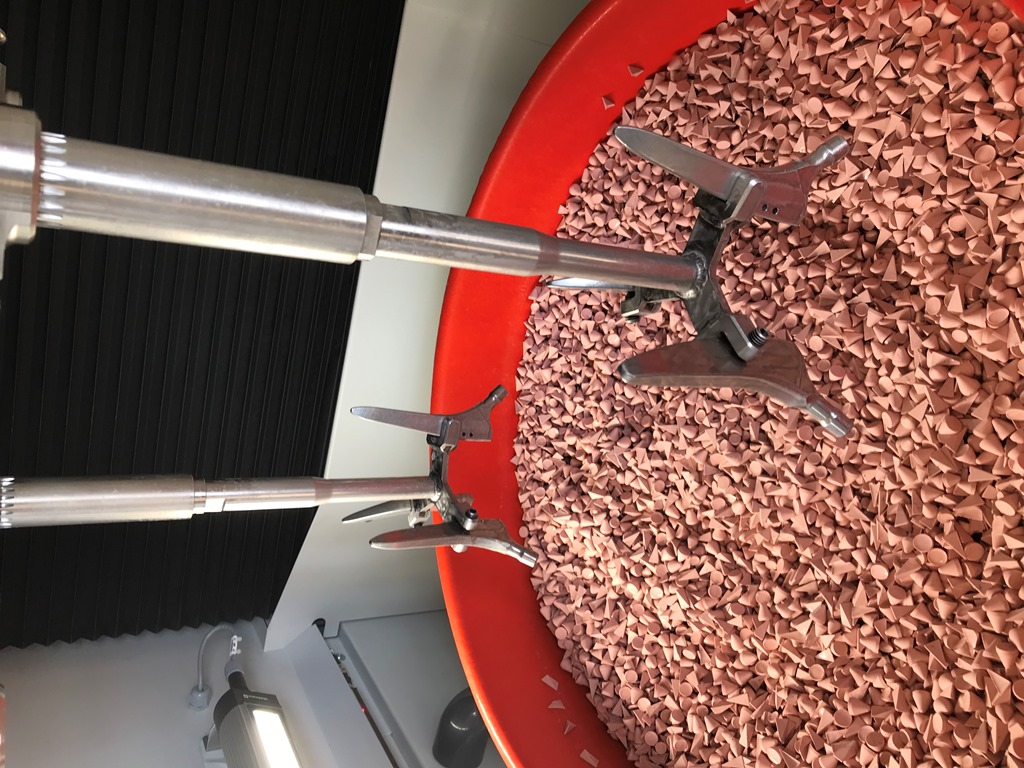

IMG Grinding of hip stems with plastic media
The hip stems are attached to a specially designed clamping device that can be universally used for all hip stem types and sizes. For the first finishing stage - wet grinding & pre-polishing – a mix of plastic media in combination with a special compound is utilized.

After the respective processing program, stored in the programmable system controls, has started, the carousel is lowered so that the rotating spindles are immersed in the processing media. For the wet grinding process, a mix of plastic media with different geometric shapes and a special compound are utilized. Carousel and spindles are rotating at the pre-defined speed in opposite rotational directions.
After about half of the cycle time – amounting to less than one hour – the rotational direction is normally reversed. This ensures that the neck area of the hip stems receives an all-around perfect homogeneous finish. For cleaning the process water from the wet grinding process, MBN Präzisionstechnik purchased a semi-automatic Rösler centrifugal process water recycling system, model Z 800. Recycling the process water protects the environment and helps to significantly reduce the finishing costs.
For the polishing operation, a plant-based dry polishing media is utilized. For this process stage, requiring a cycle time of under 20 minutes, the processing bowl containing the finishing media is simply exchanged with the bowl filled with polishing media. Müllner said,” With the automatic drag finishing process we could significantly improve the quality and consistency of the finishing results. At the same time, compared to our previous finishing operation, the costs for grinding and polishing of the hip stem neck could be reduced by two thirds. Therefore, this investment will be amortized within three years.”
