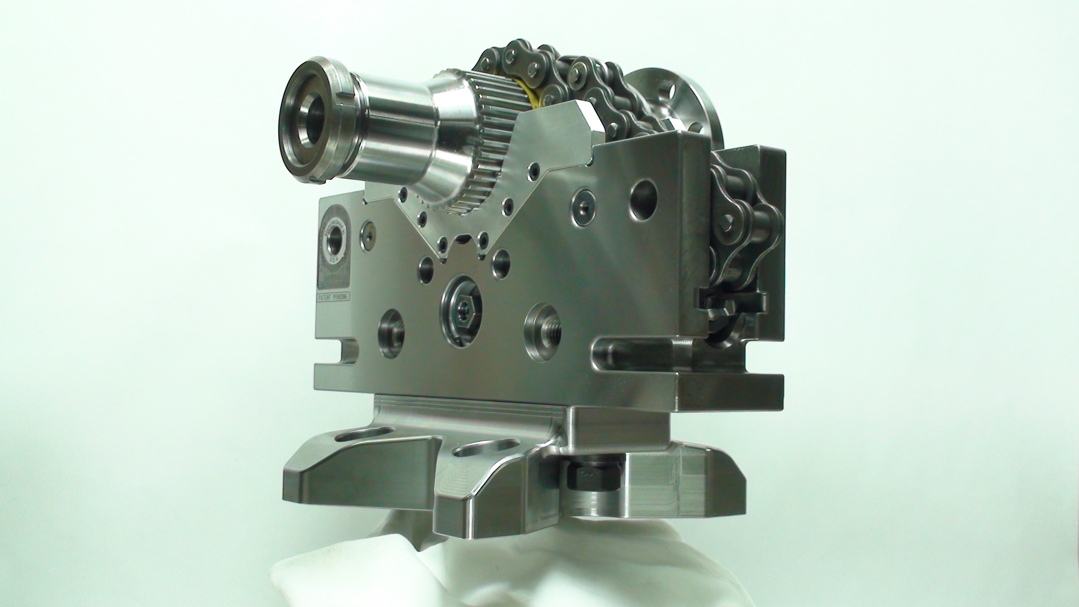

An aircraft propeller shaft is mounted in Uni-Vee. The jaws (front and back) were custom shaped for this part. Uni-Vee is installed on the optional indexing base plate. This allows removal of the part from the machine bed and re-installation on the machine bed (or another machine bed) without re-location prior to continuing the machining process.
With no protrusions on its front, back or bottom, Uni-Vee can be installed directly into the shop milling vise or to lay flat on a table or surface plate. This also facilitates laying down the Uni-Vee for the contouring of custom jaws, eliminating the need for a special fixture and a chance to increase the accuracy of shop-built jaws.

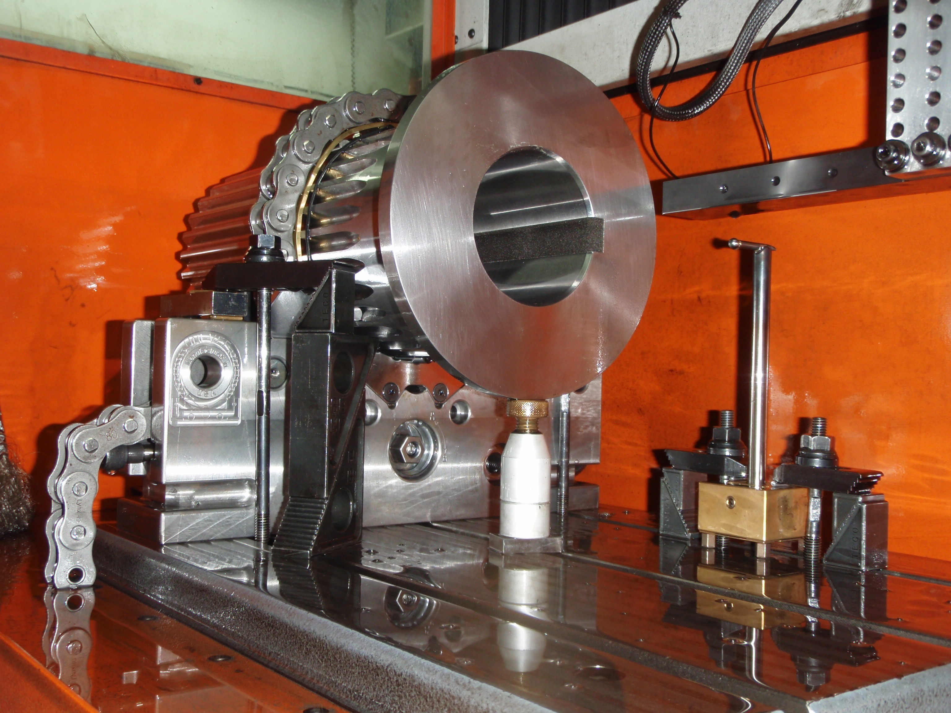

Take on unique jobs. Complete jobs your shop would never have taken before, now with confidence and ease. The Uni-Vee’s versatility makes otherwise difficult setups easy and quick.
Only worry about setting up once. Move the workpiece on and off your machine bed or to QC without having to set up again. The workpiece remains solidly engaged within the Uni-Vee.

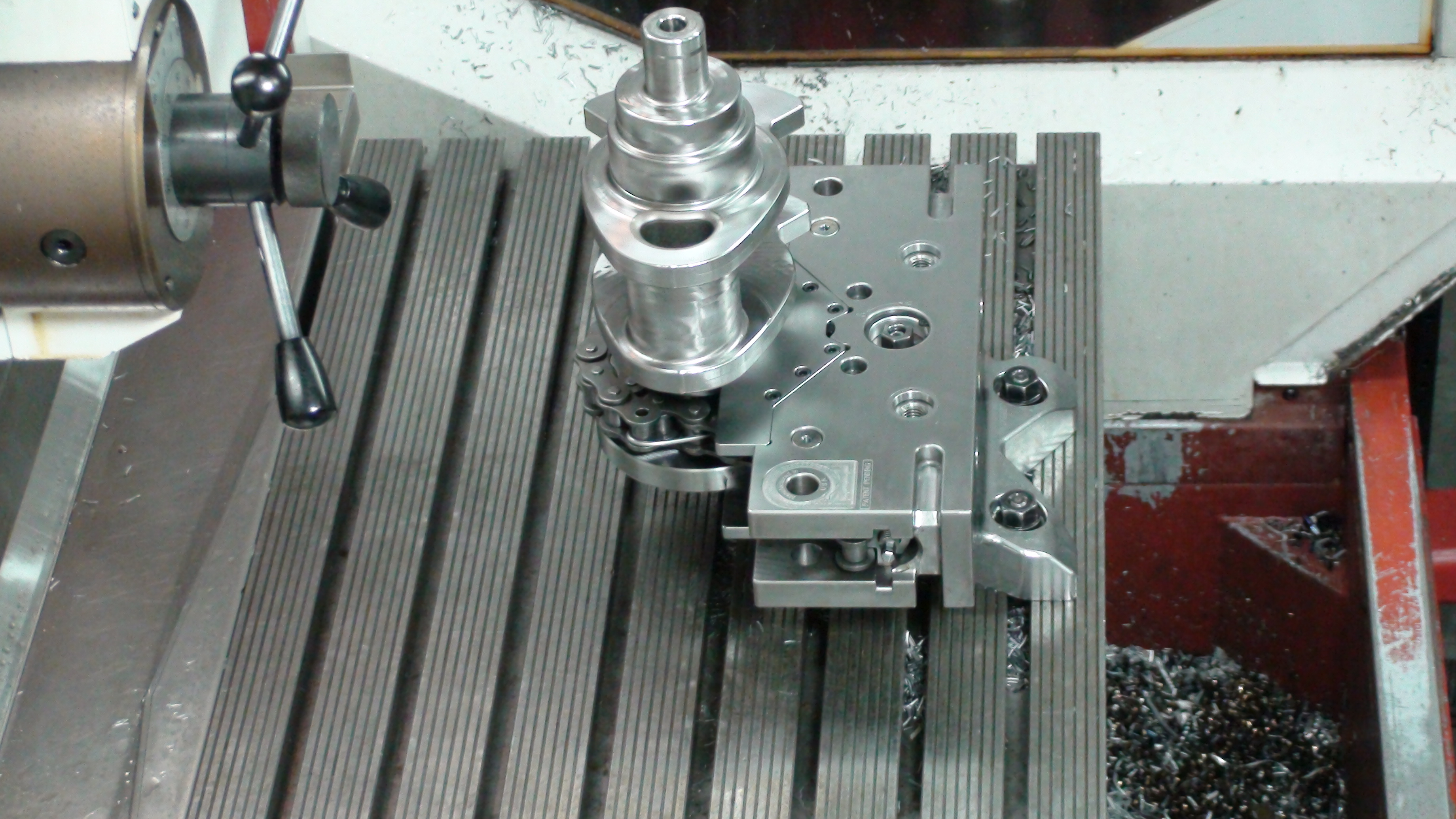

The Uni-Vee holds a prototype V12 crankshaft design for an aircraft.
Uni-Vee’s indexing feature and clamping security offers both a faster set up, and plenty of holding power for efficient cuts with precision.
