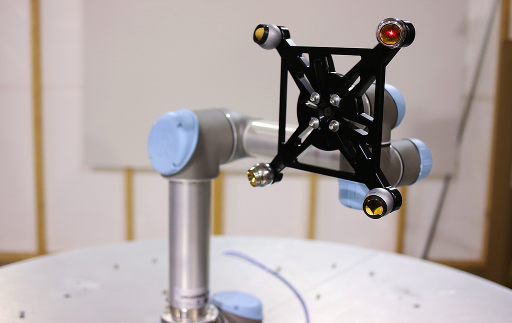

The multi-SMR robot calibration frame.
The RMS system uses a multiple SMR tracker target frame directly mounted onto the robot end effector, allowing for dynamic robot tracking. Recorded measurements are used to determine tracked robot position points revealing true robot position and orientation. RMS procedures use ISO-9283 guidelines to check accuracy, repeatability, pose, distance, drift and overshoot by exercising all robot joints. Robot working envelope can be defined applicable to the planned robot application function.

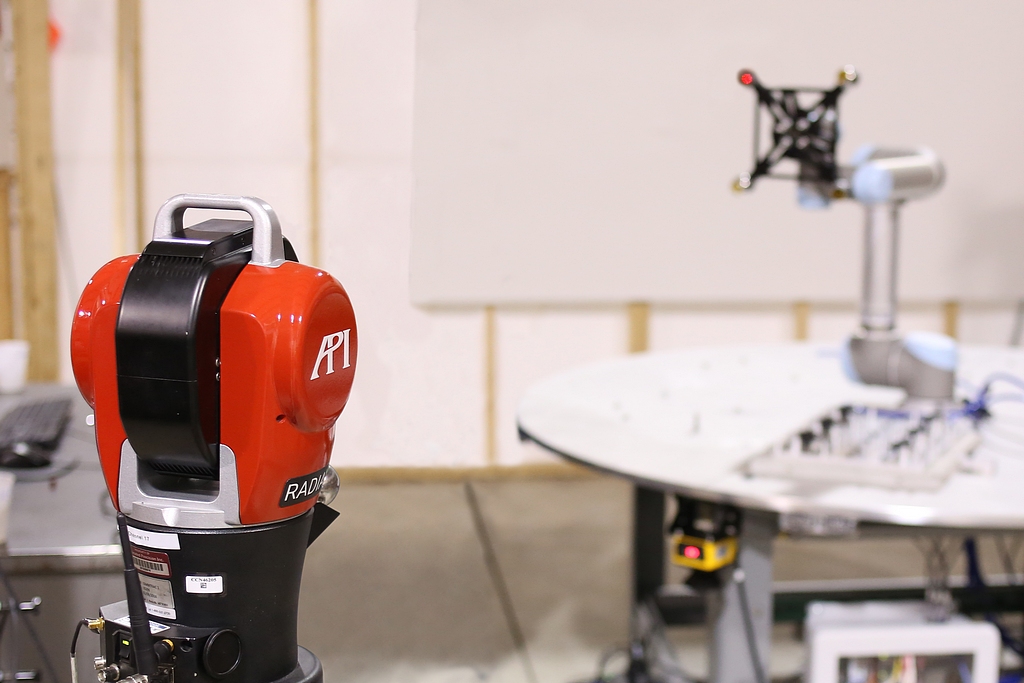

The API Radian 6DoF laser tracker performs robot calibration.
Measuring a free point cloud consisting of 80 points, the RMS software generated a new DH (Denavit-Hartenberg) frame model parameter set that was used to correct errors in joint angles and link lengths. The revised DH parameter can be directly input into the robot controller or used to update the robot motion path program as was the case at Cole Technologies, resulting in significant improvements to robot accuracy.
