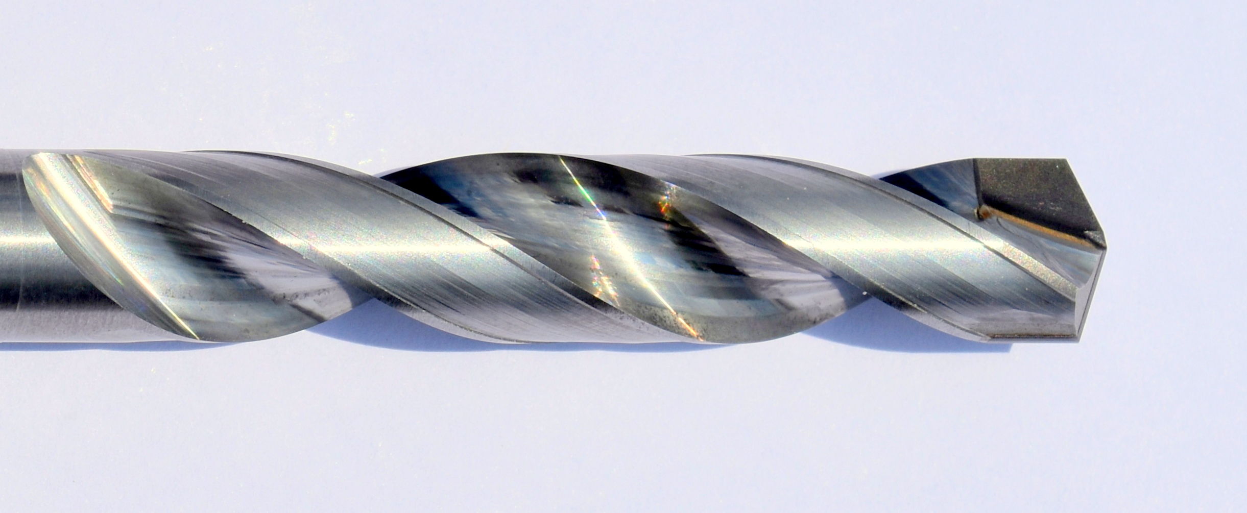

It took six years of experimentation and trial and error along with tool grinding know-how for West Ohio Tool Co., a specialty cutting tool shop in Russells Point, Ohio, to develop its own commercially available cutting tool. The revolutionary tool is a solid PCD drill that generates from 800,000 to 1,000,000 holes in die cast aluminum without regrind or re-tipping required. That durability means a lot less downtime for today’s manufacturers, and it’s why the shop guarantees this tool will provide a lower cost per hole drilled than any other tool.
Kerry Buchenroth, owner and founder of West Ohio Tool, acknowledged that using the right formulation of PCD was important – but not most important – in the drill’s development. “The real trick was not so much the material,” he said, “but instead figuring out how to braze the PCD onto the carbide, how to optimize the tool geometry and other such issues.” He credits his team and the shop’s high-precision CNC combination tool grinding/eroding technology as the key to overcoming the new drill’s development challenges.

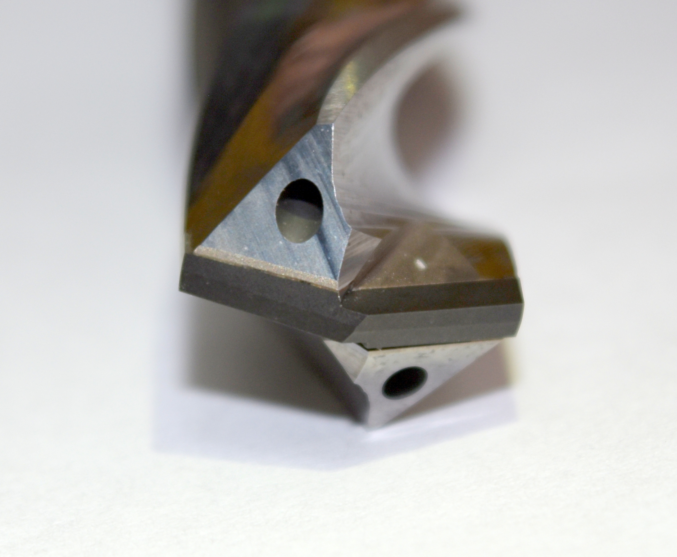

“The challenge with the outboard tip is that the outside PCD edges hold up great but the center of the chisel is still carbide, and it still eventually breaks down,” Buchenroth explained. “The goal for the new tool was to find a way to get solid PCD all the way across the center and effectively marry it to a carbide tool shank.”

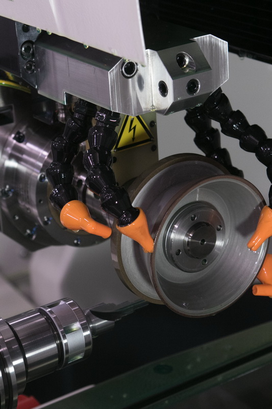

Superhard PCD is difficult to grind, and the diamond grinding wheels used to do so wear out quickly – every amount of PCD material removed from the workpiece equates to the same amount of PCD that’s worn away from the grinding wheel. This makes grinding PCD an expensive endeavor. However, because PCD contains cobalt, it conducts electricity and therefore is well-suited for EDMing.

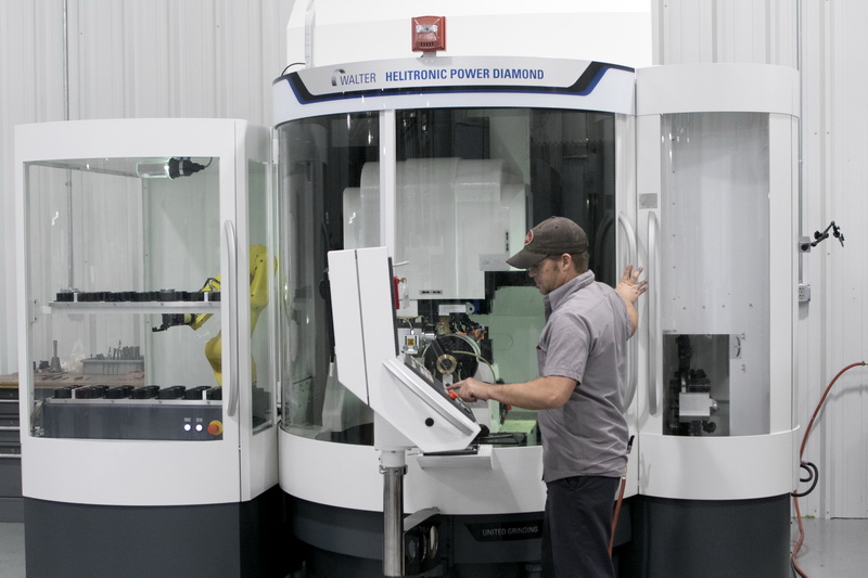

With the solid-PCD tool project in mind, West Ohio Tool invested in the Walter Helitronic Power Diamond with both grinding and EDMing capabilities. With copper rotary erosion/electrode wheels, the machine EDMs the PCD portions of tools, then conventionally grinds any carbide areas.
The fully automated Helitronic Power Diamond provides complete machining in single clamping cycles. It changes from grinding to eroding, or vice versa, on-the-fly and automatically. In addition to PCD and carbide, the machine processes tools from HSS, cermet and ceramics in diameters from 3 to 320 mm, lengths up to 350 mm and weights as heavy as 50 kg.
This was also about the time that the shop invested in its fully automated Helicheck Pro measuring machine that can handle tools with a diameter range from 1 to 150 mm in the macro area, a machining length up to 330 mm and a tool weight of up to 25 kg. The CNC-based system is well-suited for fully automatic measurement of complex tool geometries such as with the new PCD drill.

Using inferior PCD leads to a breakdown similar to what eventually happens with outboard tips on carbide – outer cutting edges would be fine, but the center eventually fails or the PCD is too brittle to hold up to aggressive machining. Buchenroth likened the phenomenon to the children’s game of crack the whip.
“In the old game of ‘crack the whip,’ the child at the center basically rotates around very, very slowly in one spot while the person at the tip of the human whip is sent flying around. PCD is great at the ‘flying around’ part, as it cuts away at material at the edge of the tool,” Buchenroth said, “but at the center of the drill, where there’s zero surface footage, it doesn’t react well to being under that kind of pressure.”
The initial formulations of PCD the shop tried eventually crumbled and broke at the drill center while the outer edges were fine. This is when the shop realized that only the highest concentration of PCD would work for the new tool, so West Ohio Tool spent a total of six years of trial and error, working with different PCD materials as well as developing a proprietary brazing process to marry the PCD to carbide and tweak the tool’s geometry.

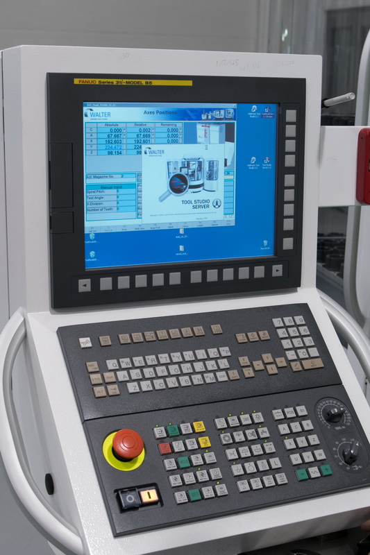

According to Buchenroth, the Tool Studio software on the Walter machines significantly helped to speed up the trial and error process. The Windows-based software, which Walter developed with input from the team at West Ohio Tool, allowed the shop to simply fill in the required information fields for the latest iteration and run the job. The software’s 3D simulation capabilities provided visualization of both the grinding and EDMing processes and allowed the shop to make adjustments as needed before any material was actually removed.
After a total of six years of continuous testing, the tool was ready. Released in 2019 and called the EdgeX4, the patent-pending PCD tool drills from 800,000 to 1,000,000 holes in die cast aluminum thanks to a significantly stronger, faster, longer and more efficient design than competing tools. Although aluminum transmission cases for the auto industry were its earliest workpieces, the EdgeX4 continues to prove a boon to the aerospace industry as well, as it is able to drill through highly abrasive carbon fiber reinforced polymer materials with minimal wear as it does with aluminum.
