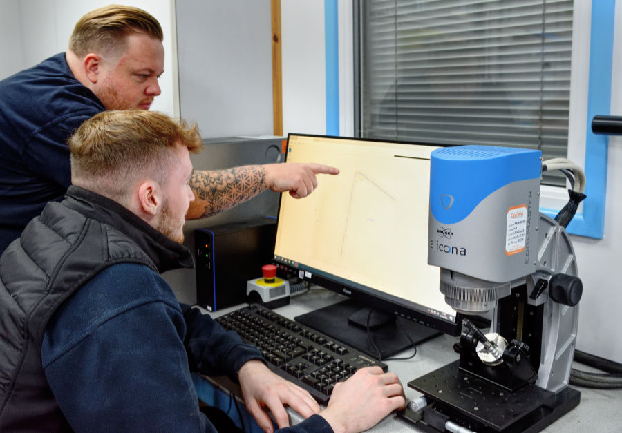

Surface finishing experts, Fintek, have in invested in a new Bruker Alicona EdgeMaster. The automatic metrology system for cutting tools is supplied and supported by Optimax Imaging Inspection & Measurement Ltd in the UK.
The efficiency and life of cutting tools are vastly improved by accurate edge preparation. Tool condition also directly affects the surface finish of a machined area and the need for additional post-processing to meet the required end product quality. Therefore, precise edge measurements are vital before and after surface finishing and edge rounding.
The high-resolution capabilities of the Alicona EdgeMaster confirm the precision of Fintek’s edge preparation services to cutting tool manufacturers and tool users. General manager, Jamie Phillips, explains, “Our previous system for measuring tool edges was straining to keep pace with high demand and current workflows. The EdgeMaster gives us faster measurement of cutting tool edges with increased accuracy. Having previously worked with Optimax, we know that the EdgeMaster comes with great support.”
“Cutting tool manufacturers go to great lengths to design and make their products effective for specific materials and workpieces. Drilling holes, for example, in composites, aluminum, steel, and hard or soft plastics all require cutting tools with different characteristics. With the EdgeMaster we can rapidly and accurately measure a tool before edge preparation. Using the data we then select the best combination of OTEC finishing machine, process media, and process parameters to achieve the target edge profile and finish. After post-processing, we quickly measure again to provide verification and traceability to customers. This is all documented in the Alicona software.” added Fintek production manager, Jason Hornby.
The EdgeMaster precisely measures edge radii >2µm as well as rake, wedge, and clearance angle for different types of tools, including waterfall and trumpet, inserts, milling cutters, and more. The accuracy of measurements is not affected by vibrations, temperature, or ambient light.
In addition to finishing services for tool manufacturers, Fintek reconditions worn tools – HSS, carbide, or coated – to the original manufacturer’s standard or even better.  They are also a UK agent for OTEC Präzisionsfinish GmbH and distribute their comprehensive range of advanced surface finishing equipment to cutting tool makers throughout the UK.
