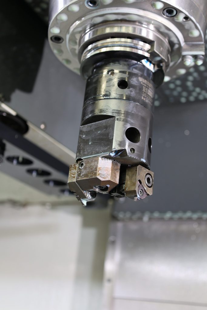

Fine boring, rough machining, large-diameter boring — no matter the type of application, it is key to get the most from boring tools. Hole-finishing applications, whether at a job shop or a high-production environment, require precision. Here are ways to get the most out of your boring tools.
Knowing what challenges might be faced and what boring tools are most suitable for the job can aid in achieving success in an application and producing components that meet specific finishing requirements.
When it comes to getting the most out of boring tools, it is important to remember that boring tools should be selected according to the unique requirements of each job. As a boring tool is adjusted to bore a specific diameter, the balance of the tool is affected, which in turn affects hole size, finish and the penetration rate of the boring tool. While low-volume jobs typically deem versatile boring tools more beneficial, high-volume jobs and those with tighter tolerances or fine finish requirements dictate dedicated tools to be used in each application.
Another important tip is to keep the tool as short as possible to reduce deflection, which can cause poor finish. Length-to-diameter ratio is extremely important to boring tools. Ideally, the length-to-diameter ratio for non-dampened boring systems is 5xD or less while heavy metal, carbide and vibration dampening technologies can allow boring of up to 10xD.
Natalie Wise, product manager of Allied Machine’s boring product lines, said that “Our Novitech modules utilize viscoelastic fluid to minimize vibration allowing bore depths up to 10xD. Not only does this vibration damping technology improve the life of your boring tools, it also extends the life of the spindle while producing an outstanding surface quality.”
With modular boring systems, it is important to consider the components selected for a job and then attempt to remove any unnecessary length. Because when it comes to boring tool solutions, the shorter and more robust, the better.
