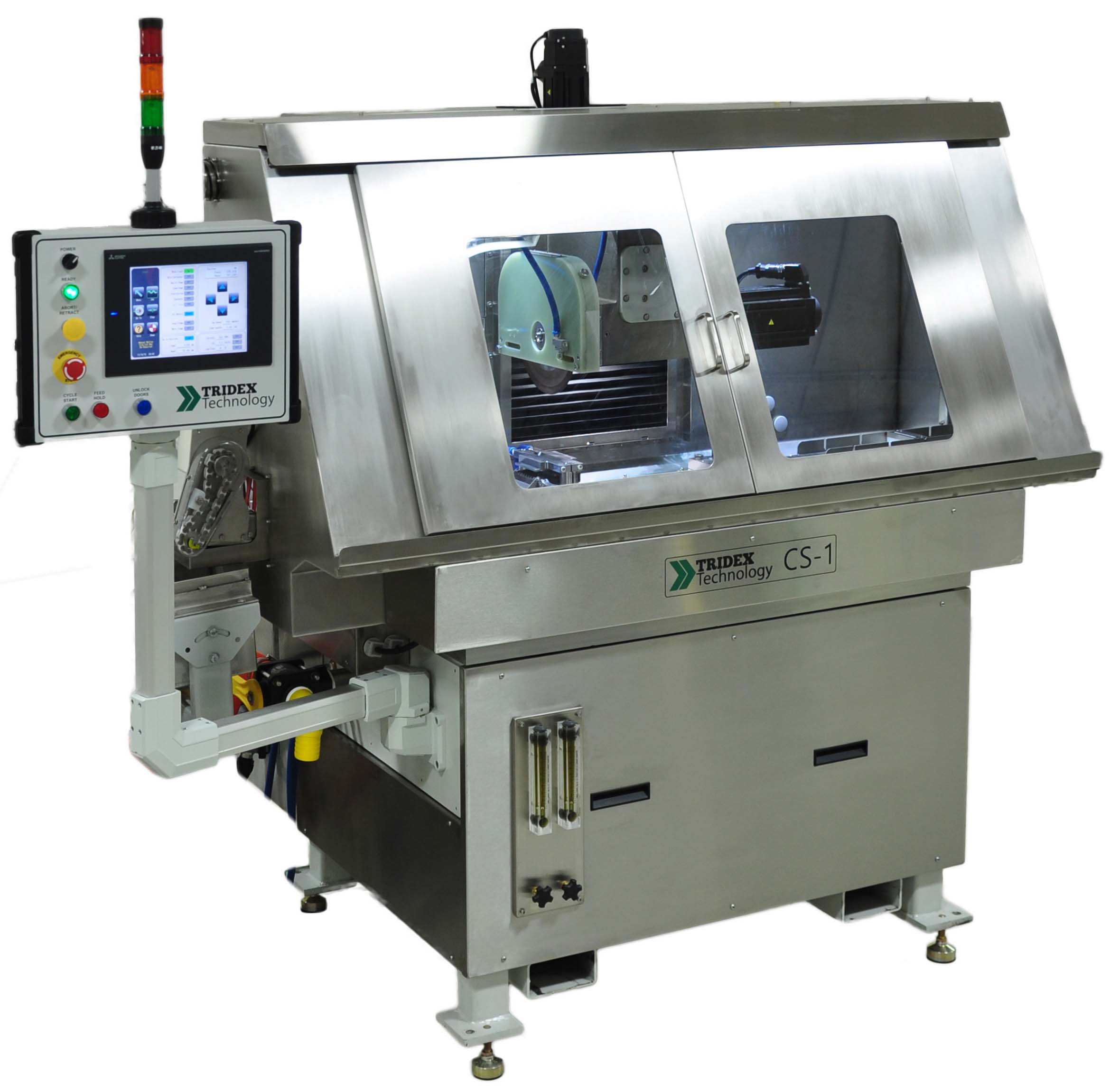

Glebar Co., a Ramsey, New Jersey-based precision grinding solutions organization, announced the acquisition of Tridex Technology Ltd. Tridex is a leader in electrochemical grinding (ECG) technology, bolstering double-digit growth since inception. Tridex specializes in the design, manufacture, application development and automation of electrochemical grinders, cut off machines and precision abrasive cut off solutions. With over 100 years of combined ECG experience and a vast array of applications in the medical and aerospace industries, to name two, Tridex provides turnkey solutions and services tailored to its customer’s needs.

Tridex Technology's ECG technology combines abrasive grinding with electrochemical machining to provide stress free, low force cutting with no burrs and no metallurgical damage such as recast, heat affected zone, burning or work hardening. ECG is widely used for tube cutoff of materials such as stainless steel hypodermic needle tubing where deburring is not practical. ECG is also used for aerospace applications such as fragile honeycomb materials and turbine airfoils where the material is thin, fragile and heat sensitive. Materials such as cobalt-chrome, Hastelloy, Inconel and Nitinol, which are very difficult to machine with conventional methods, can be easily and accurately cut with ECG. The abrasive technology is widely used in the aerospace fastener industry for cutoff of high-temperature alloys, titanium and tool steel bars.
