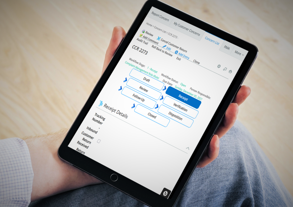

Top, gear motor quality testing at Bison. Above, the QMS that is accessible by smartphone.

Systematic quality programs like ISO 9001 and APQP represent the skeletal framework, and real-time data represent the lifeblood of outstanding quality assurance. At Bison, our implementation of web-based quality management (QMS) software has allowed us to better use data throughout our company and in our relationships with suppliers and customers, resulting in significant, measurable improvement in quality. Access to reliable, real-time data has enhanced our efforts to be proactive and preventative.
The QMS software allows us to capture and analyze data, grouped by product, feature, or process, to identify problems and to drive improvements. Rather than solving issues in isolation, we can apply lessons across customers, products and processes. Instead of firefighting — expending resources correcting problems after they have already caused a negative impact — resources can be applied far more effectively and efficiently to prevent problems and drive continuous improvement.
