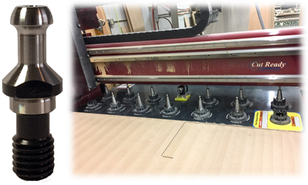

JM Performance Products Inc., Fairport Harbor, Ohio, a manufacturing innovator of CNC mill spindle optimization products since 1966, has worked to overcome this manufacturing bind with its lower-deformation High Torque Retention Knobs. An essential element of the patented design is a knob that is longer and reaches a little deeper into the holder’s threaded bore. As a result, all thread engagement occurs in a region of the toolholder where the diameter is large, and where there is more material to resist deformation.

Faced with this onslaught of toolholder obstacles, Karns, enlisted JM Performance Products to analyze their high-speed milling center production dilemma and engineer a solution. A JM Performance Products technical team performed toolholder tests with its Taper Shank Test Fixture. This conclusive test revealed that the toolholder was out of tolerance. So the team recommended a special configuration solution to optimize the fit and overcome the toolholder expansion/distortion issues.
The solution was JM Performance Products' patented High Torque retention knob that works by making the retention knob as long as possible to fit the toolholder. When properly installed with a retention knob socket and torque wrench, this patented design prevents toolholder deformation.

Key design elements of JM Performance Products' High Torque retention knobs include:
  • Longer than traditional retention knobs.
  • Precision pilot increases rigidity.
  • Relief below the flange forces threads into a deeper cross section of the toolholder.
  • Hard turned to ensure precision fit and balance for high-speed operations.
  • Same head dimensions and works in existing toolholders.
