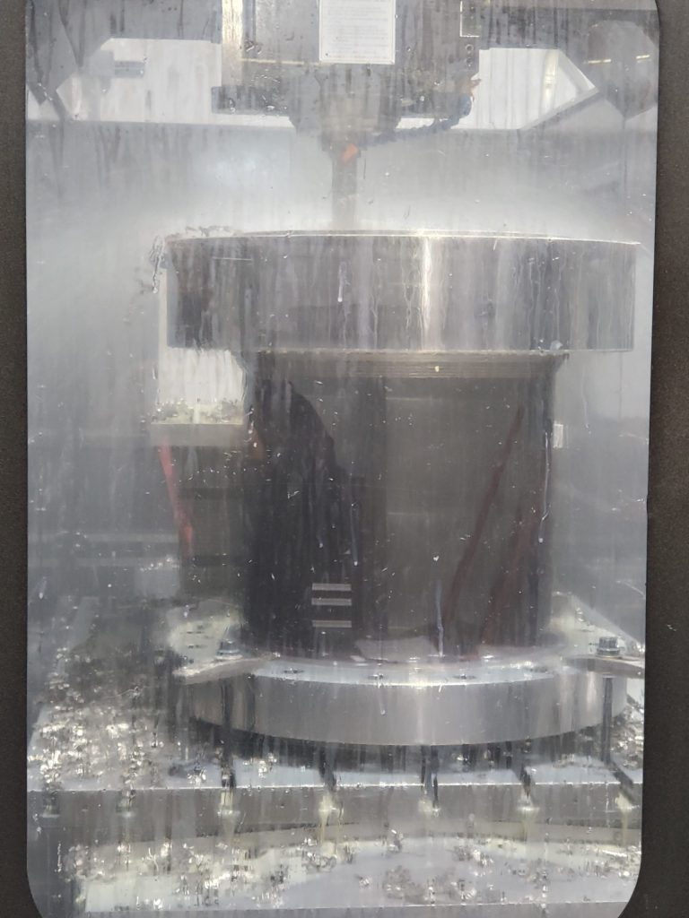

One of the greatest challenges of machining stainless steel is chip control. Alloying elements such as nickel cause stainless steel to be partially heat resistant, which results in difficulty forming a chip and, thus, poor chip evacuation. In typical steel cutting applications, heat transfers into the formed metal chip. When machining stainless, the heat resistant nickel alloys prevent this heat transfer. This leads to higher cutting temperatures and increased rates of tool deterioration when compared to common steel machining. The nature of the material and its high amount of elasticity make it difficult to achieve chip formation and induces wear on the cutting tool.
Combatting these challenges can be done a few ways—one of those being understanding machine conditions. While machine type does play a factor, machine condition is more detrimental. Machinists must ask if the spindle is rigid, and if the alignment is reasonable or at near zero runout on a lathe. Knowing these factors can greatly benefit or cause significant issues when trying to machine stainless steel.
Additionally, running through-the-tool coolant provides significant tool life advantages over flood coolant. Ultimately, due to its alloying elements, more torque and horsepower are required to drill stainless than typical steel or aluminum materials.
These challenges in stainless applications can also be resolved by working with a more aggressive geometry to attempt to get the chip to form. In austenitic stainless like 316, it is best to use a geometry with a higher rake angle to produce a more manageable chip. However, when working with a harder material such as PH stainless, this method is not effective. In this instance, increasing the rake angle causes the cutting edge to weaken—in turn reducing tool life. With harder materials, this makes the negatives often outweigh the positives.
