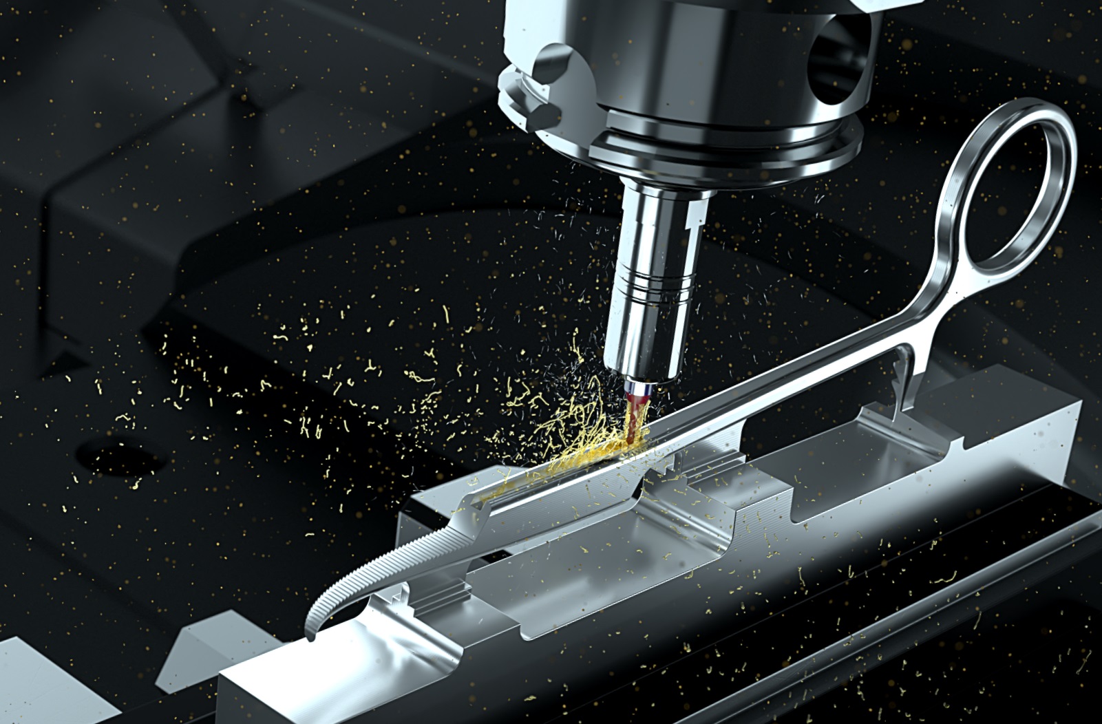

Mikron Tool opted for a dynamic process with milling from a solid blank. A highly dynamic 5-axis machining center DMP 70 from DMG MORI was selected for the machine. By combining several machining processes, the workpiece can be almost completely machined in just one clamping with standardized milling cutters from Mikron Tool.

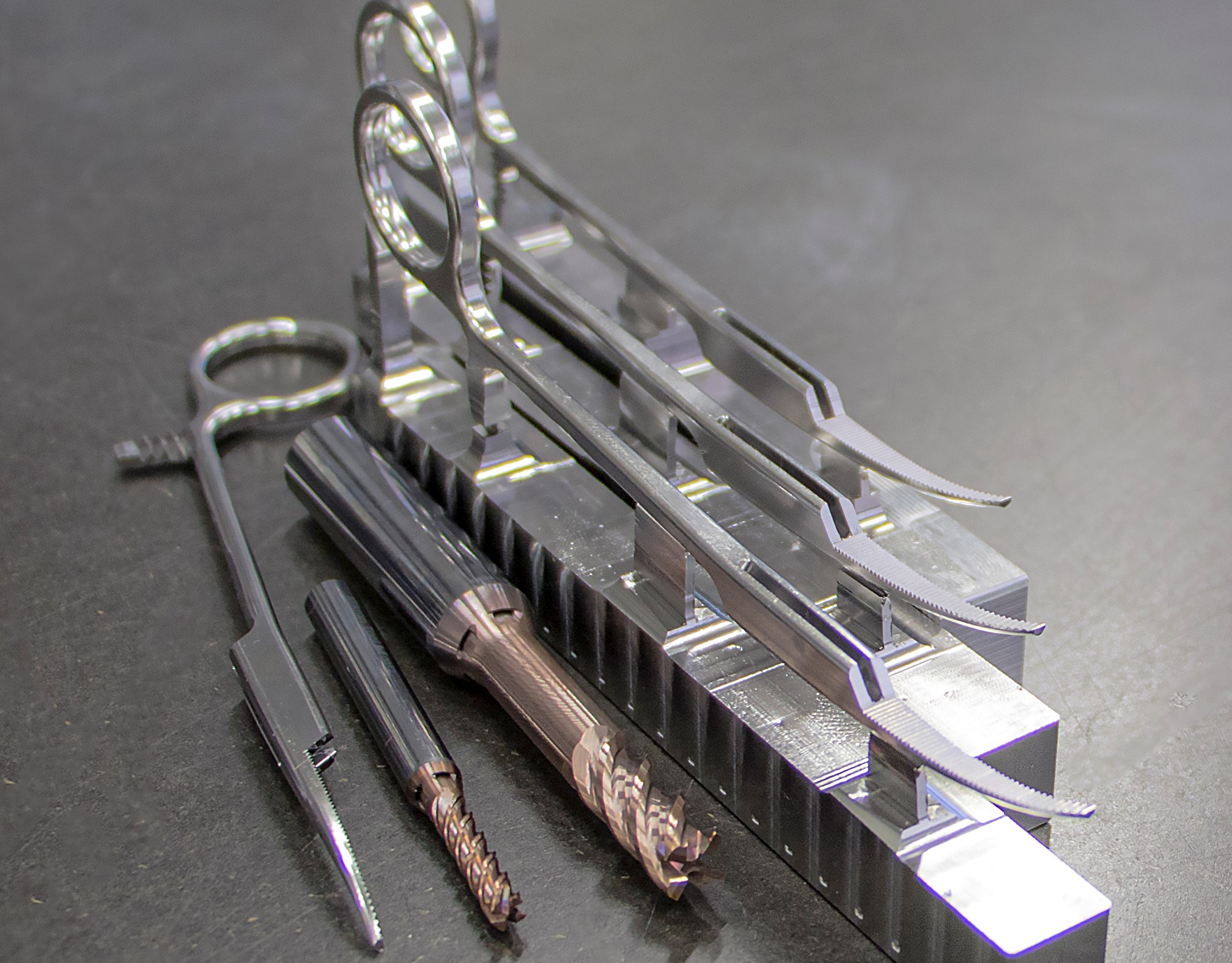

The almost perfectly machined hemostatic clamp with a minimum number of support bars.

Clamping is tricky when milling from a solid blank. It is crucial to ensure all-around, unrestricted access to the workpiece without any obstructions so that the tools are clamped as reduced as possible. Because of the zero-point clamping system was chosen by Mikron Tool, the workpiece, fixtures, and clamping devices can be positioned, fixed and clamped quickly and precisely in one operation. This drastically reduces set-up times.
This is a decisive factor for optimizing process chain cost savings. To minimise the use of material, the blank was fixed at a clamping height of only 3mm. But care is required: this determines the entire milling strategy, as the lateral forces must be kept to a minimum.

The machine is dynamic, as is the milling strategy. All in all, Mikron Tool uses 10 tools to machine a hemostat, all specially designed for machining stainless steel: a plunge cutter, various 4-tooth roughing and finishing cutters, a deburring cutter and two dovetail cutters.
The R&D Manager Gotti, Ph.D. highlights a few details of the milling strategy: “Due to zero-point clamping and completion in just one clamping, our main concern was to avoid high forces. Our professionals went for a dynamic strategy: high cutting speeds (up to 220 m/min when roughing), high feed rates fz (up to 0.15 mm) and a high axial (ap) but low radial in-feed (ae).
To achieve high feed rates when roughing, 4-tooth milling cutters were used. When milling out the eye of the handle, spiral interpolation proved to be time-saving. To achieve the fine corrugations on the tip, a dovetail cutter was used, which resulted in rapid processing thanks to its special shape.
The elongated groove on the inner contour was made using a 3-tooth plunge cutter. This produced a small, but sharp edge during milling, which proved to be particularly problematic. However, the workpiece could be deburred without having to change clamping position, with the use of a spherical deburring cutter (CrazyMill Radiuschamfer or CrazyMill chamfer).
The teeth of the locking mechanism were cut in one of the last steps using another special tool. The last step consisted of separating the workpiece from the raw blank and reducing the number of supports to a minimum. It was obvious that post-processing needed to be limited as well, to keep costs down.
