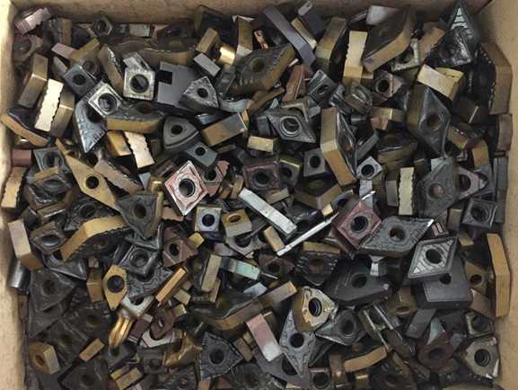

The most fundamental elements of any metalcutting process, cutting tools are by their nature consumable. They wear until they are no longer effective. A traditional approach to metalcutting tool management employs wear analysis alone, focused on manipulating tool materials, geometries and application parameters to improve part output and tool life in a selected operation. To maximize the efficiency of your facility’s entire manufacturing process – boosting part-processing productivity and impacting the bottom line – you must go further in the pursuit of optimization.
Photo courtesy of Seco Tools
This means you must go beyond the basic measurement of tool wear to include other significant tooling-related considerations. These include the time spent in tool manipulation, problems/issues other than wear, production economics, shop organization, personnel attitudes and assumptions, value stream management and total manufacturing costs. The key performance metrics remain the same – achieving cost and time efficiency given a certain minimum quality and level of yield – but the scope has grown to encompass every aspect of a shop’s workflow to realize the highest possible benefit.

Tooling OEM Seco recommends that shops also pair this kind of on-the-fly problem solving and comprehensive analysis with an equally rigorous process for determining how tools are wearing. A machinist examines the cutting edges of a large number of randomly chosen tools from throughout a shop, one edge at a time, then classifies the wear patterns according to type and amount. When combined with the other data, this type of analysis results in a complete overview of the factors that must be optimized to obtain the most cost-efficient process.
Regardless of the process, the most important part of any given machining application is what happens when the tool contacts the metal and what occurs during the in-cut time. And while tool wear is inevitable and its management is essential to achieving successful machining operations, it is only one of the many influences on the efficiency of a shop’s overall manufacturing process. By going beyond wear analysis of single tools to looking at a random sample of edges in the context of the entire manufacturing process, shops can achieve new levels of productivity and profitability.
