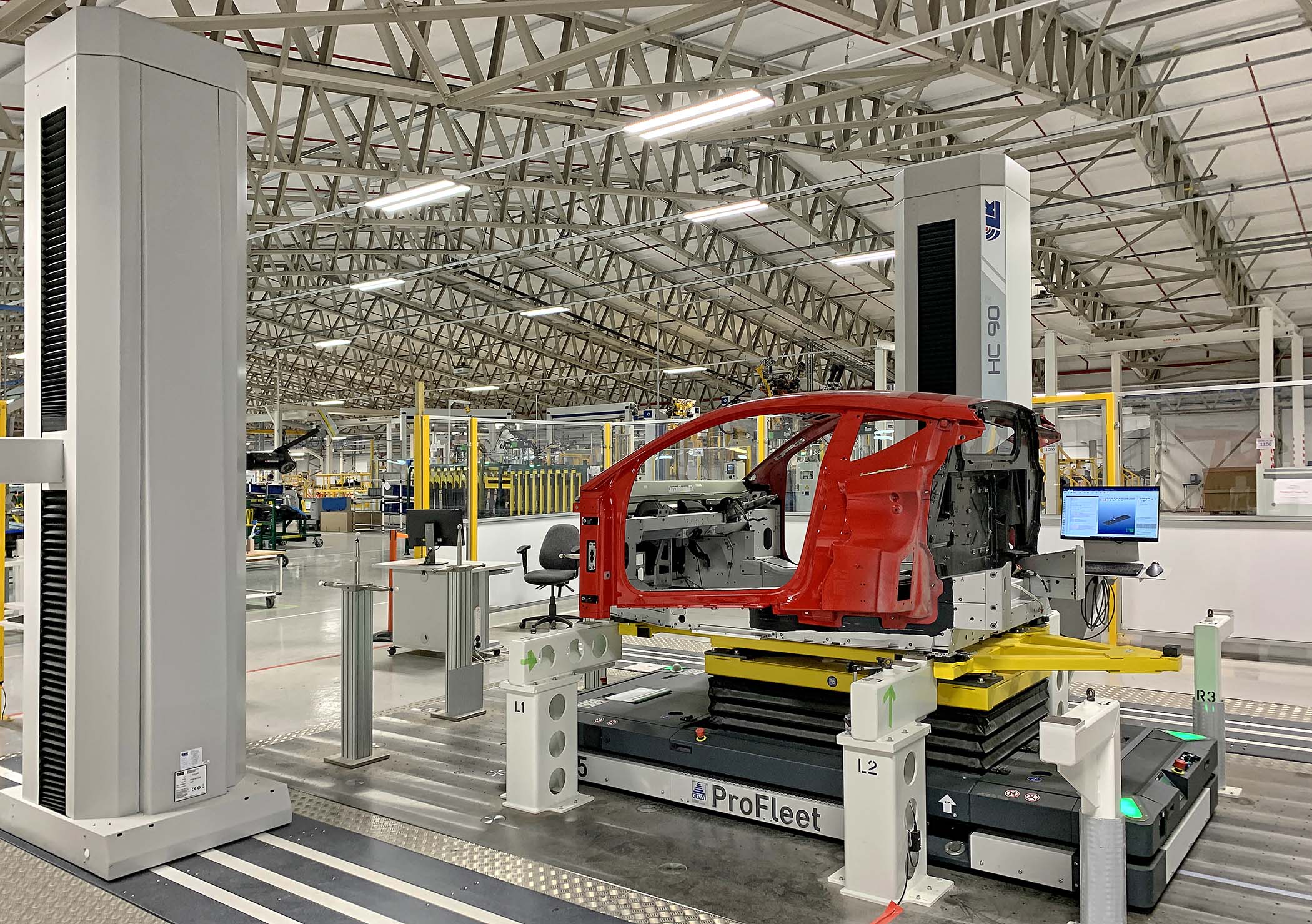

The automated, multi-sensor inspection cell, part of multi-million dollar investments made by Lotus since 2017, delivers absolute, 100 percent, non-contact dimensional inspection at production-line speed, enabling real-time quality control.

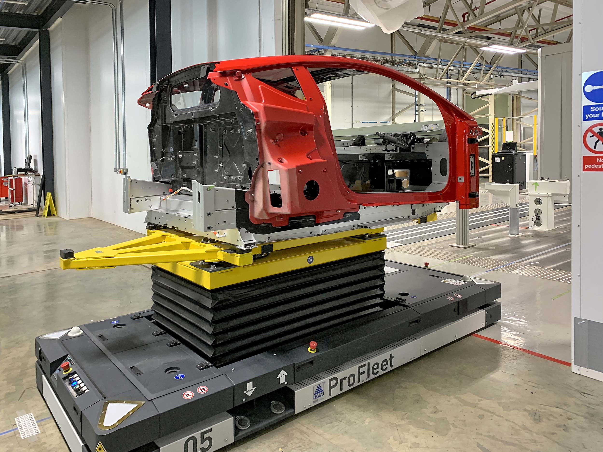

The CMM installed in Hethel is set one meter into the floor on a special foundation. It means that a car for the inspection carried on an automated guided vehicle (AGV) can access the area without the need for any lifting equipment.
Advanced, triple-laser cross scanners are deployed on both arms to measure features automatically on both sides of the Lotus Emira simultaneously. Notably, the LK HC-90 is the world's most accurate range of horizontal-arm CMMs, able to measure to a volumetric accuracy of 10.0 μm + L/200 and with 6 μm repeatability. The machine combines the high performance of a bridge-type CMM with the flexibility of the horizontal-arm configuration widely used in car plants.
The Emira chassis, which remains on the AGV, is lowered into position and aligned ready for inspection by laser scanning.
The CMM completes automated measuring cycles so quickly that it can keep up with the quick TAKT time that defines the speed of the Emira production line. The fast throughput enables every car to be inspected, making this Lotus model the first whose manufacture is supported by such comprehensive QC.
On two occasions, at different stages of the car's build, the LK HC-90TR captured a total of 130 measurements in scanning routines that took about 12 minutes and 8 minutes respectively. The rapid inspection cycles leave plenty of time for an AGV that has delivered a chassis to the CMM to load it and subsequently return it to the line.

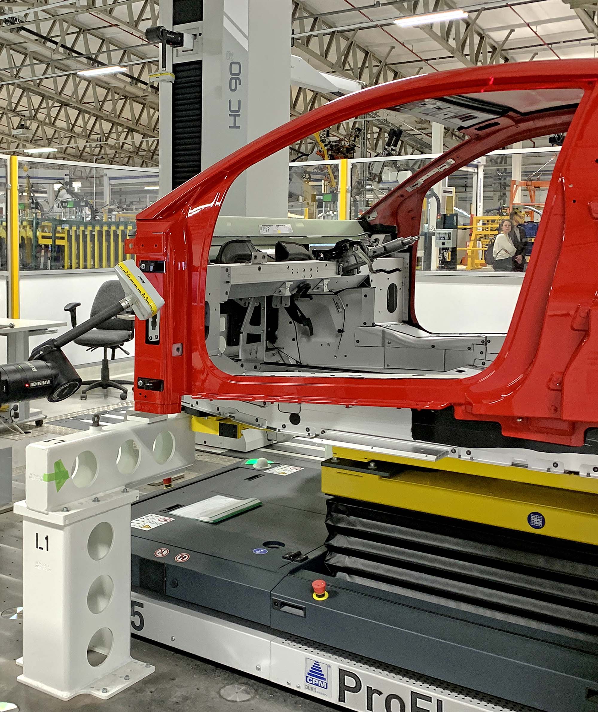

Laser scanners' infinite positioning
The Renishaw PHS-2 two-axis CNC wrists that carry the laser scanners can rotate continuously and have infinite positioning, unlike conventional probe heads that only adjust in 7.5-degree steps.
Each scanner can therefore be precisely angled throughout an inspection cycle, allowing optimal positioning both inside and outside the chassis for rapid acquisition of freeform and geometrical data.
When inside the vehicle, the PHS-2 can rotate under program control to look outwards at the interior of the bodywork to take measurements. The DMIS programs controlling each arm are essentially mirror images, with additional movements inserted separately to address the minor differences unique to each side of the car.
The Nikon XC65DX-LS cross scanner with three laser lines captures in a single orientation and scan pass three times the amount of data that can be acquired by a single-line laser scanner.
It enables short inspection cycles on the LK HC-90TR to support 100 percent QC of the Emira. The built-in technology means that the sensor is unaffected by the color or reflectivity of what is being measured. It also provides automatic, real-time adjustment of the settings not only between successive laser stripes, but also for individual points along each line. The LS variant of the scanner signifies that it has a longer stand-off distance, up to 170 mm, allowing it to access difficult-to-reach features.
