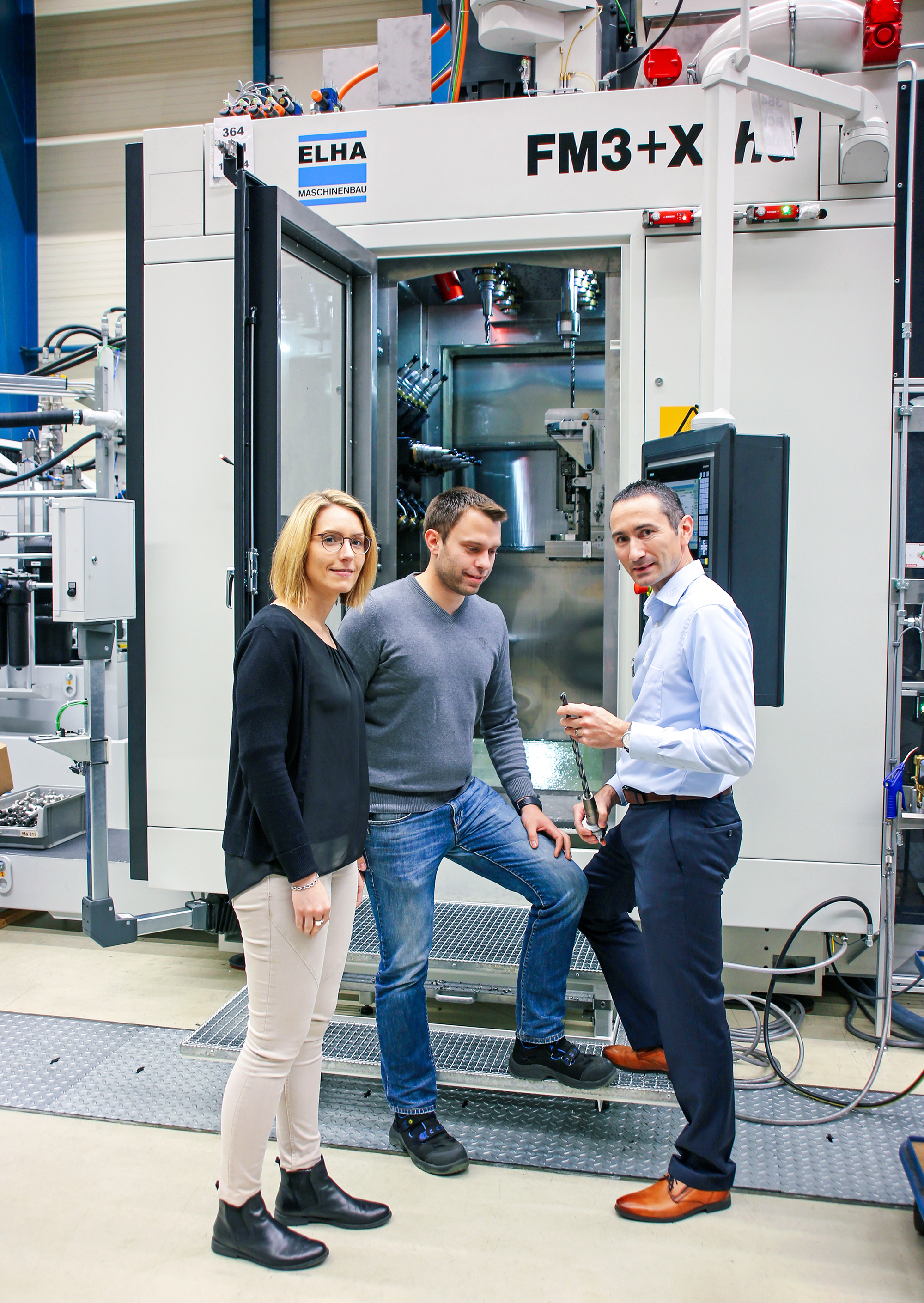

Carina Becker, Jörg Rodehutskors and Alexander Wiesner in front of an FM3+X hd production module.The larger the series of parts to be produced, the more important cycle times and tool costs are. With large quantities, such as those for the automotive industry, the machine tool and the tooling need to be optimally suited to each other, and the manufacturing process.
