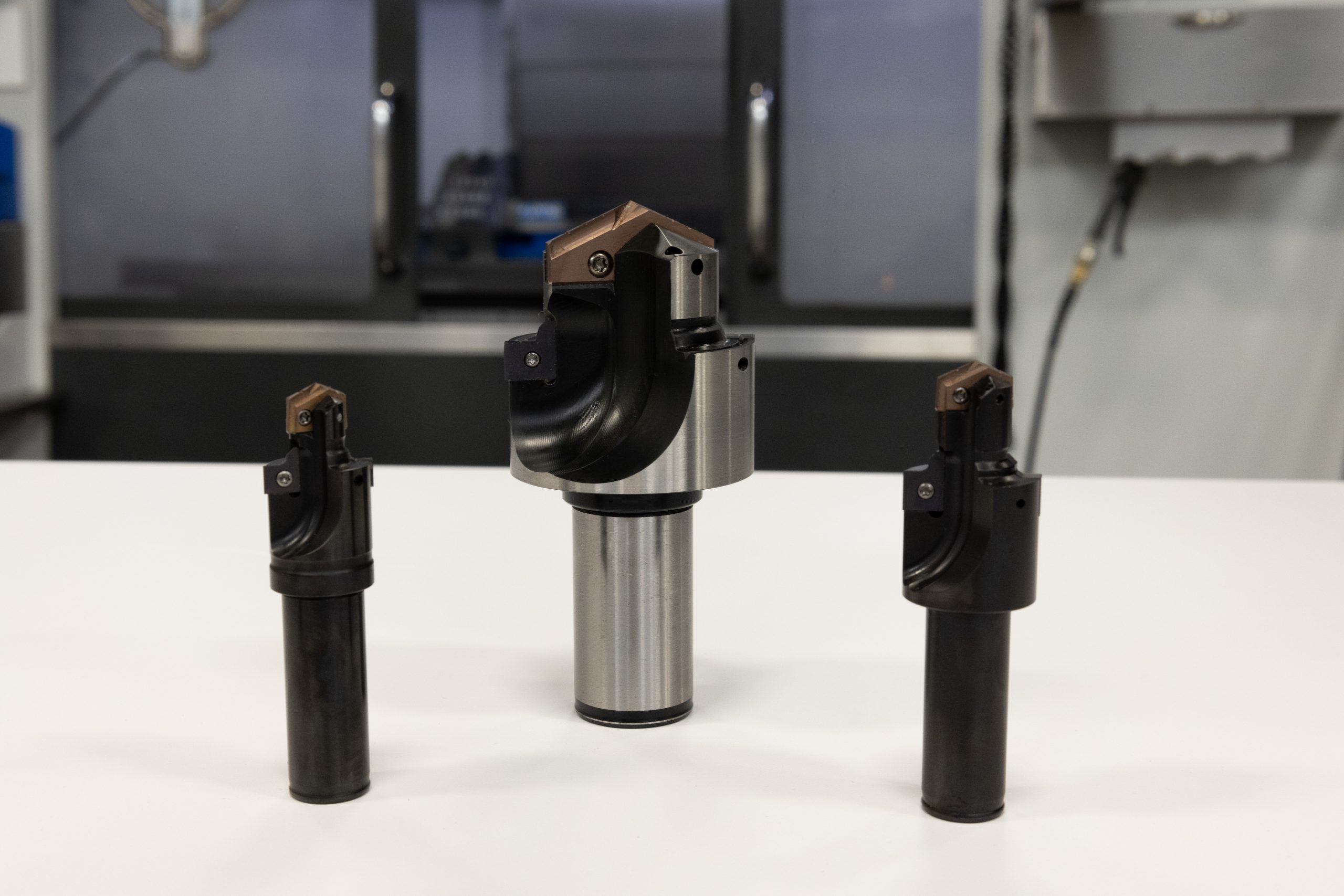

Four-in-one indexable tooling solutions showcase the drilling technology that proves successful when drilling hydraulic ports.

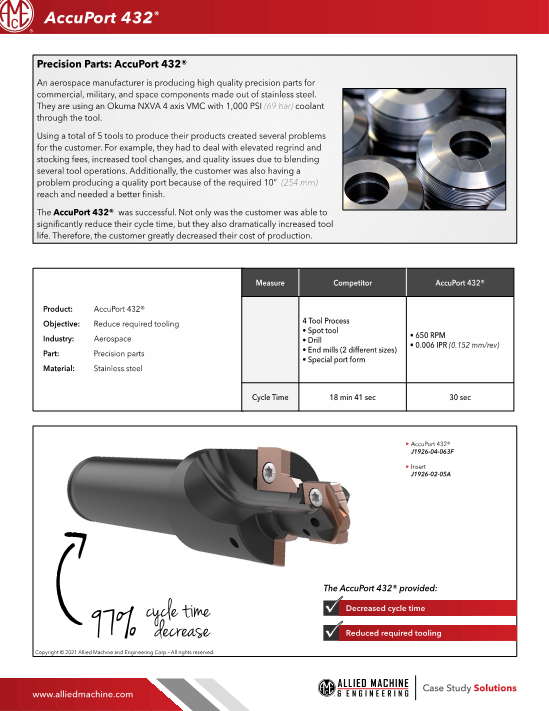

Indexable porting tools offer a solution. One example of an indexable tool is the AccuPort 432, which performs multiple operations in a single step while allowing you to simply swap out worn inserts and return to production.
Indexable tools like this provide excellent repeatability and surface finish while eliminating lost production time due to pre-drilling setups and regrinding.
With four-in-one tools, not only do you get the tap drill size required, seal angle diameter, form, and spot face, but you can also drill from solid.

The products in Allied Machine’s AccuPort 432 product line are designed to deliver maximum performance in a diverse range of hydraulic port cutting applications and numerous industries. Indexable tooling such as this can provide a more cost-effective and higher-performance solution anywhere a hydraulic port is required in a fraction of the time taken for traditional methods using separate drills, special forming tools, and spot facers. These innovative designs deliver the best possible range of benefits in terms of productivity, cost per hole, and tool life.
