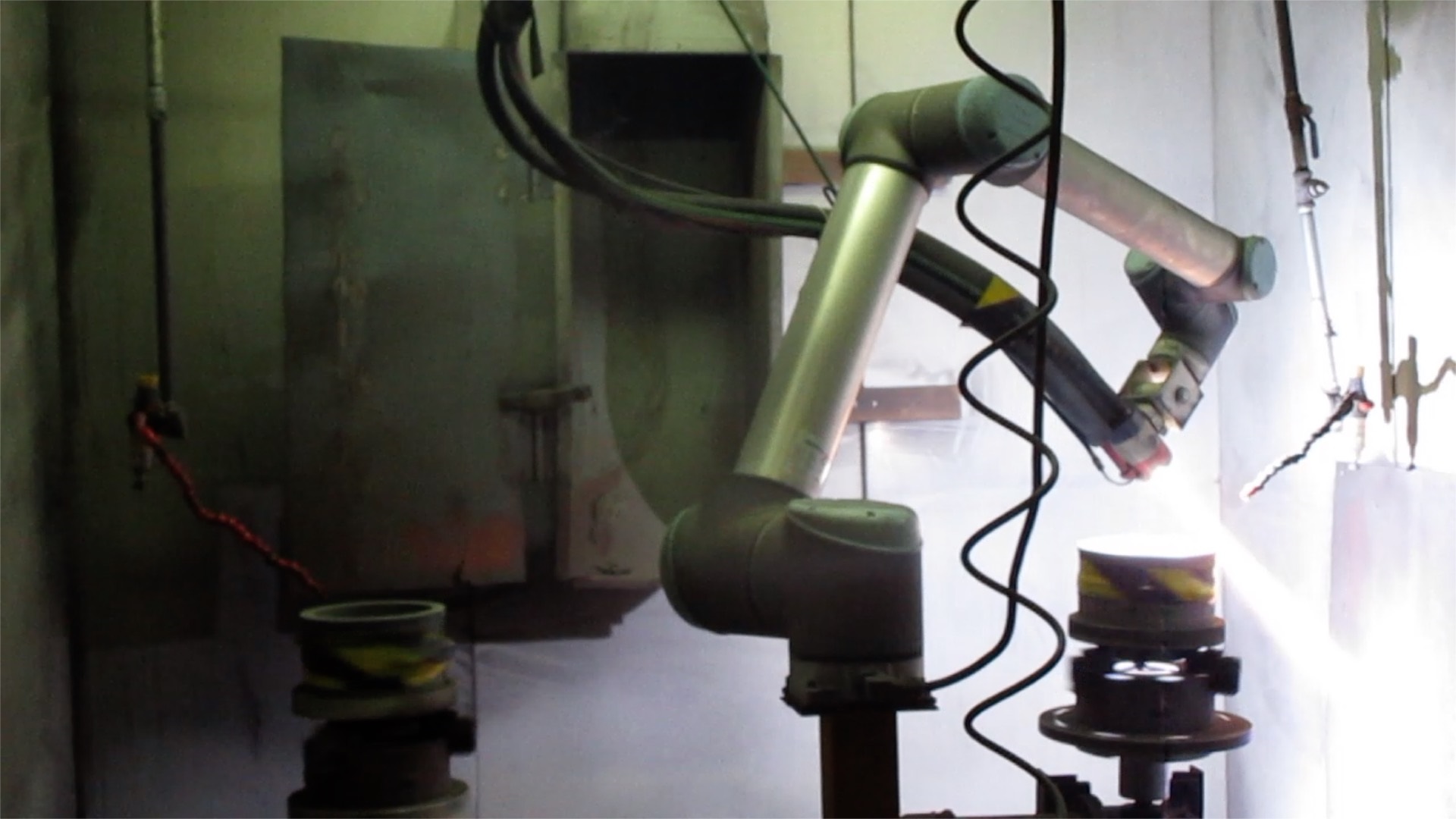

Aircraft Tooling Inc., a Dallas-based repair center for the aviation industry, was surprised to find that Universal Robots could withstand the high temperatures and harsh environment while performing metal powder and plasma spray processes. The UR “cobots” have been in operation for 3 years without breakdown or service requirements.

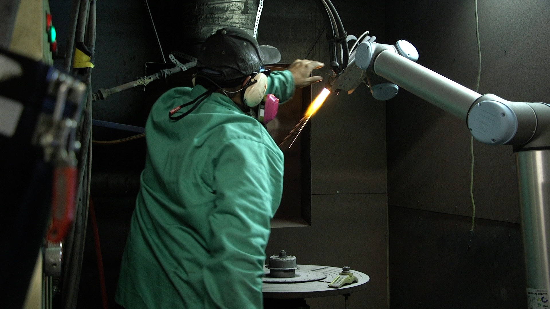

Juan Puente, thermal spray supervisor at Aircraft Tooling Inc., turns the HVOF flame on and then leaves the booth as the UR10 robot performs the spray process. Photos courtesy of Universal Robots

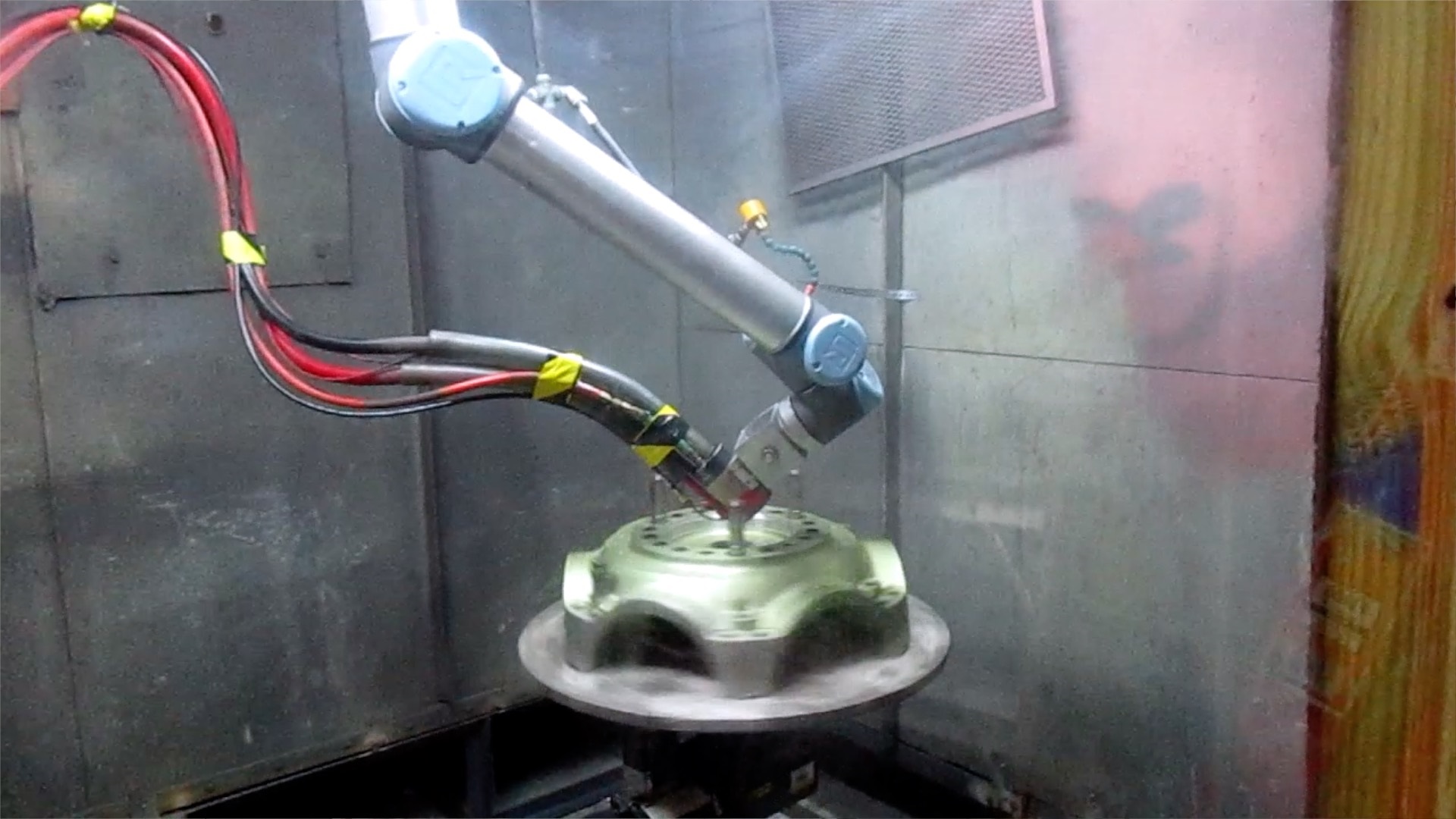

High-velocity oxygen fuel coating is a thermal spray coating process used to improve or restore a component’s surface properties or dimensions, extending equipment life by significantly increasing erosion and wear resistance. The spraying of parts usually takes 3 to 4 hours, with spraying in 1- to 2-minute intervals followed by a 2-minute cool down period with cold air provided by a pneumatic cooler (the blue pipe on the left).

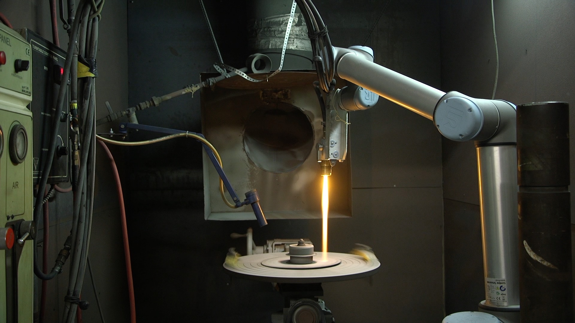

ATI’s second UR10 robot handles the plasma spray which is a hotter flame delivering a denser coating.

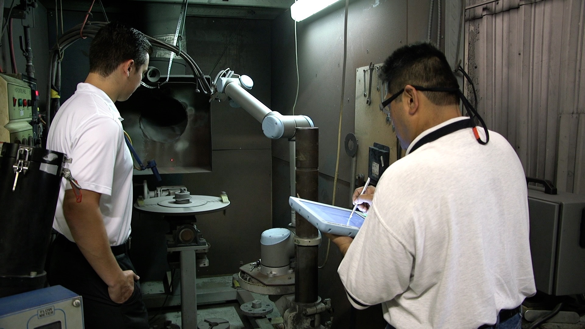

Nick Armenta (left), automation engineer with UR robot distributor Olympus Controls, and Juan Puente, thermal spray supervisor at ATI, discuss the HVOF spray process. The spray cell is an open booth that allows suction flow through the work cell to keep the robot cool.
