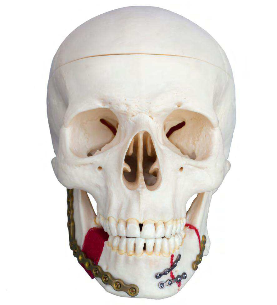

One example is the production of bone compression plates for osteosynthesis in jaw surgery. For these types of implants, the material most often used by surgeons, orthopedic technicians and dentists are specially alloyed surgical steels or highly bio-compatible titanium alloys. But, these materials are difficult to machine cost-effectively and in-line with the relevant directives such as high elasticity and low-thermal conductivity.

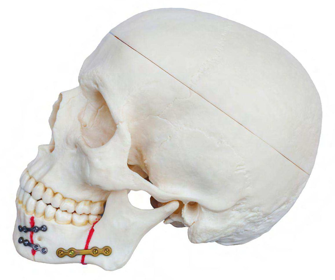

Bone compression plates used in jaw surgery are titanium implants and they are available in different thicknesses and designs. Due to the stringent requirements imposed on the material, application-optimized tools are absolutely essential for machining. The tendency toward sudden strain hardening, for example, can instantly increase the friction on the cutting edge, causing the tool to become blunt. The combination of carefully selected, ultra-fine-grain carbide, the perfect geometry and chip control, prepared cutting edges and high-performance coatings is the key to commercial success and consistently high quality.

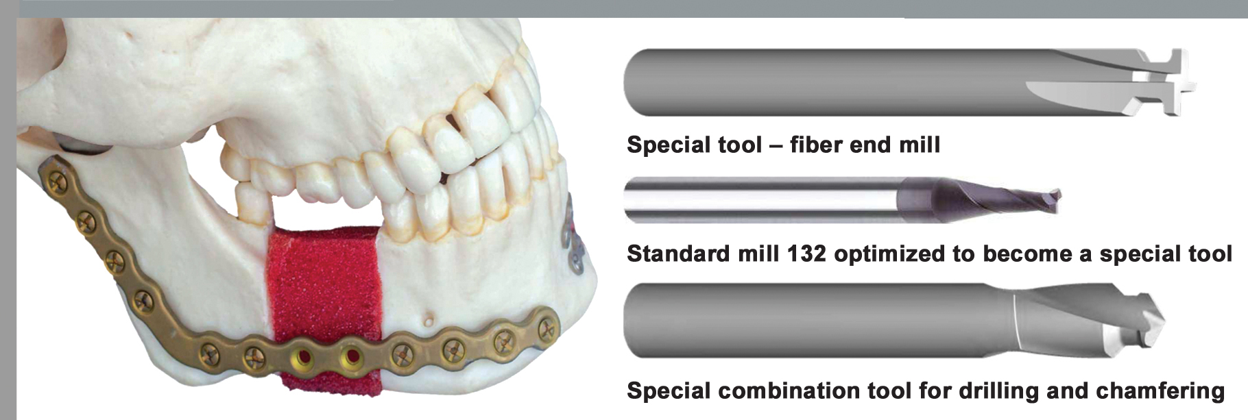

SC standard fiber end mill 132
The SC tool’s geometry offers a high machining rate during the milling of titanium alloys. Taking the jaw plate as an example, the challenge was to increase throughput without compromising process reliability. The tool was optimized with special surface treatment, edge preparation and internal cooling. The resulting special mill 998049223_HB100100326 makes the milling process 40 percent faster with Vc = 70 m/min; F = 700 mm/min.

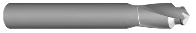

With a second special fiber end mill (998051524_HB100100455), the upper and lower outer edges of the jaw plate are chamfered simultaneously (Vc = 60 m/min; F = 225 mm/min), reducing the machining time by 50 percent. With a Inovatools combination tool for drilling and chamfering (998044881_HB100100166), implant manufacturers can achieve time savings of more than 60 percent compared with conventional production using two tools.
