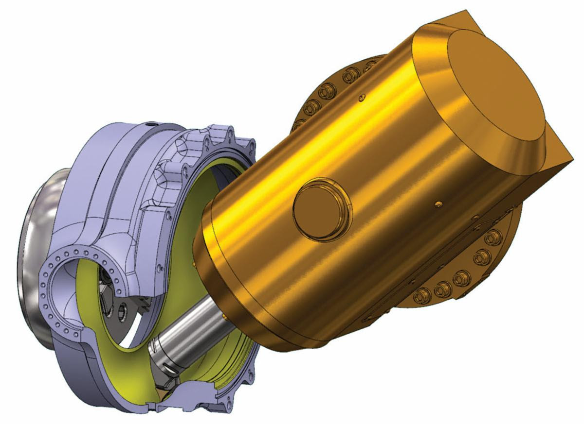

The newest version was released after receiving valuable feedback by manufacturers from all over the world during a Public Beta Program. Many of the improvements in Mastercam 2023 are directly driven by Mastercam users and shops. Feedback from Public Beta releases, shop visits, customer surveys, and consultation with our expert industry partners create the practical, shop-driven focus that helps ensure Mastercam users’ success.
Consolidating Multiaxis Toolpaths. Morph, Parallel, Along Curve, and Project Curve are no longer individual toolpaths in Mastercam 2023. Instead, the Unified toolpath allows access to these cut patterns when the appropriate curves are added. For example, to create a toolpath that morphs between two surfaces, select Unified from the Multiaxis toolpaths, and then set the Cut Pattern to two surfaces with the Morph style.
Detecting Undercut Stock When Machining. The Dynamic OptiRough and Area Roughing toolpaths can now be aware of undercut stock conditions, resulting in improvement to the toolpath motion, including less air cutting.
New B-Axis Contour Turning Toolpath. Mastercam 2023 introduces a new toolpath to the Turning suite for the Mill-Turn product. B-Axis Contour Turning is a finishing toolpath that allows for rotation of the B-axis while the tool is cutting. The toolpath features a top-down workflow and provides either Automatic or Manual motion control. Automatic mode produces safe toolpath motion that keeps the insert in contact with the contour. Manual mode offers full control over the B-axis angles along the contour.
