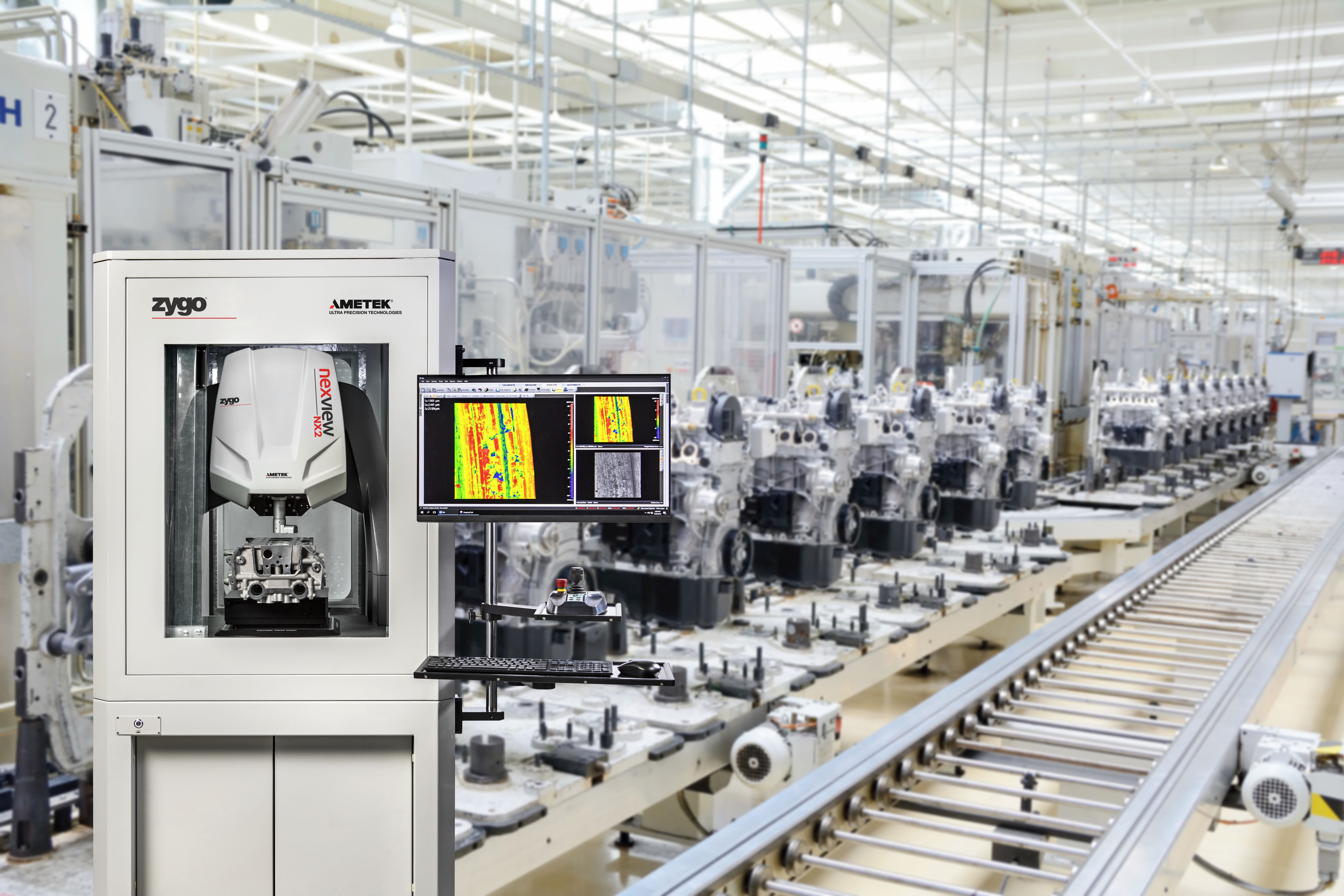

Metrology’s role in highly digitized factories that continuously collect and share data through inter-connected devices, machines, and production processes is to support digital production at every stage. To achieve the objectives of the “smart factory,” manufacturers must evolve their processes to close gaps in inspection-related data at every stage in the production value map. It also has a role in giving manufacturers greater visibility of the entire supply chain, including suppliers. Smart factories bristling with industrial robots and automated handling systems rely disproportionately on fully automated control systems and speedy verification and feedback.
This plays to the use of in-process metrology solutions and non-contact 3D optical solutions.
Typically, the conversation when looking at the optimum use of metrology in advanced manufacturing settings today is between its use in the lab or in-process. Ultimately, a key driver for the shift from in-lab to in-process is a desire for a “faster time to data,” and more importantly, the ability to make decisions as a result of that data faster. Hence, it is a key element of Industry 4.0 and the efficient running of a smart factory.
When compared to alternative legacy metrology solutions where measurement is a separate off-line activity, in-process solutions have a number of key advantages, the most obvious being the speed with which the data derived from it can influence decision making. If carrying out metrology in-lab, parts must be moved to the QC department, and then they need to be set-up for the metrology operation to be undertaken. If the metrology is in-line, various process steps are removed, and as defects and problems are identified and rectified instantaneously then reworking is reduced. In-process metrology therefore assists in preventing problems before they arise, and if they do arise allows them to be identified and addressed before they become a costly and time-consuming issue.
Non-contact optical metrology solutions also fit within the concept of Industry 4.0 as they are speedier and can cover larger areas than contact devices. Fully integrated 3D optical metrology promotes fully automated closed-loop production. In addition, improvements in computer processing and optical technology mean that the sheer amount of data that can be acquired and analysed is vastly increased. 3D optical metrology solutions used in-process allow for processed data to be to be fed from the metrology system into the factory management system and this advances the concept of the smart factory.
