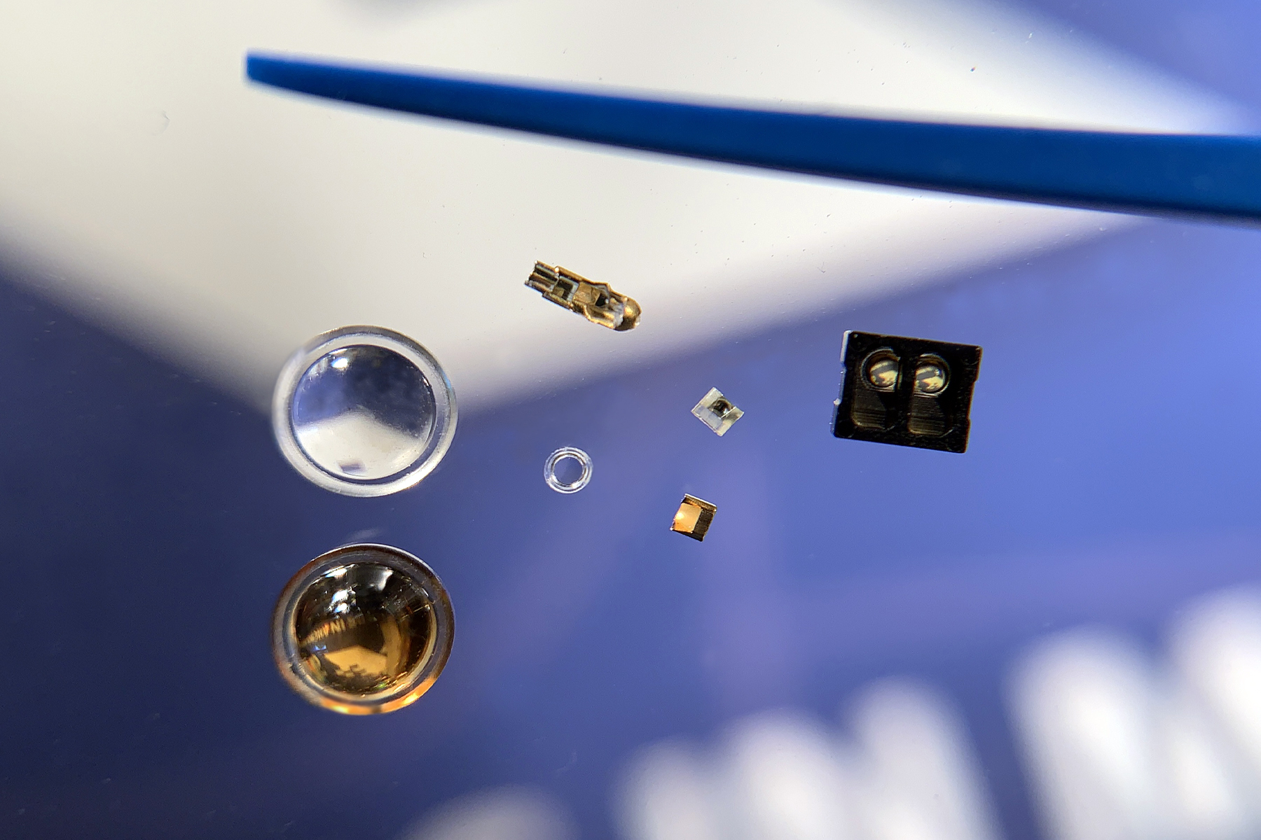

Micro lensesManufacturers not used to such exacting tolerances may think it impossible to mass-produce parts with such minuscule dimensions and levels of accuracy, yet micro molders do this every day. It's especially challenging when dealing with parts as light as 0.001 grams that are needed for safety-critical applications, where zero failure rates must be observed.
