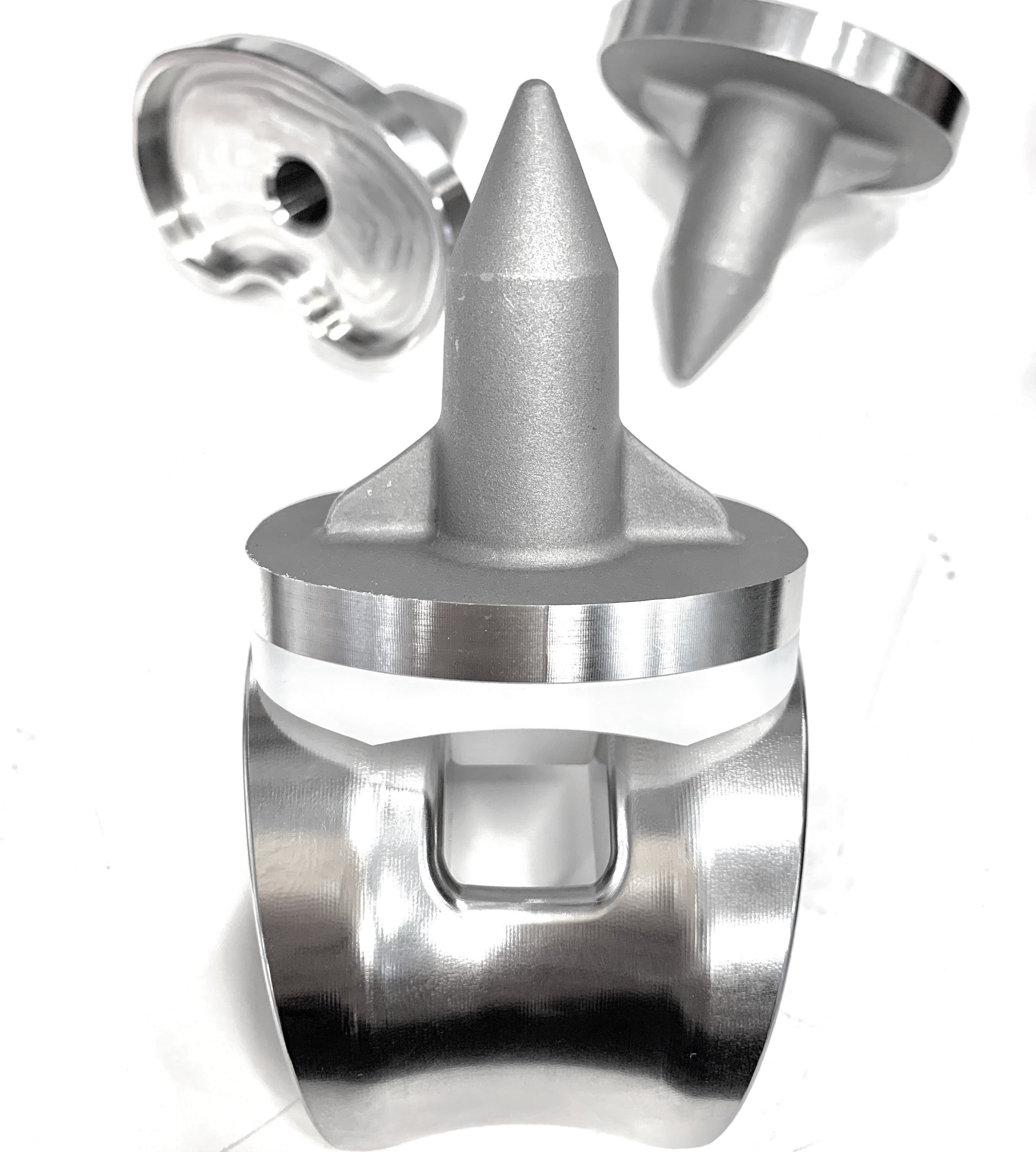

Top: Thanks to new engineering services, Mikron Tool became a holistic partner to its customers. Above: A tibia and femur component of a knee prosthesis made from a cobalt-chromium alloy requiring high cutting forces. Photos: Mikron Tool

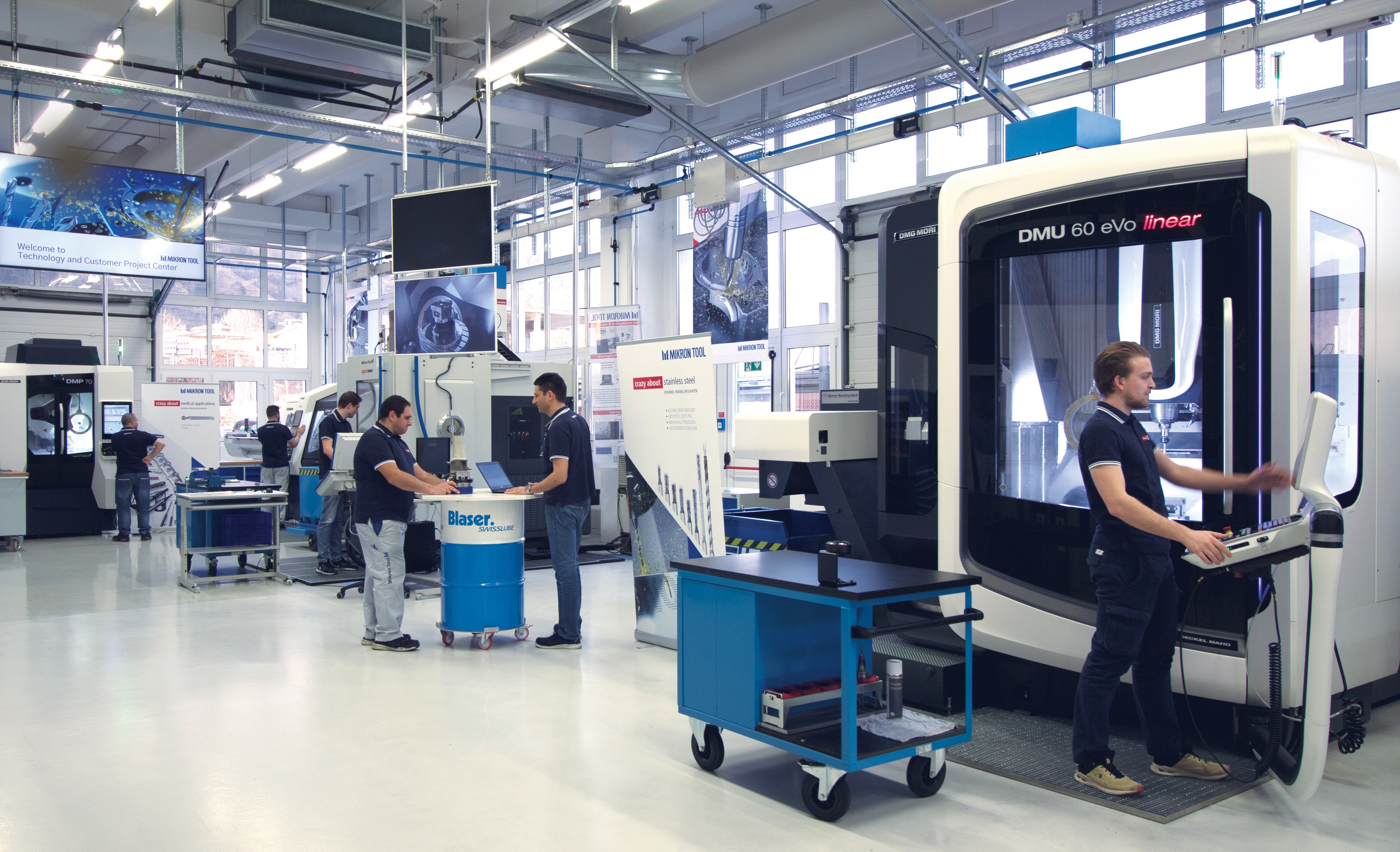

The Mikron Tool Technology Center in Agno is equipped with 5-axis machining centers, vertical high-speed machining centers, 8-axis automatic lathes and a recently arrived compact 6-side turn & mill complete machining station.

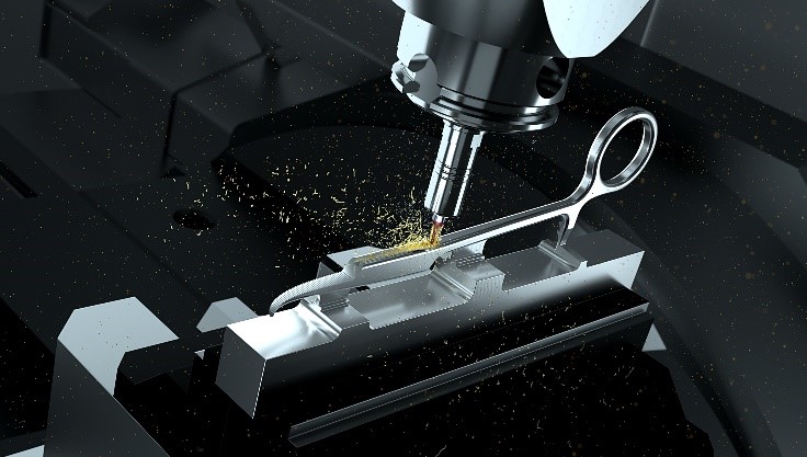

This hemostat made of martensitic stainless steel (17-4 PH) was machined from the solid in one setup with a time saving of 40%.
All parties must be taken into account
To get the best out of the production for this medical instrument, the entire setting must be taken into account: tools, machine, cooling lubricants, tool holders, workpiece clamping and CAD/CAM programming. And Mikron Tool has this competence.
Because the desired results can only be achieved through coordinated interaction with all participants. And that is remarkable: the machining time was reduced by 46% by the machining specialists (from 65 to 35 minutes) and the required surface quality of Ra 0.4 µm (15.75 µin) was significantly optimized by achieving 0.2 µm (7.87 µin).
