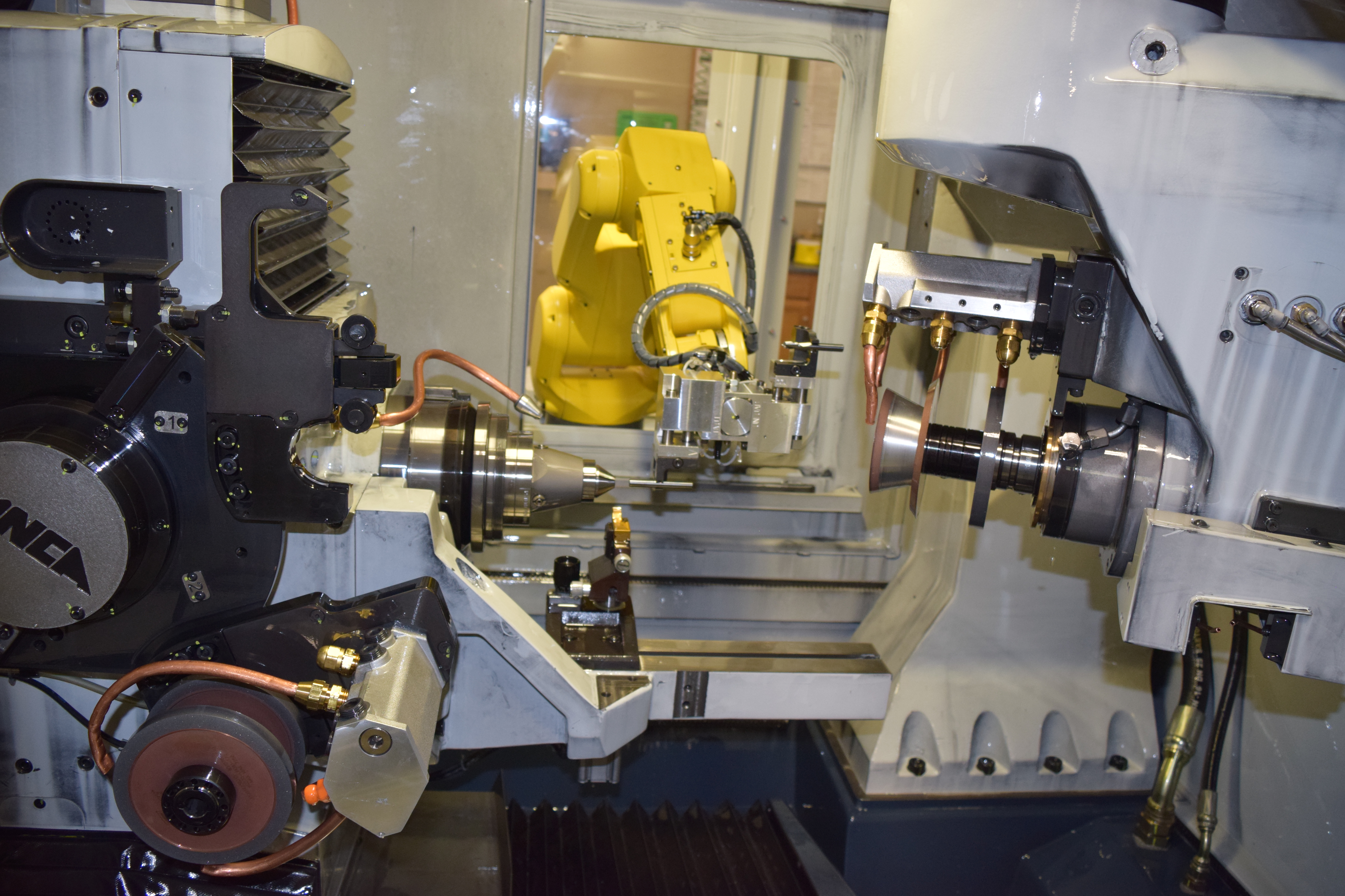

"On a recent visit, we saw that Jet operates robot-loaded MX7 (51-hp peak spindle power) and MX5 (35-hp peak spindle power) Linear CNC tool grinders, where ANCA Motion’s patented cylindrical linear motors are used for X- and Y-axis motion. A six-station wheelpack on the larger MX7 permits highly flexible production during the runs at Jet. Each of the MX Linear machines also are equipped with an internal FANUC robot loader and two pallets, supporting long, unattended operation. The MX7 is suitalbe for high-volume production for tools up to 25 mm (1'') in diameter, and the MX5 handles tools up to 16 mm (5/8'') in diameter.
“These machines allow us to fully automate the toolmaking process and also to move from small-volume specials—which we still do—to larger-volume production,” Sanzone added.
“The MX Linear machines also hold size better and allow us to do finer moves when grinding of smaller tools. This ability works well with the automation we have on each of the MX machines. We were then able to improve the quality of the grinding wheels we use—they may be more costly but they hold tolerance very well. This, in turn, works also very well with the ANCA LaserPlus in-machine tool measuring system."

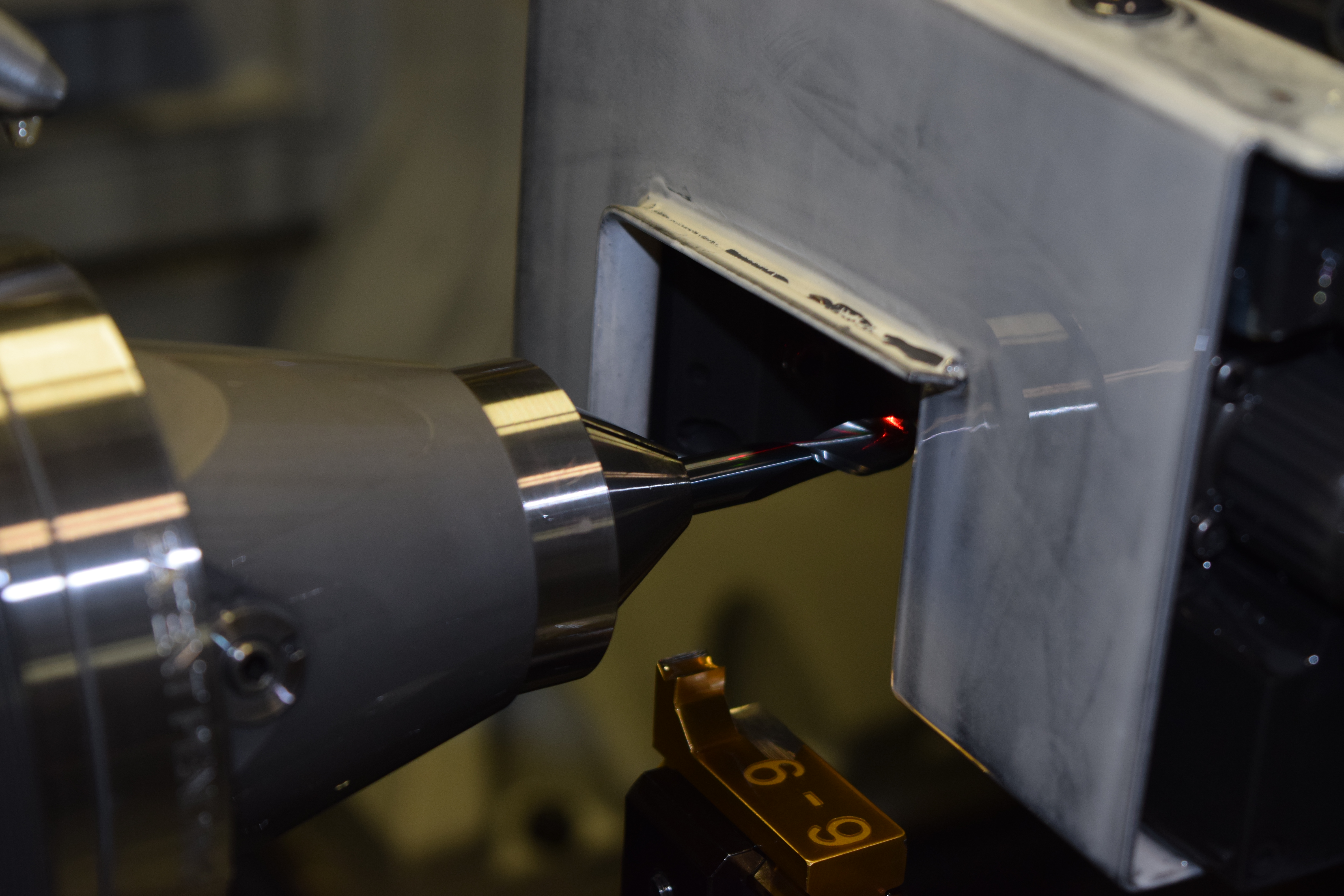

ANCA’s LaserPlus tool measuring system provides repeatable measurement and automatic machine compensation. It helps Jet hold tight tolerances and maintain grinding process stability. The LaserPlus system can measure and maintain an accuracy to ± 0.002mm (0.0001”) over a large batch of tools, measuring the top and bottom of the tool and checking tool runout. The maximum diameter the LaserPlus can accept for top and bottom measurement is 20mm (3/4”).
LaserPlus, is actually an enhancement to the touch probe on ANCA’s MX and TX grinding machines, using a noncontact laser beam to accurately measure tool characteristics in seconds, including microtools too small for touch probe measurement. The LaserPlus system can measure OD, ballnose, corner radius and profile tools.
The laser is mounted inside the machine and does not interfere with the grinding processes while automatically measuring tools in the machine collet. LaserPlus can also reduce the need for off-line external measurement equipment, saving cost, although at Jet, Sanzone has placed optical comparators next to each grinder for further, detailed tool inspection when necessary.
The laser measurement process is fully automated, including compensation for any out of tolerance conditions, supporting unmanned machine operation at Jet. And this is one of the main benefits to the company of the LaserPlus added to the linear drives and highly stable foundation of the ANCAs. The Linear machines can reliably operate unattended overnight, producing tools without delay, meeting customer demands for high-quality tools.
