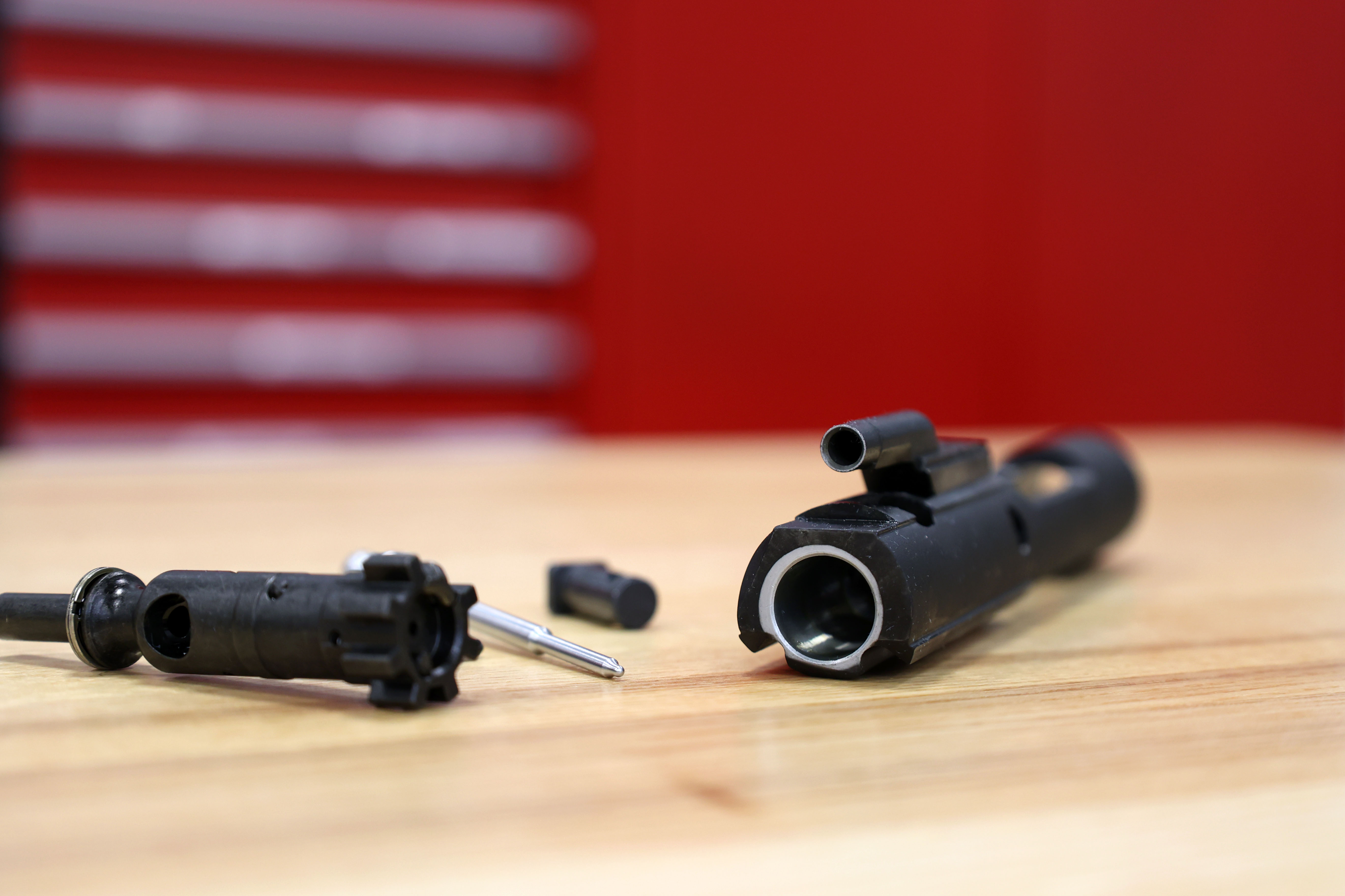

Holemaking and hole finishing are part of the machining process for numerous firearm components. One example of this would be revolver cylinders, which in some cases require a three-step process: pre drill, pre ream and finish ream. Form is critical throughout these applications because it must match the bullet casing. Other firearm components that need holemaking and hole finishing applications include AR upper receivers, gas blocks and bolt carriers, which house the firing pin and bolt itself.

Surface finish is one of the most important elements when machining firearm components such as bolt carriers, upper and lower receivers, and silencers. More specifically, surface finish is key for firearm chambers because of the need to accept the incoming cartridge, which determines the accuracy of the rifle and the load being fired on target. When drilling or reaming, surface finish is critical—the smoother the surface finish the less friction and less wear. Clearly, there needs to be a smooth and consistent finish free of burrs; otherwise, this becomes a fracture point. Ultimately, surface finish impacts the functionality of the machined firearm while negatively impacting the life of the barrel as well.
At the same time, there needs to be consistent wear coming from the finishing tools and on the finished part itself so that there is no excessive friction or wear. Here, CNC operations provide the most accuracy and consistency while creating a process that can be easily replicated. Not only do manual processes produce an inconsistent surface finish, but they also are more costly to production and the well-being of the operator—both of which impact product quality. Therefore, CNC machining improves the performance and life of the firearms because of the ability to remove microscopic peaks and valleys in the material.
