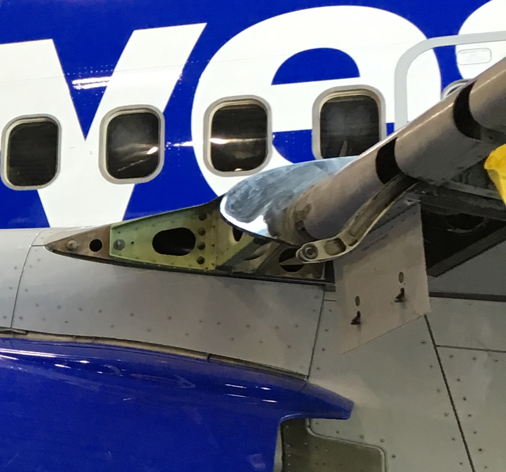

The aircraft wing shows the bird-damaged region close to the fuselage.
In this case, the airline, a low-cost domestic carrier, had suffered damage to one of its 737’s wing ribs, requiring the aircraft to be grounded until repairs were made. Wing ribs are an essential part of a plane's wing assembly. Attached to the spar, the main spanwise beam of an airplane wing, ribs form the “skeleton” of a wing’s structure, giving it its airfoil shape, helping distribute aerodynamic forces over a larger surface area, and making lift possible.

NVision technicians traveled to the airline’s facilities and scanned the damaged wing rib using the company’s HandHeld laser scanner, collecting all the necessary data on the rib’s exact geometry, including shape, size and contours.
The NVision Handheld scanner is a portable scanning device that is capable of capturing 3D geometry from objects of almost any size or shape. The scanner is attached to a mechanical arm that moves about the object, freeing the user to capture data rapidly with a high degree of resolution and accuracy. As a part is inspected, the scanner generates a point cloud consisting of millions points each with X, Y and Z coordinates and I, J and K vectors. Integrated software that comes with the scanner is used to convert the point cloud to an STL polygon and an optional tripod provides complete portability in the field. Intuitive software allows real-time rendering, full model editing, polygon reduction, and data output to all standard 3D packages.

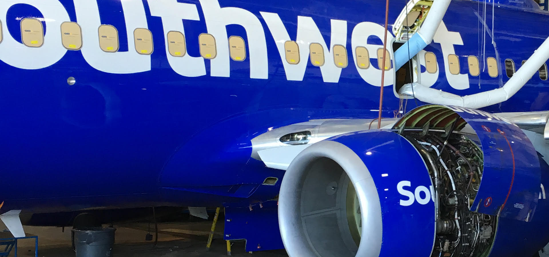

The aircraft undergoes maintenance and inspection.
After converting the rib’s point cloud to an STL file, NVision technicians imported the file into  specialized modeling software, where CAD engineers processed the data to an IGES/STEP model. Design engineers then created an insert to strengthen the rib and electronically transferred the manufacturable CAD model to the airline, where it was rapidly machined and installed, enabling the damaged plane to fly again just 48 hours after the strike.
