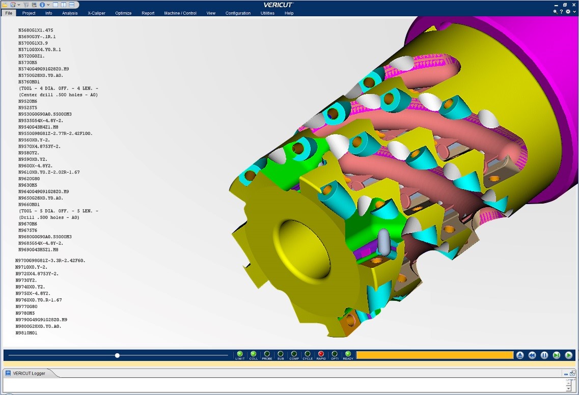

Whatever the case, he and Ingersoll are available to help machine shops of all sizes, and one of the tools they use to provide this no-cost assistance is VERICUT toolpath simulation software from Irvine, California-based CGTech. “In most cases, a customer sends me their VERICUT file and hopefully the NC program together with a tool list,” he says. “I’ll look at the existing metal-removal rate, the cycle time, and make recommendations on how they can improve the process.”
Quite often, Gampetro will need to reprogram the job from scratch. He’ll then run a comparison between his revised cycle time against the legacy program, using VERICUT to validate that his recommendations are solid. When done, he’ll send the customer a revised tooling list along with some screenshots of the process, and if the customer has VERICUT—which most do, Gampetro says—he’ll include that file in the package as well.

“We have extensive capabilities here and machine a wide range of complex geometries, everything from indexable turning and milling tools to special purpose cutters for automotive transfer lines,” he says. “Every single job is run through VERICUT before being released to the shop floor, to verify there won’t be a crash and that we have the best cycle time possible.”

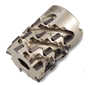

Ingersoll also designs and manufactures custom cutting tools—lots of them—which Gampetro has recommended on more than one occasion. In one recent example, he couldn’t understand why one of his customers was using a ball-nosed endmill to surface the bottom of a deep slot. After speaking to the programmer there, Gampetro learned there wasn’t a standard slotting cutter available that could do the job, so the customer made do with what was on hand.
“All they needed was another half inch of reach, so we designed a special tool,” he says. “It made a huge difference on the cycle time, not to mention much better tool life.”

“They said plunge milling is old school, and even after I showed them the simulation—which reduced the cycle time by 40 minutes—they insisted that trochoidal toolpaths are more efficient,” he says. “So we ordered a block of 15-5PH stainless, set it up at our Tech Center, and invited them to watch. Fortunately, most of our customers don’t need that level of proof, and become believers after seeing the VERICUT simulation.”
